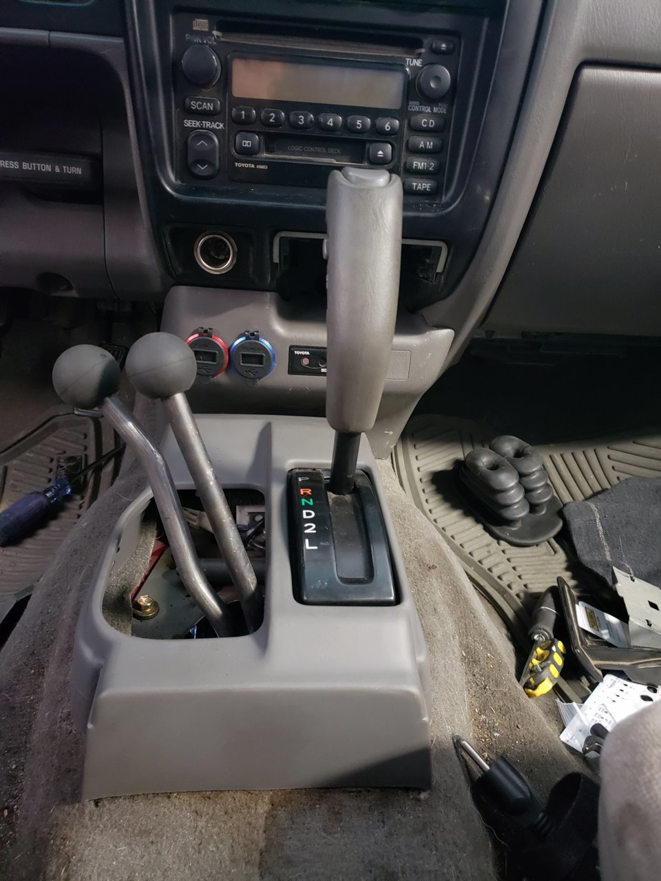

    It's firmly in 4 neutral and 2 hi

    I think it's the stress on everything. Mine does it when going from drive to park in low range. Jeeps do it to. If you put it in neutral then park it releases the stress on mine and doesnt grind

    So it's only grinding in park? Nothing else?

    It's only grinding when going back in to park. When you start to put it in park, it sounds almost like grinding gears in a manual.
    I was going through gears to fill the trans, but when I would go from reverse to park, it would give me the grinding noise. If I backed the selector back to reverse, the sound would go away.

    with 4 neutral and 2 hi it may be the trans still spinning (i dont know how the twin sticks work.). your rear driveshafts connected right?

    Hm usually when grinding is happening it's a tcase gear not lined up. You sure your linkage was connected good?

    Re reading your original post makes me ask do you have each stick in a gear and not the middle spot? So one stick in either 2wd or 4wd (should only be 2 shift spots so wouldnt be this shifter) and the other stick all the way foward or all the way back shifting it from high to low? Should never be in the middle "neutral" spot. Nothing is engaged and in gear will spin and cause the gears to grind in the transfer case.

    Ok... Disregard... I was doin it wrong. Gonna have to learn the art of the twin stick. All is good.
