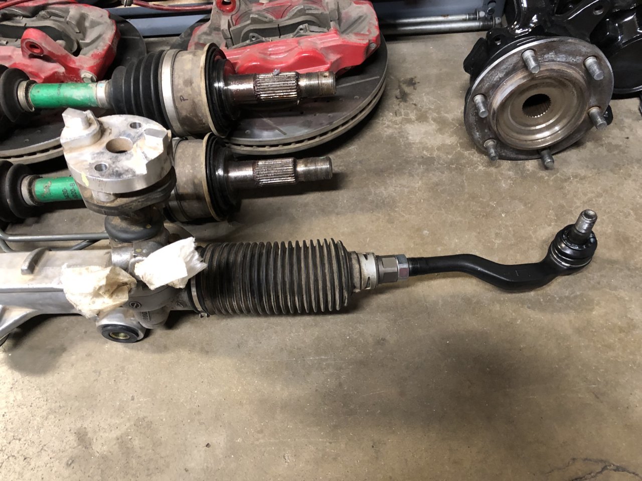

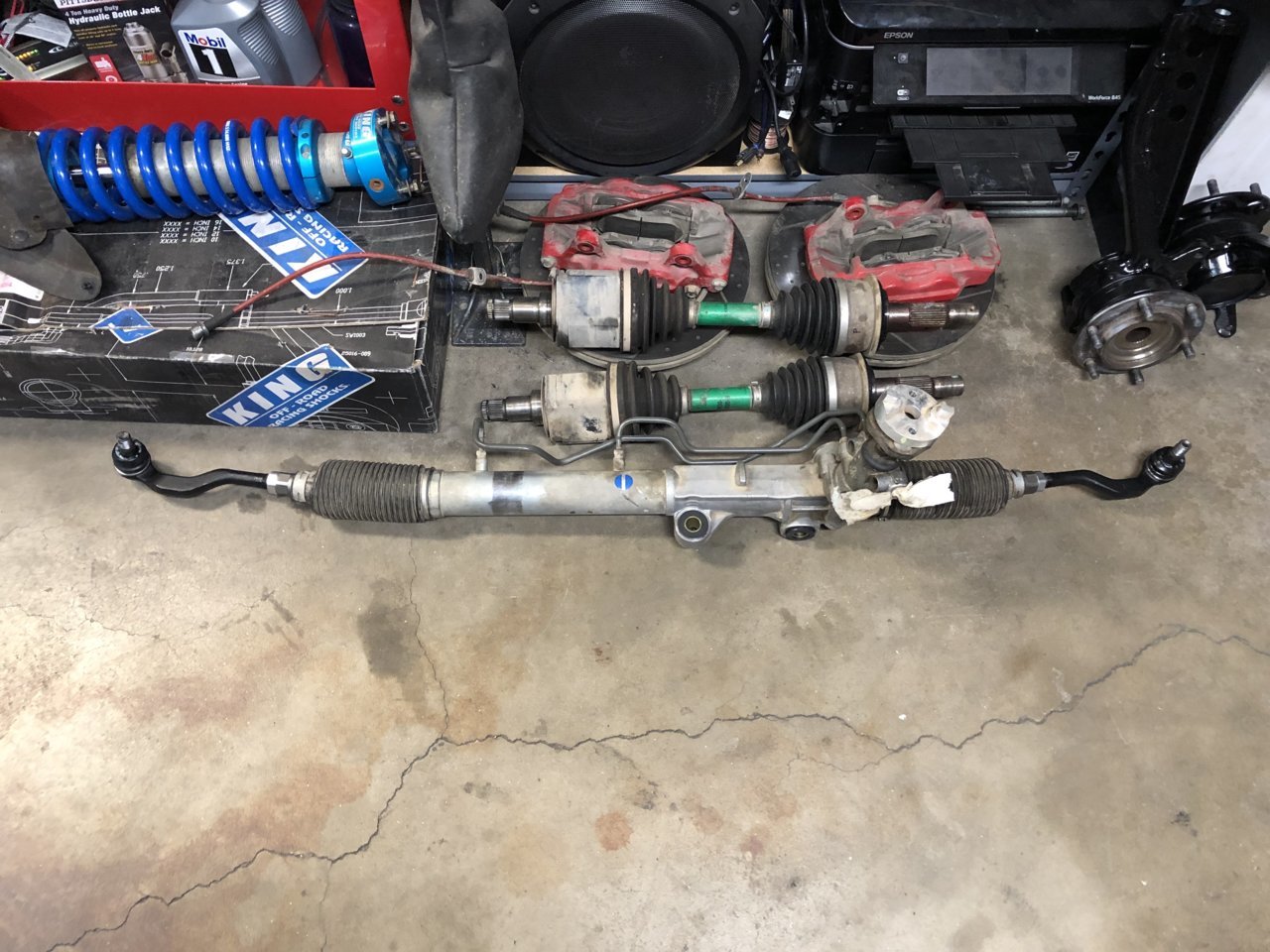

    what brand are those? I need to order OEM LBJs. Got me some new LCA's and whiteline bushings. Shes gonna be tight as a virgin up front :)
    Also gonna do new OTRE's. I went with Oreillys. Life time warranty. they swap them out no questions asked. Every 6 months I replace them

    I've used Moog for inners and they hold up fine to the abuse I put my truck though. I'm killing oem lbjs in less than a years time to tell you how hard my truck is abused.
    I did buy a reman rack at one point that came with inners that would bind at full droop. They lasted one offroad trip. Moog have enough articulation in them, not sure about with extended travel coilovers though.
    I'm back to a new oem rack so I'm on oem inners but the moogs are my trail spares.

    @Dan8906 This wouldn't be a bad option if you had the time for this I'd think.
    I plan to use moogs are trail spares for everything except LBJs

    Im thinking im going to run Moogs inner and outter.

    I did 555 inner and outer. The 555 inners will articulate to the extent that extended coilovers require.

    I just replaced my inners with 555 units from LROR as well as OEM outers, based on feedback from other owners. There’s no way in hell I’m paying for OEM inners until I need a new rack. By the way, I HIGHLY recommend buying a new set of OTRE jam nuts from LROR as well. They’re relatively cheap and if your OG ones were anything like mine they were rounded to shit anyway.
    I also plan on using my low mileage OG OEM inners and outers as trail spacers. Same for the LBJs that I just replaced with new OEM units.

    Yep. Same here @ 75k.
    After jumping to 315s out of the gate and then punishing my steering rack, I decided to refresh the whole front end with new parts as a baseline and keep the old ones as spares.
    But seriously, I almost missed those adjustment nuts and they were like $2 apiece. Added them to my order for the inners and it worked out brilliantly :cool:
