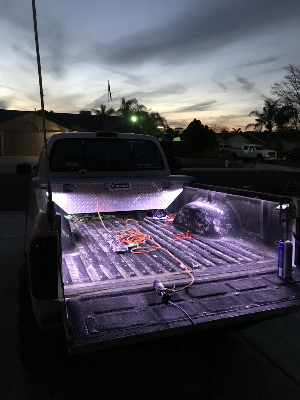

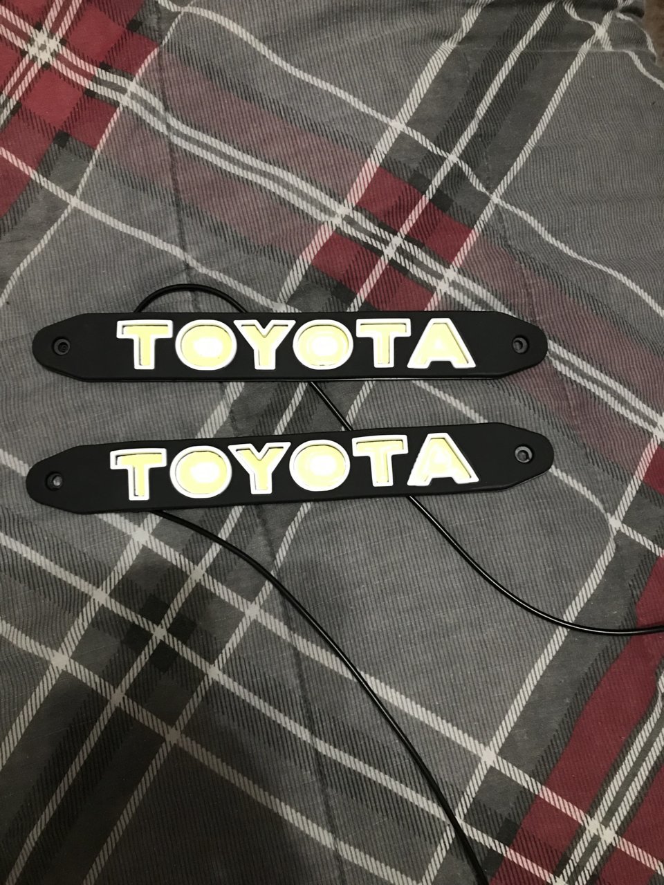

    I love how you installed those crazy Toyota logo rock lights before you installed bed lights. Haha.

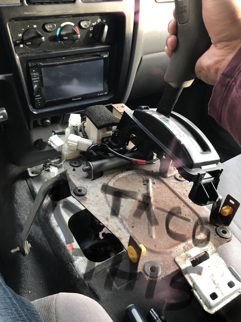

    Replace shifter bushings on my Prerunner, there are 4 bushings but I thought i can only get to the front 2. I did the 2 only ‍♂️. It did make a difference no more play and the key can’t get stuck anymore when i turn it off. I also adjusted the bolt that connect the linkage together on the tranny lever. Others write ups say to mark it, i did, and i found it better to snug the linkage where there is no play on the park position. So don’t buy tranny mount right away thinking it has a play, ir worn out, it could be just your linkage and bushing issues.
