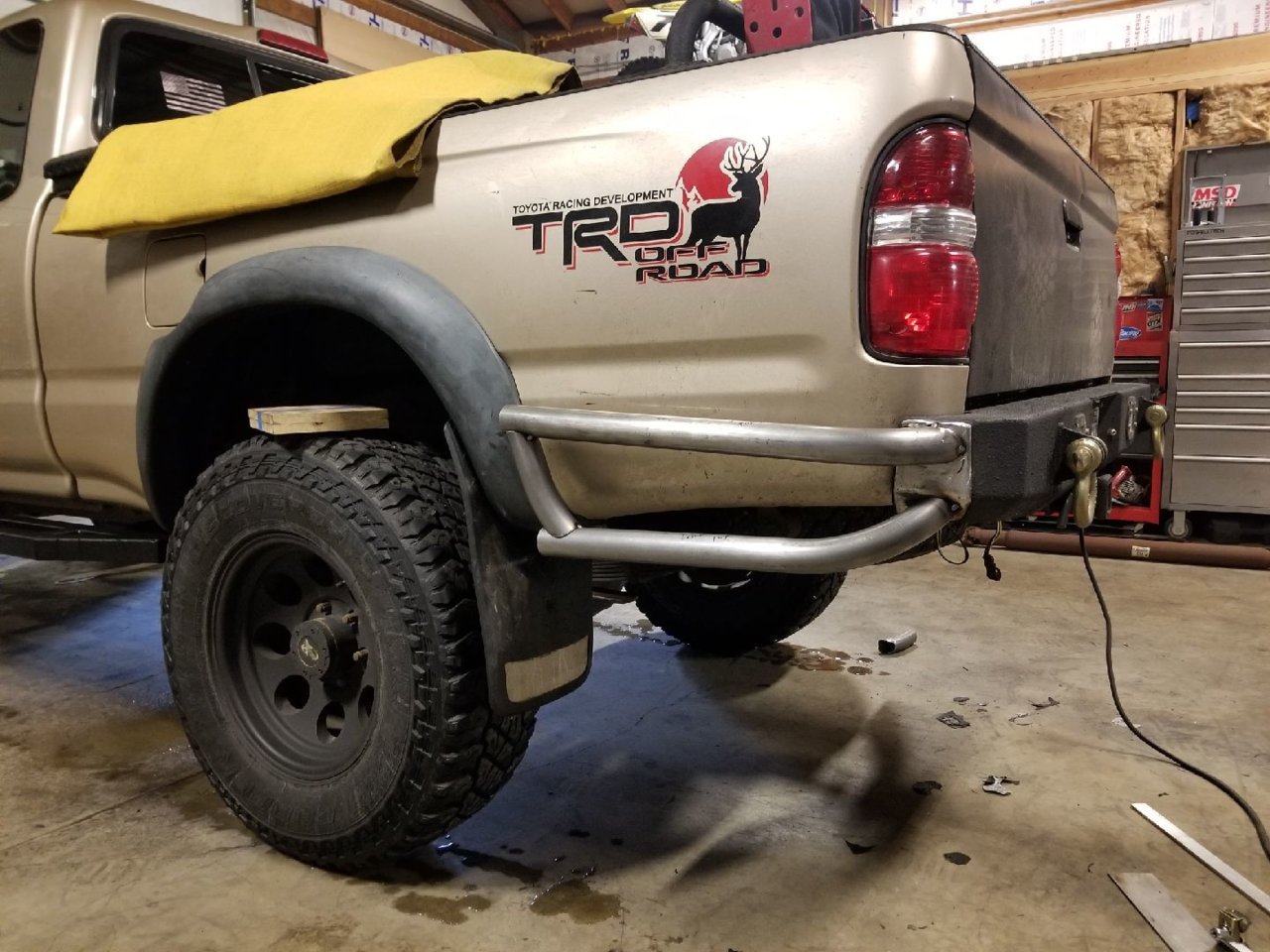

    Made some progress, made some mistakes but not the end of the world. Have to do some clearancing on the frame horns to be able to completely slip the bumper back on but fortunately it's mostly on the 1/4" plates that I added previously. I also forgot about the shrinking effect when the metal cools after welding which made putting the winch plate in place kind of a bitch and why it looks bowed in the center. It's not welded in yet but I'll be on that tomorrow. Really need to get the gas setup so there is less cleanup to do.
