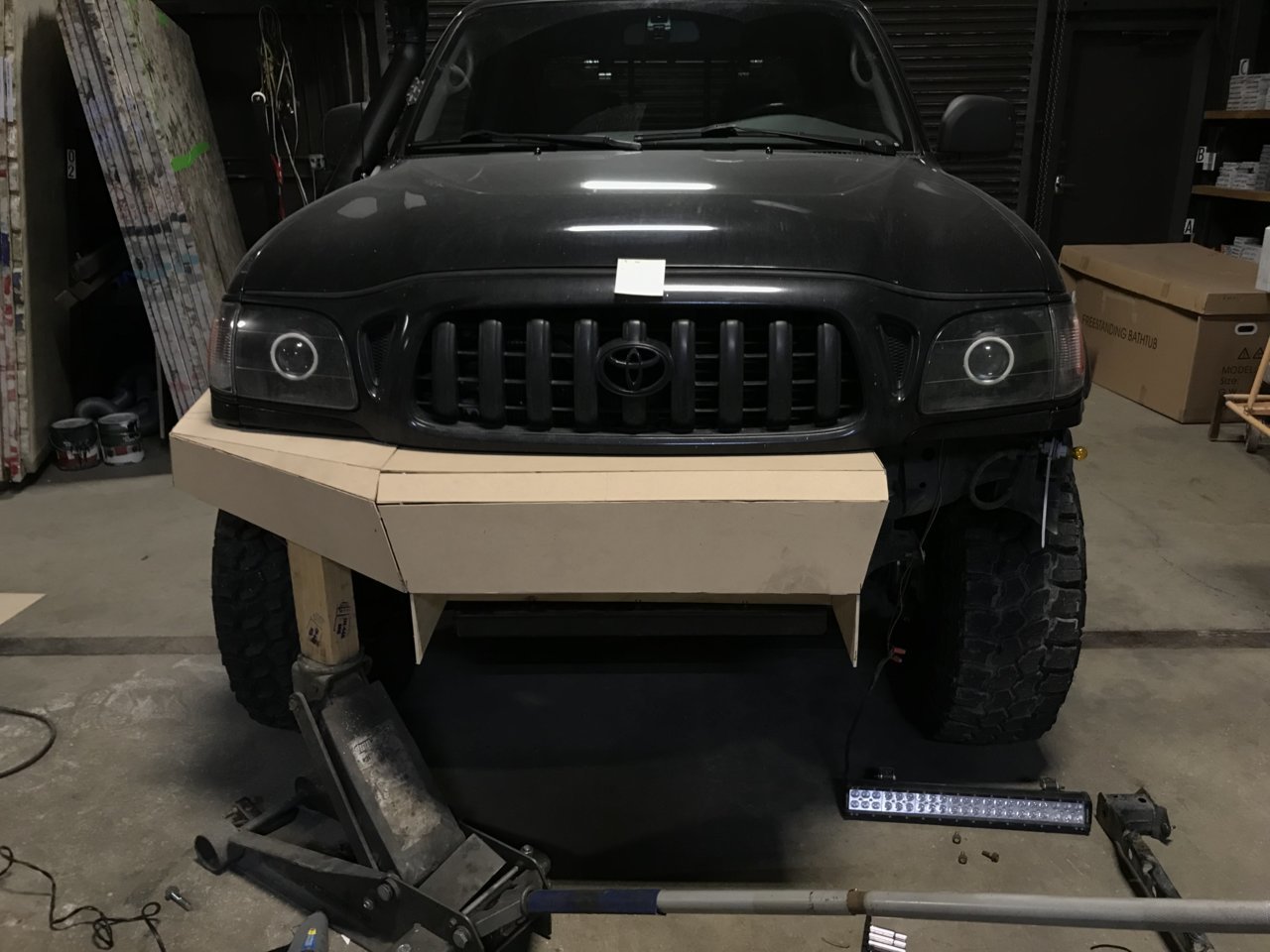

    Burned the front hoop in after some humming and hawing to determine the angle and setback. Not ready to do the side hoops since I still need to figure out the best way to fishmouth the ends that meet the main hoop.

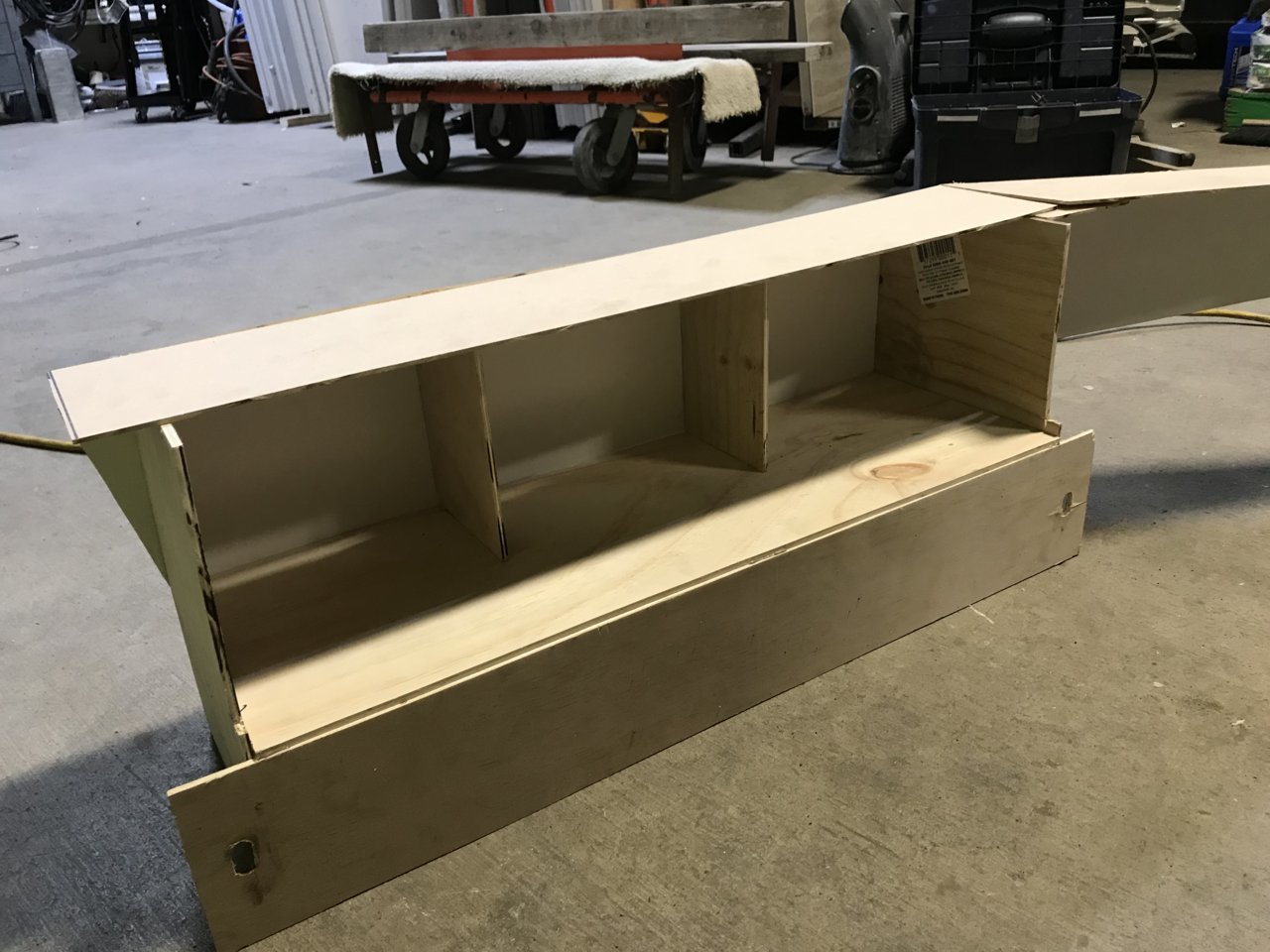

    And a view of the inner structure. The wings will be strengthened by the outer hoops once they are installed. If I wasn't added hoops, then I would probably add some internal bracing for the wings.
    The 1" x 2" tube for the center bracing at the bottom is what I used since the pieces provided were too short because of the additional 1/4" plate on my frame. That's also why I have a larger bumper to grill/fender gap than this bumper would normally have. I made the mistake of not addressing that before tacking and welding the top pieces in place. I might be able to add some material later to address that but not a big enough deal for right now.

    I'd skip the head light hoops. Wish I had. I like the center hope with side posts better. That and it's much easier to get under the hood without the head light hoops. Chances are if you hit a deer on the highway anyways the tube will just fold over into the truck .

    It's less Tacoma and more mod

    I agree with Monte, my headlight hoops broke off and cane into my headlight and hood. They're just huge levers to tweak the bumper
    xtremewlr[QUOTED] likes this.

    So is it better to just hit the deer with no hoops at all? Or just a center hoop? I still haven't decided on a bumper yet but probably will this summer for a winch.

    I think it's probably better to go without them and let the bumper have a better chance of survival. The wings don't have enough support to handle all that leverage.

    I prefer the look of the single center hoop from what I saw of other completed bumpers online but those headlight hoops would help a ton for the low branches we are always dragging our fenders against. Not much deer here to hit, and the ones we’ve seen are so small they wouldn’t damage your truck anyway, so I wouldn’t worry much about that factor.
    The point about being easier to get inder the hood, I X2. Although your truck is pretty much set for the next 200K miles after all the maintenance you’ve completed.
    Great looking work btw!
    xtremewlr likes this.

    Thanks for the feedback guys! I'm going to leave them off for now because I still haven't figured out a good way to fishmouth the end going to the main hoop. I like the idea of doing kickers off the main hoop, like @Speedytech7 has on his tube bumper. I have enough tube for those and then small posts coming up on the ends where the holes are for the headlight hoops. Might be interesting that way, I'll have to play with the looks.
    For those that are interested, the bumper weighs in at 96.5 lbs with just the main hoop. There is nothing supporting it other than the scale here.
    Got the backside primered. Need to run out for some more paint and then I'll get the backside painted and let it sit until tomorrow, flip it and prime and paint the front side.
