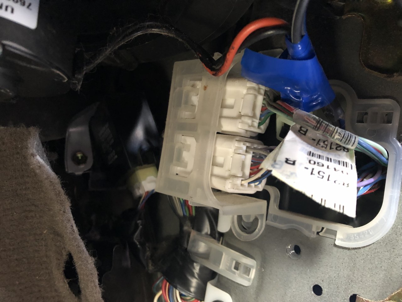

  11. Mar 5, 2019 at 12:55 PM
    wat0023
    wat0023 Well-Known Member
    Jul 22, 2016
    #192596
    611
    Kendra
    Tri-Cities, WA
    03 DC 4x4
  12. Mar 5, 2019 at 12:57 PM
    Blackdawg
    Blackdawg Dr. Frankenstein
    Dec 31, 2010
    #48500
    81,642
    Monte
    Wyoming/St. Louis
    The Trifecta of Taco's
    Think it should eb the black little relay held in with the one 10mm bolt and odd bracket on the left.
