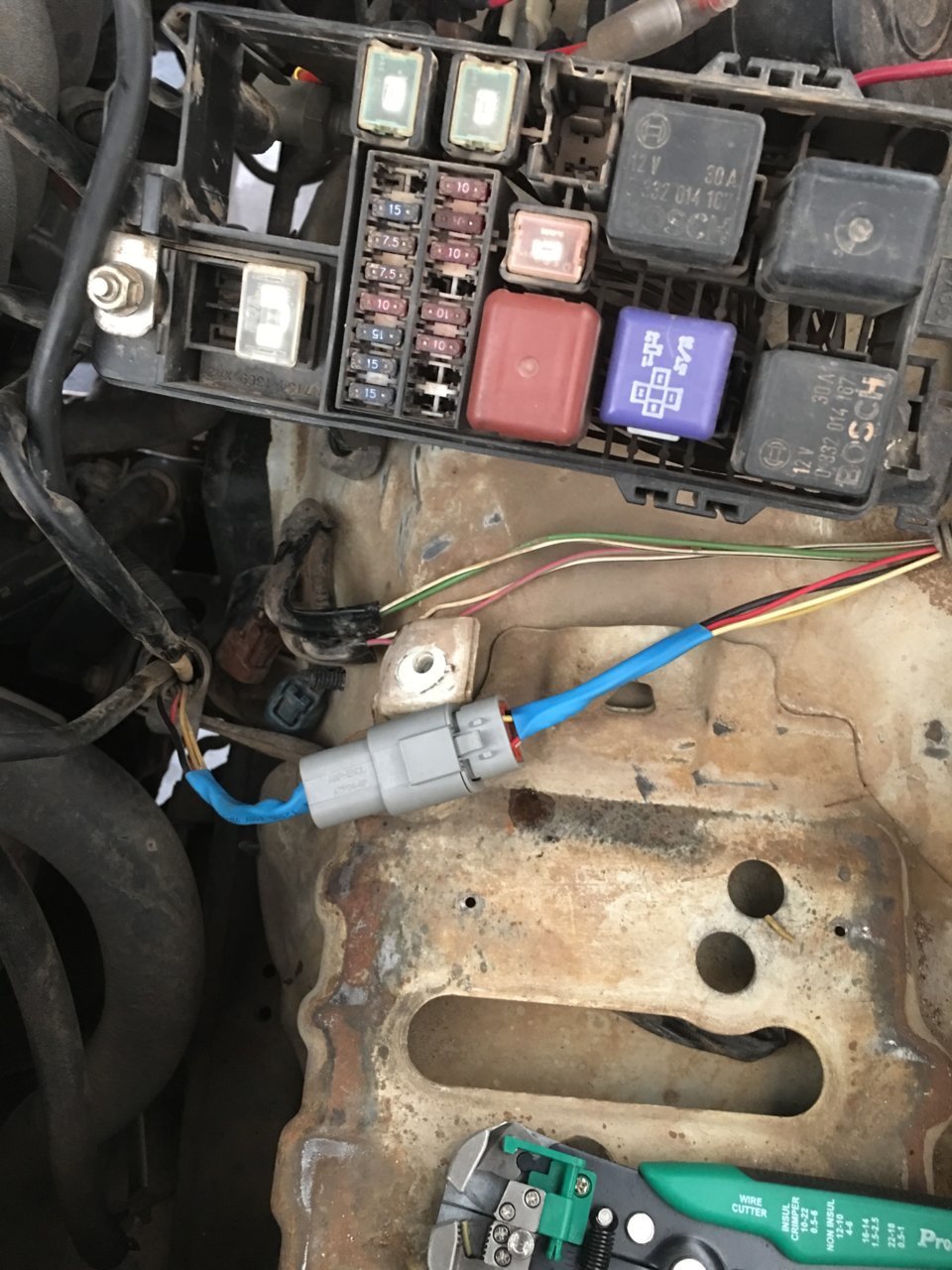

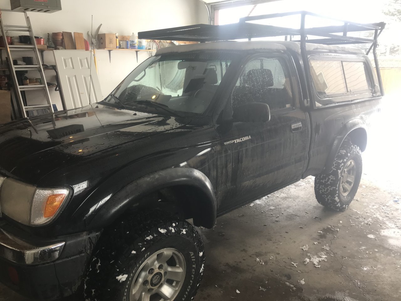

    Installed a sweet ladder rack and some gen 1.3 flares on my 98

    I hope you insulated each conductor with heat shrink first....

    What, they fit your model? sweet.

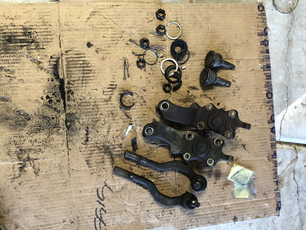

    Replaced upper and lower ball joints and outer tie rods. Had to dremel through one of the castle nuts because it was so stuck the socket rounded it.
    Surprisingly it took care of my front end shimmy, though I’m pulling a bit to the left when braking now.
    still going to do the UCA/LCA bushings to really shore it up. Probably do that in a weekend or two.
    Anyway, here’s a picture of the bone yard.

    I’m 99% sure my passenger side pull is worn LCA bushings. Hopefully it cures yours

    Pretty sure all flares fit all years, I have the bigger flares on my 99

    Fingers crossed. I need to figure out how to get those bushings out without a press or burning them.

    Use the bottle jack under your seat

    @Timmah! has a great video for this. I think you’re going to have to press and/or burn them out no matter what, but you should be able to do it with a vise, bottle jack, or ball joint press. I can’t remember if it’s whiteline or energy suspension that you need to save part of the old bushing for.
    https://m.youtube.com/watch?v=kmaZNBp1gZM

    Didn't know, I thought the 01-04 had different mounting points.

    The replacement plug has a rubber piece and a housing that separates the conductors. Would I still have to shrink wrap the conductors?

    Pops and i tried the bottle jack method...no go...hes gonna take them to work and use the press. Cant wait for new bushings

    A little bit of heat went a long way for me.
