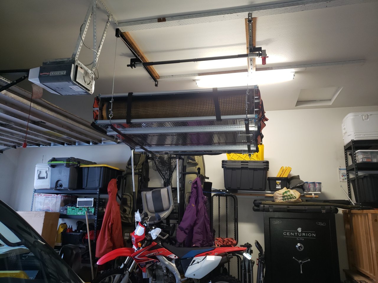

    Yesterday I got the hoist for the RTT installed...

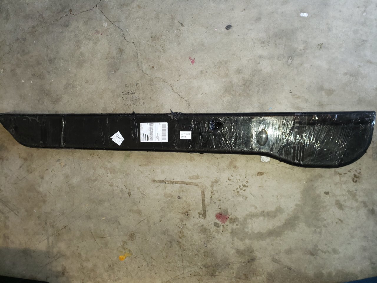

    And today the FedEx truck dropped off a slider shaped package from 4x Innovations...

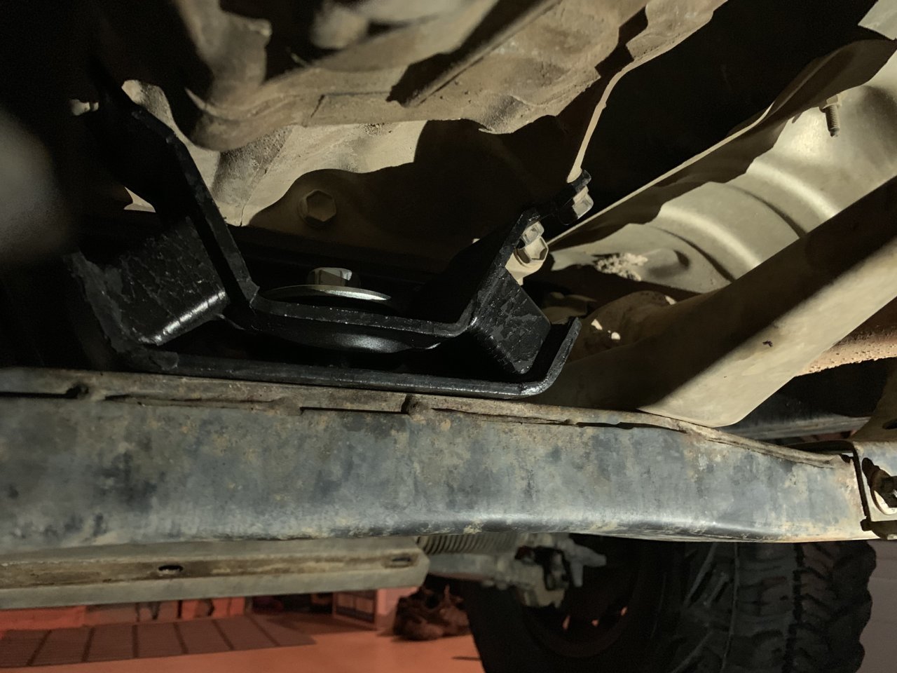

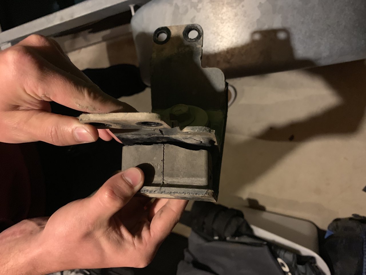

    5C586391-FD61-4898-A29D-25EAE40F5C34.jpg 83F8FB16-A8B5-4B23-9EFF-9C431DE98B00.jpg Replaced my transmission mount, old one was just a bit worn

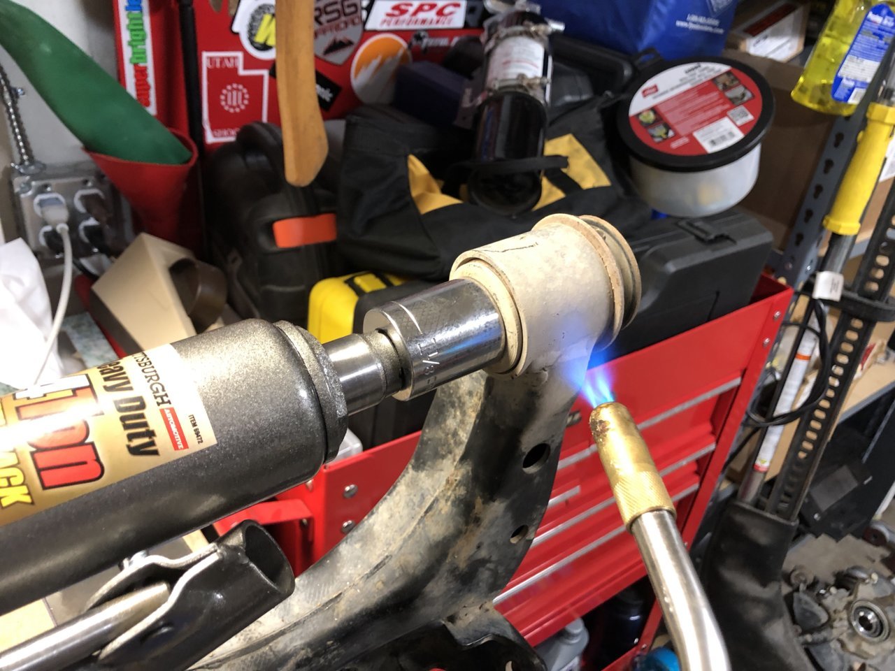

    Cam tab gussets are a dick pain (it's mostly the prep work and shitty welding angles), but they're worth it if you're stripping the front end down to replace LCA bushings anyway. But I get it if you don't have it in the budget.
    Like @Reh5108 mentioned, putting the LCA bushings under a little pressure with the bottle jack and then hitting the LCA around the bushing to expand it a bit made popping mine out a piece of cake. I used a cheap ass MAP torch.

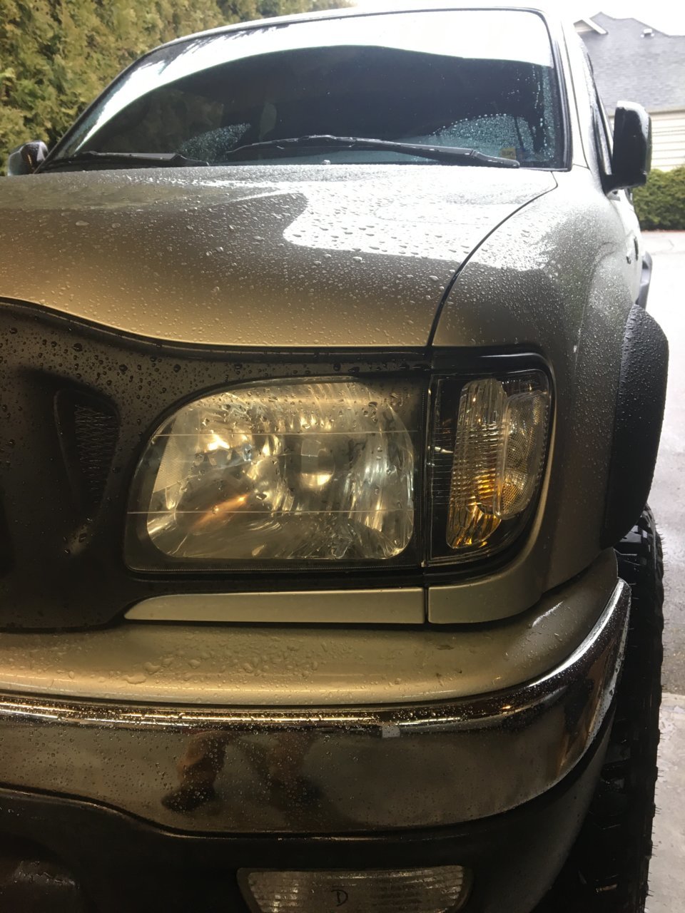

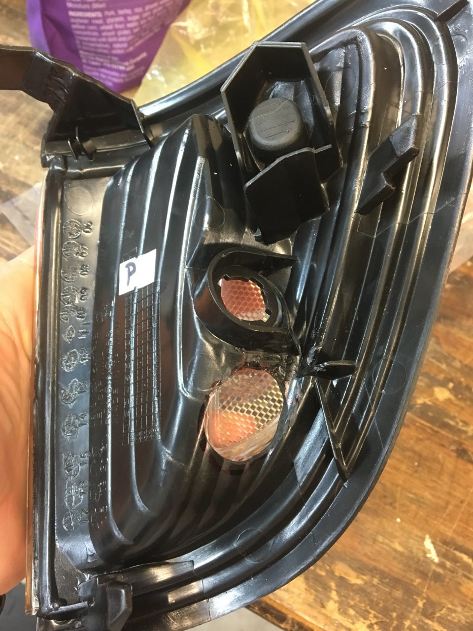

    Changing to depo corner lights so I moved the turn signal and had to cut into the corner lights
    But it turned out pretty well I’d say, oh and I painted the grill with rattle can bed liner

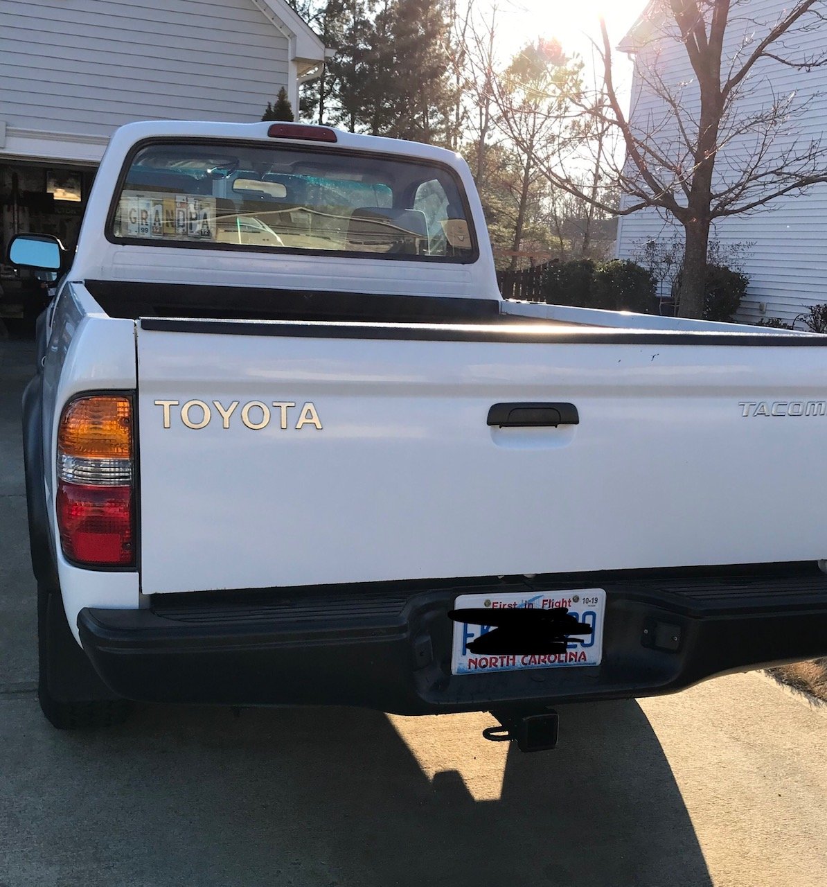

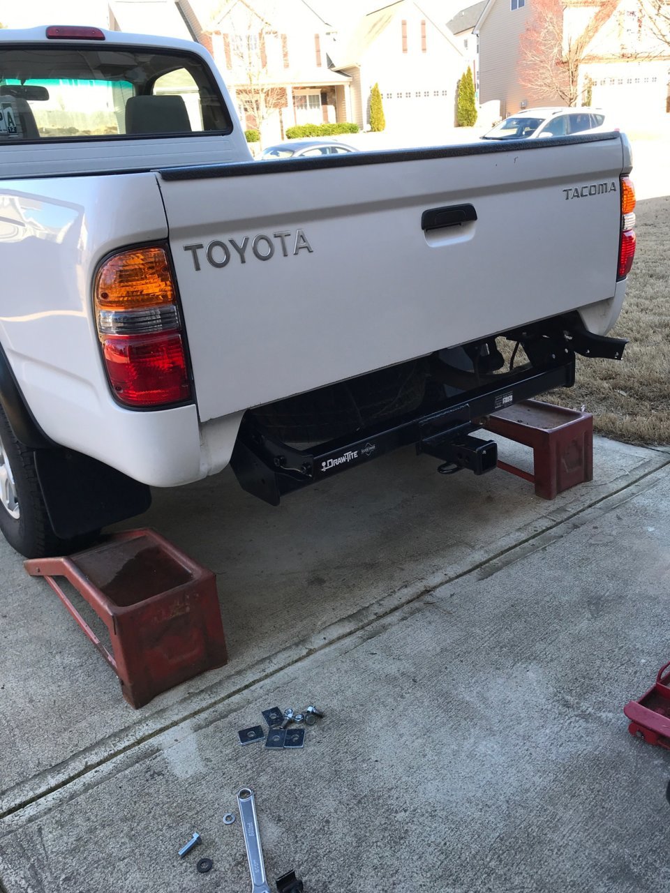

    Installed a trailer hitch on my '03.
