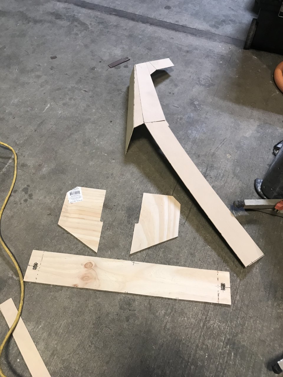

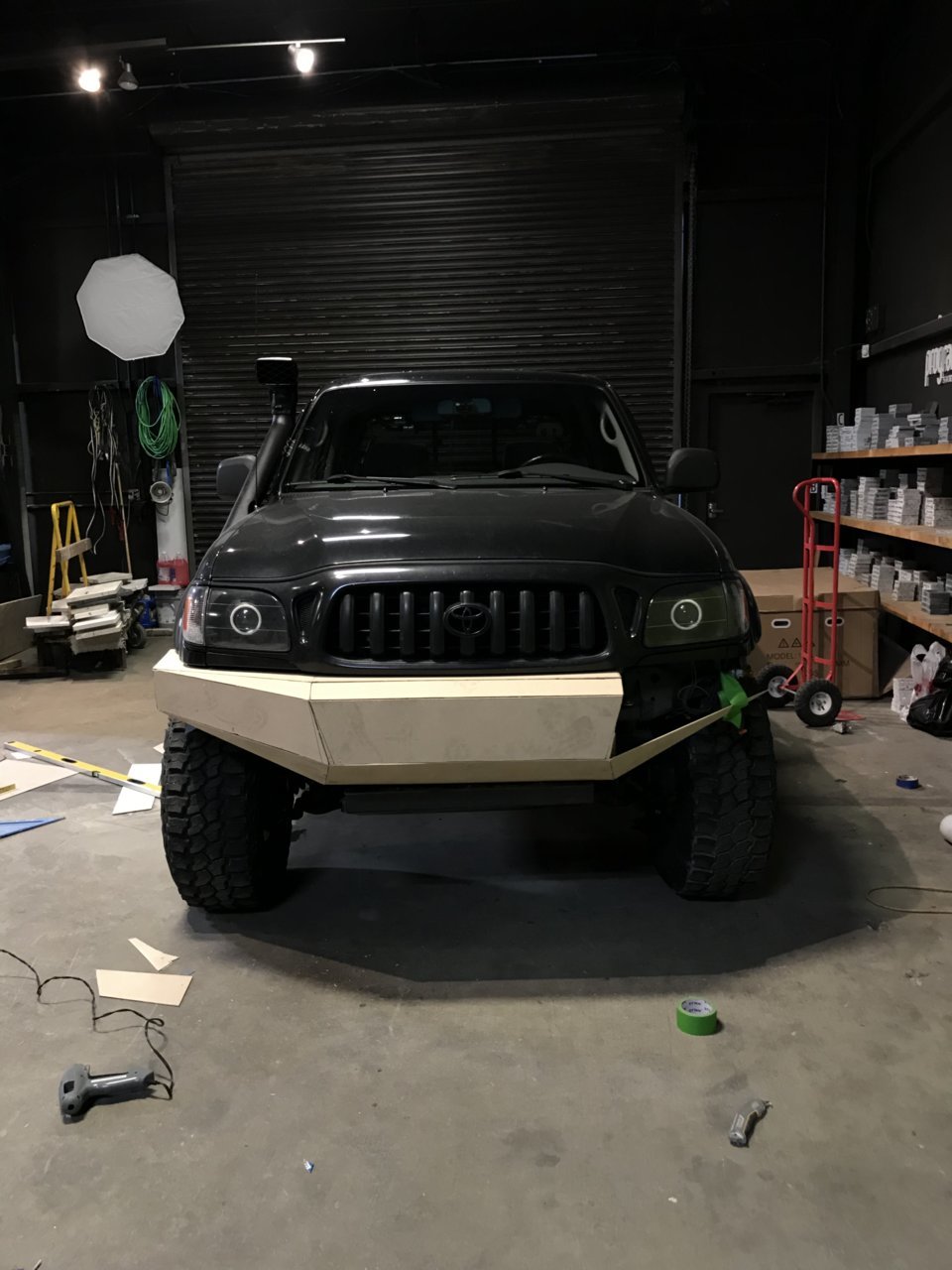

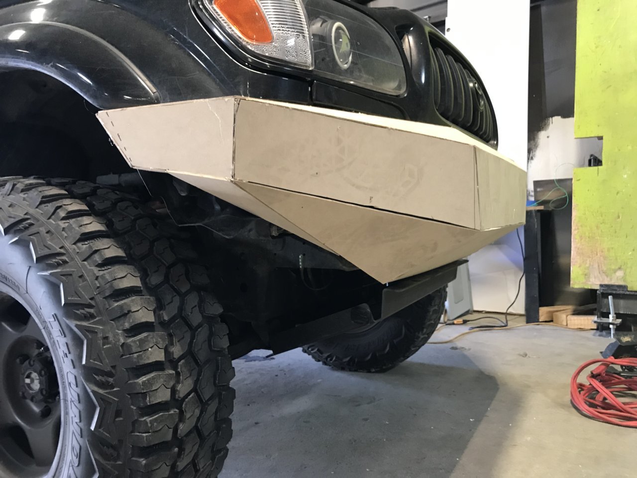

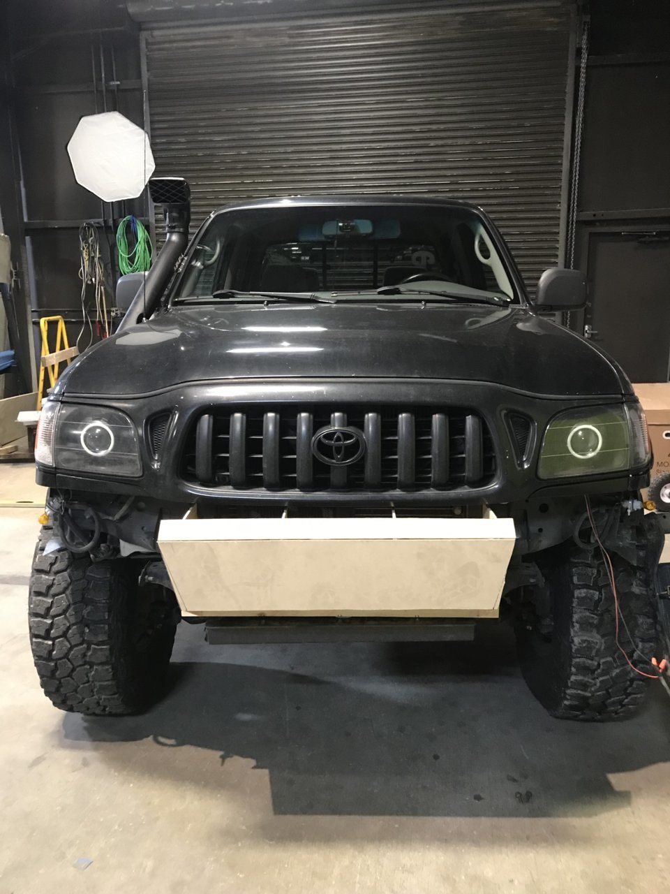

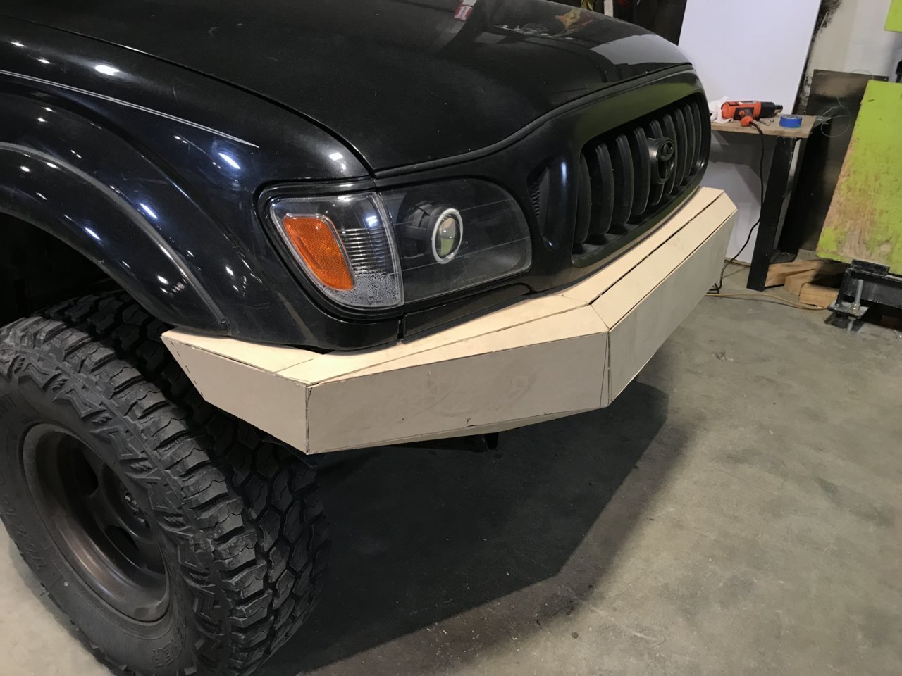

    Finished making the wood bumper template. (Yes I didn’t finish the other side because I didn’t want to wast time cutting the same angles and gluing it all together). Anyhow next will be to draw it up on a CAD program and start putting it all together. Here are some progress pictures.

    Looking a lot like a bumper that was popular at one time but went out like Pelfrey built. You should sell the CAD file so others can do the same.

    Once I build this one I may look more into that. Thanks

    Whats the point in making a cad file? Cnc plasma cutting all the pieces? Other than that I cant think of a good reason. Id just trace what you got onto some sheet metal then start torching/plasma cuttering the pieces out.

    Yes reason for cad file is in cutting them on a water jet.

    I’d much rather pay someone to CNC them for precise clean cuts. Cutting that all out manually would suck ass.

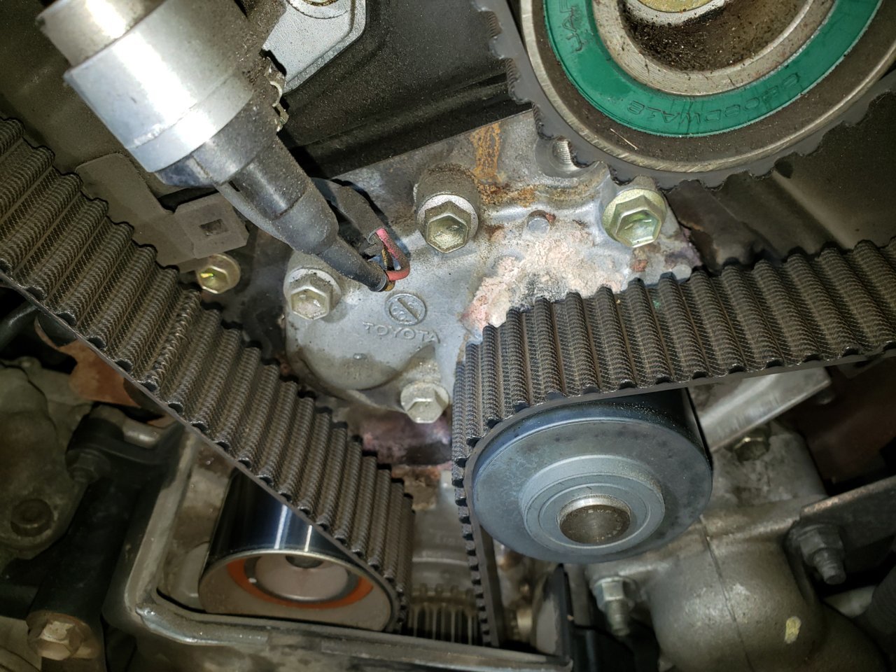

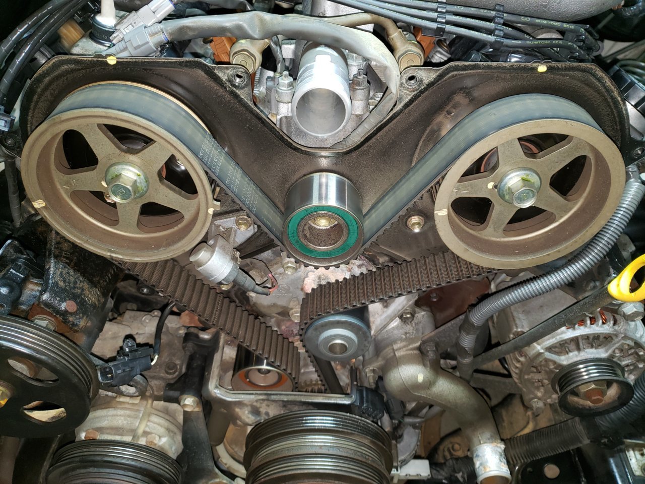

    Got the upper cover and fan bracket removed. Looks like the water pump was starting to weep a bit. Got to it just in time...
    Need to get a bigger breaker bar for the crank pulley bolt removal tomorrow.
