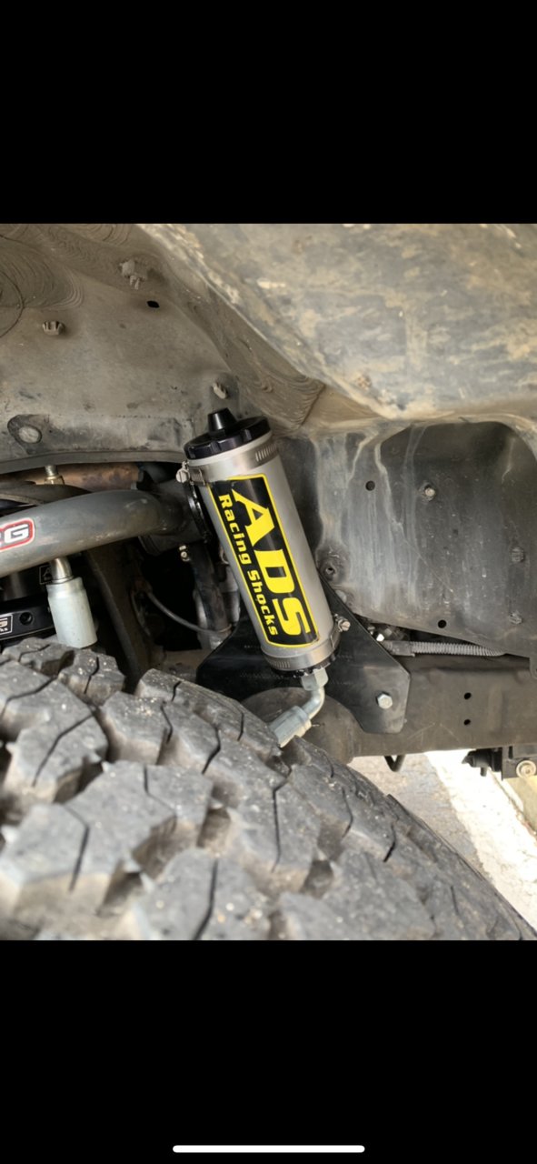

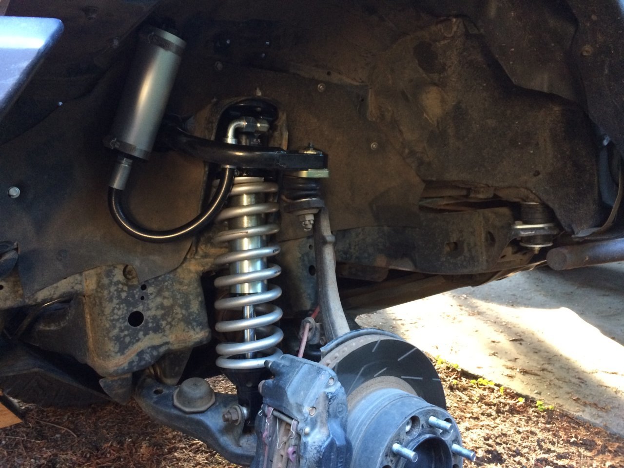

    Did you just use a sheet metal screw/bolt through the fender in that position? I need to move mine... I'd already avoided the UCA impact zone after your incident, luckily :D.
    Honestly, I'd like to get them slightly forward and down on the front cross member, behind the skid...but that'll have to wait for longer hoses.

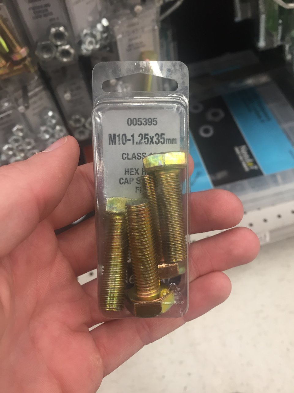

    I got one for my lbj at oreillys after I stripped one out. Grade 10.9, but they have a bigger head on them. I think it went up to a 17mm, just barely allowed me to get a socket on it.

    What length did you get?

    I think I grabbed a few different sizes. Cant remember which worked out the best.

    I’m thinking 30 or 35mm

    Same. My tires were rubbing the resis in the stock location. Even hit one and bent the bracket pretty bad.
