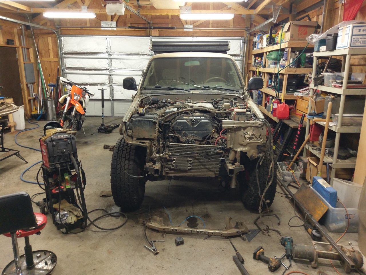

    don't take your first corner as hard as you normally would with that thing up there now. Makes a big difference. Why I lowered mine.

    With that motor sitting low it just gives you more room for a top mount intercooler :boink:

    pfff might as well do a blower if you wanna just heat soak an intercooler.

    We were joking about grafting a wrx scoop on mine. Never really understood why you'd put an air intercooler on top of the motor.

    well if you do a 4runner on it looks cool haha
    Simple, space requirements and ease and above all else..cost.
    does help a bit if you have it scooped like the subarus do and you keep moving. But not nearly as good as a FMIC.
