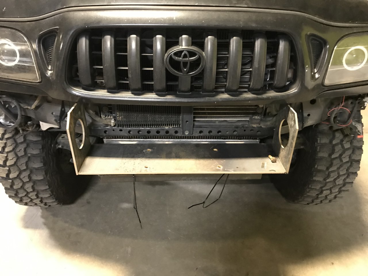

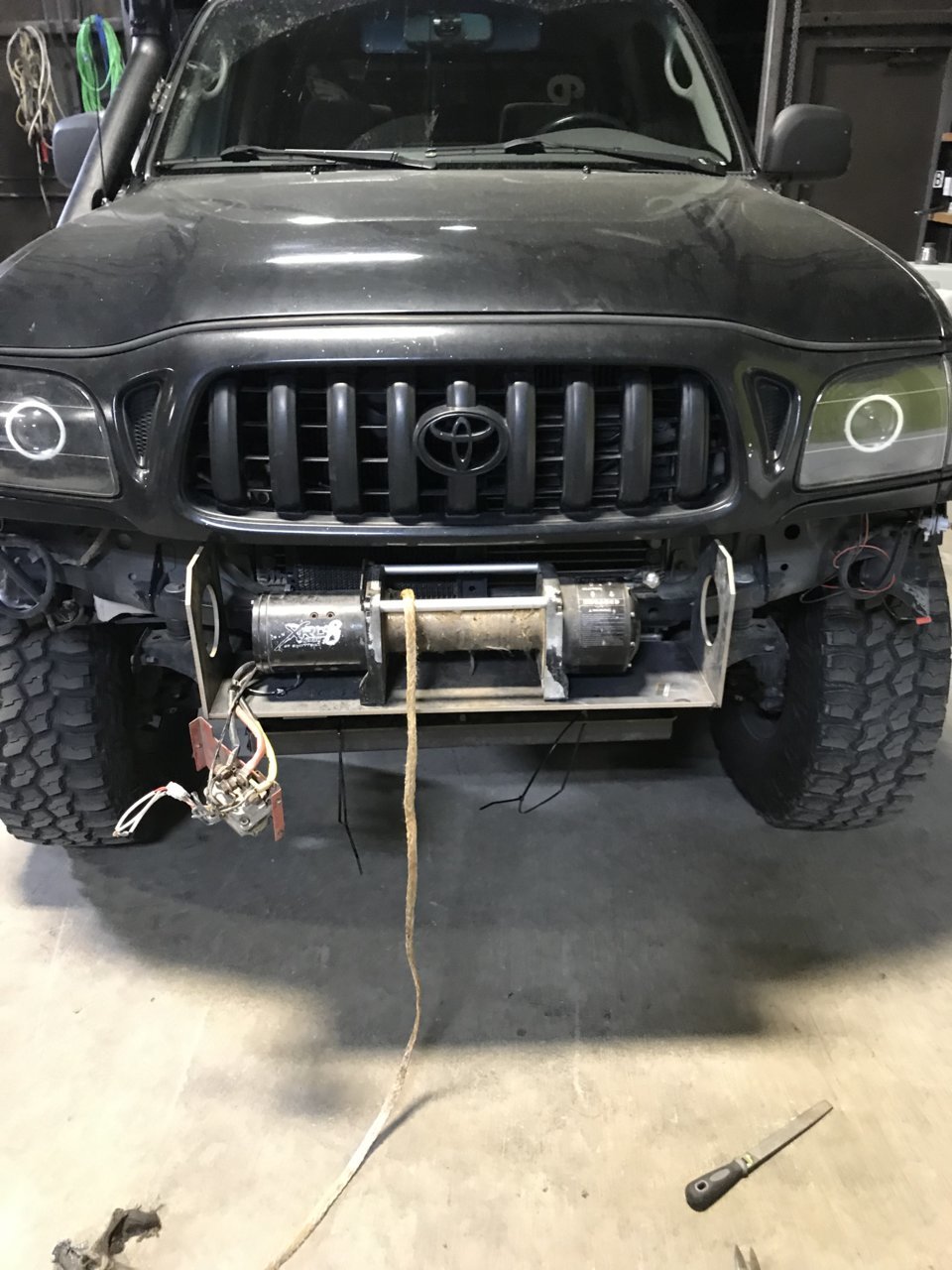

    make sure that you have room to swing the engaged/free spool lever. I had to do a bit of heating and straightening to get it to work.

    It looks like that one swings down? So he might be fine. Looks like plenty of room either way.

    Ah, I see what you are saying. Let me just say my not checking caused me a fair amount of unnecessary work.

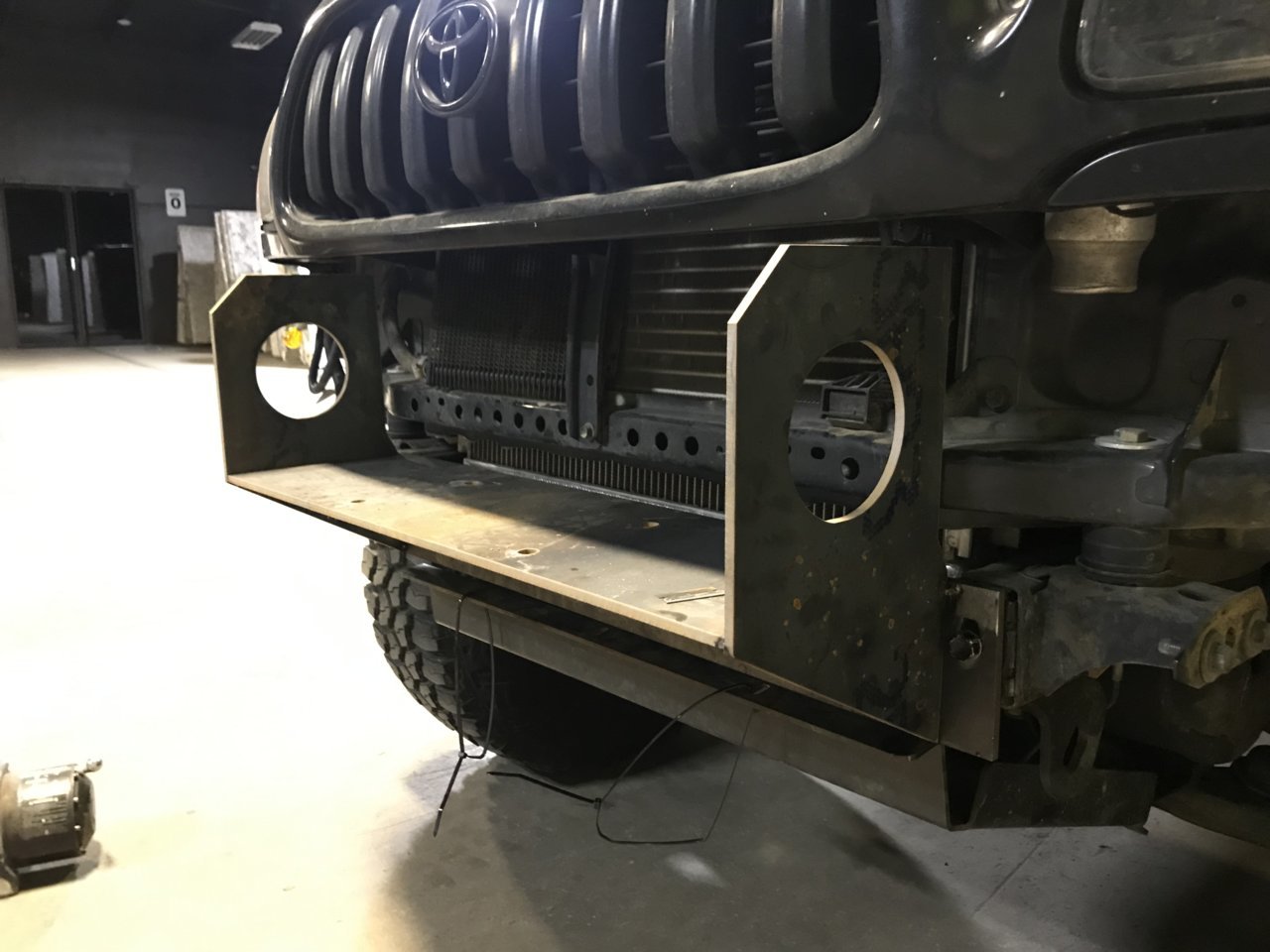

    Yes on my first wood template I made it didn’t fit. Had to make room so now I have about 1/8” clearance at the closest point.
    It actually swings up, but yes there is enough room.

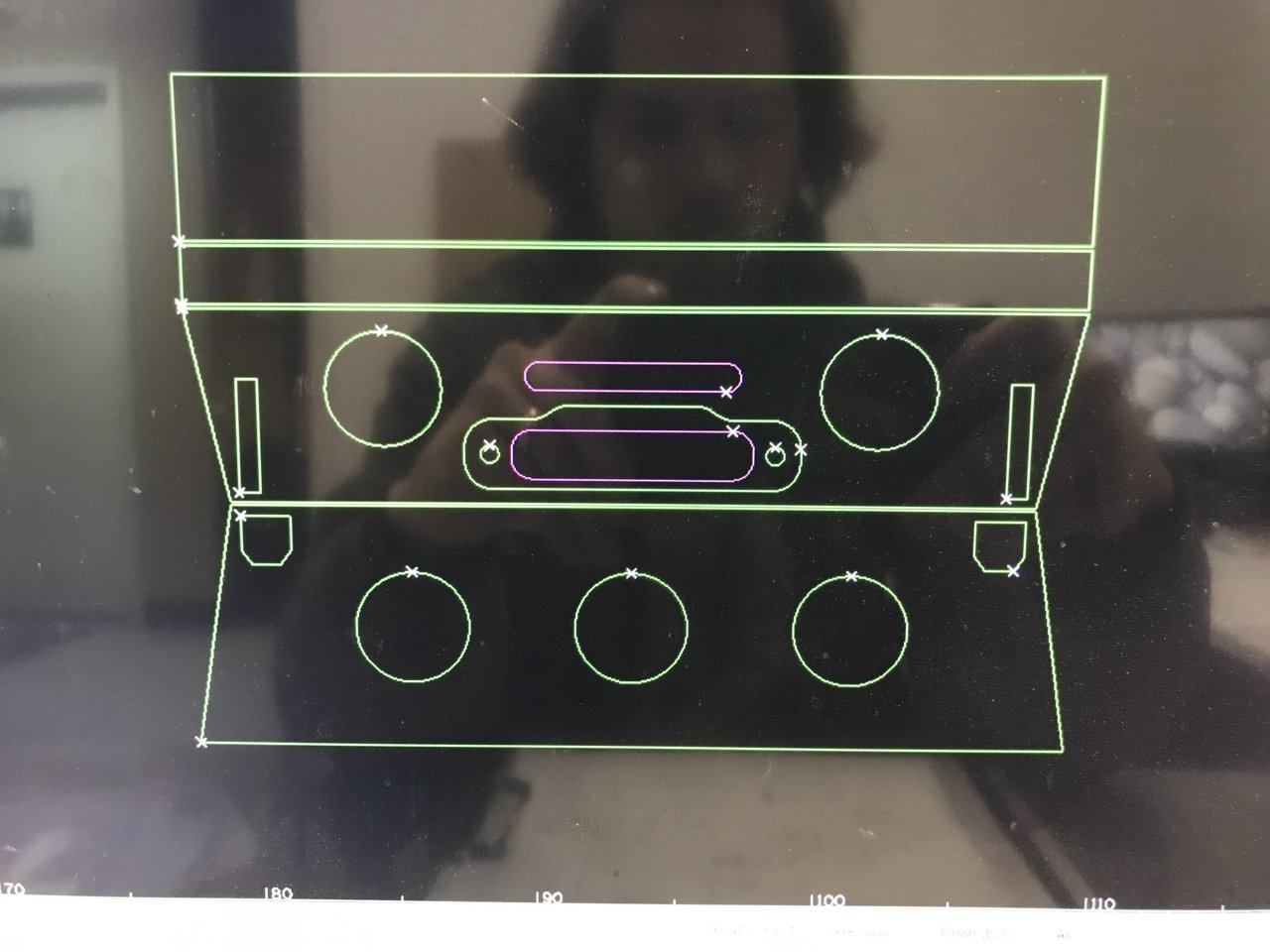

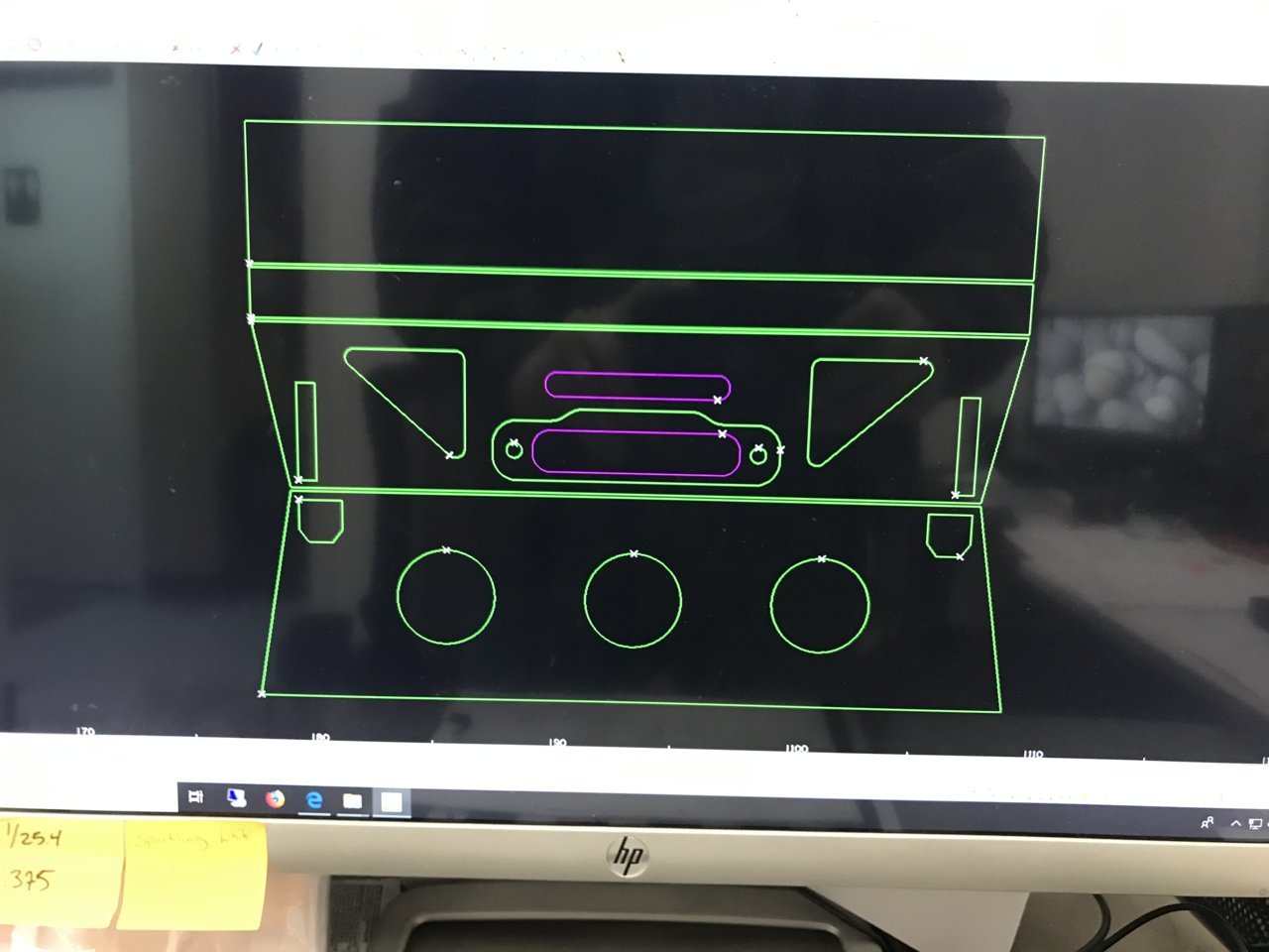

    Working on designing the front. Which do you guys think looks better?
    Option 1

    I think I like the triangles better
