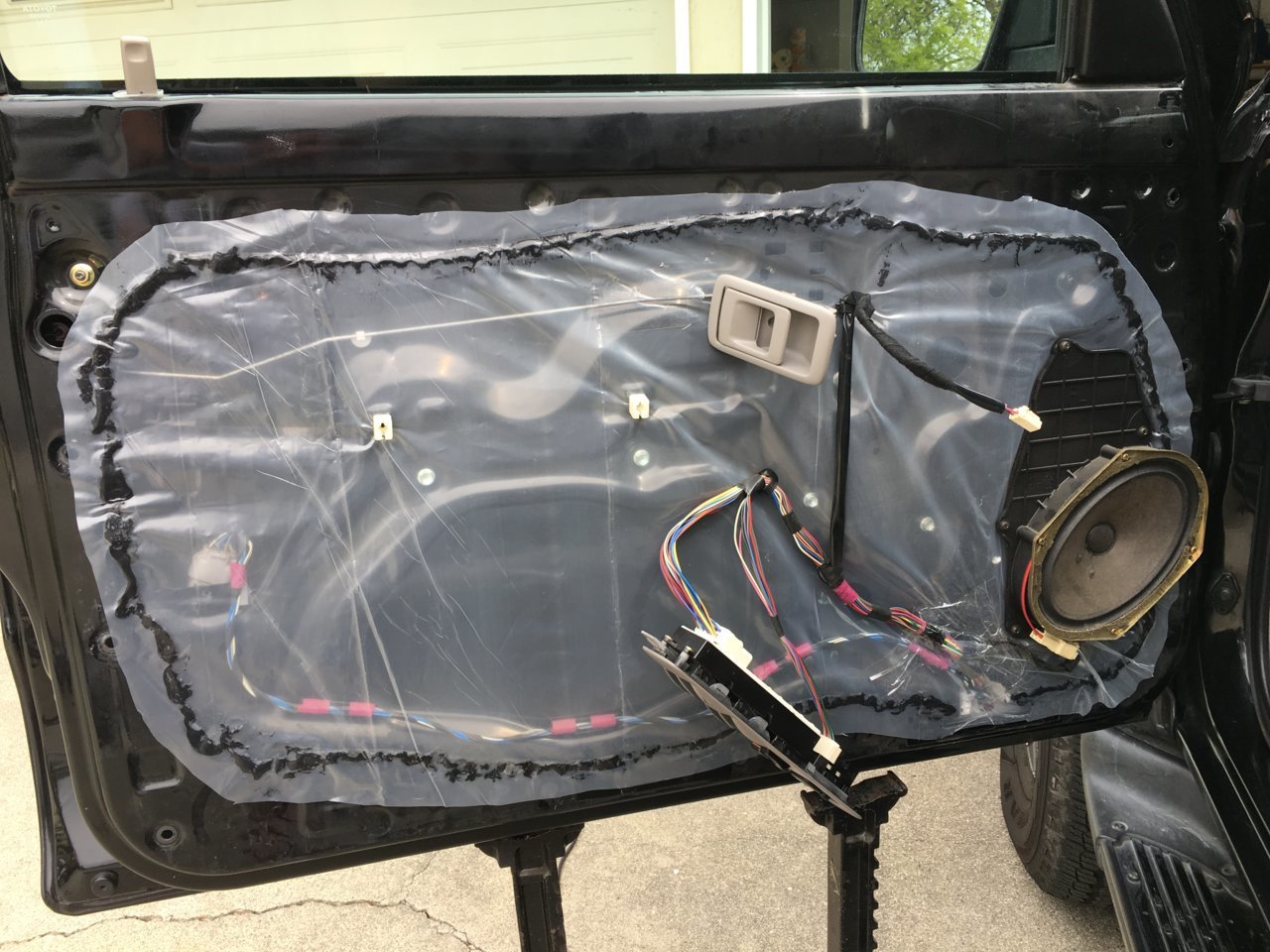

    Broke my handle today too. Rolling panel-less untill manana.

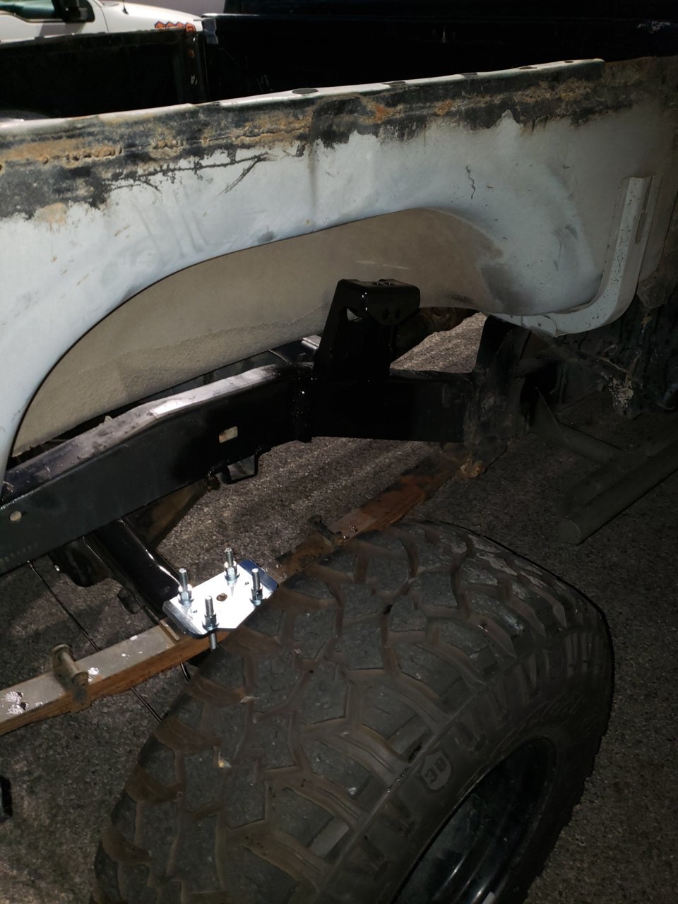

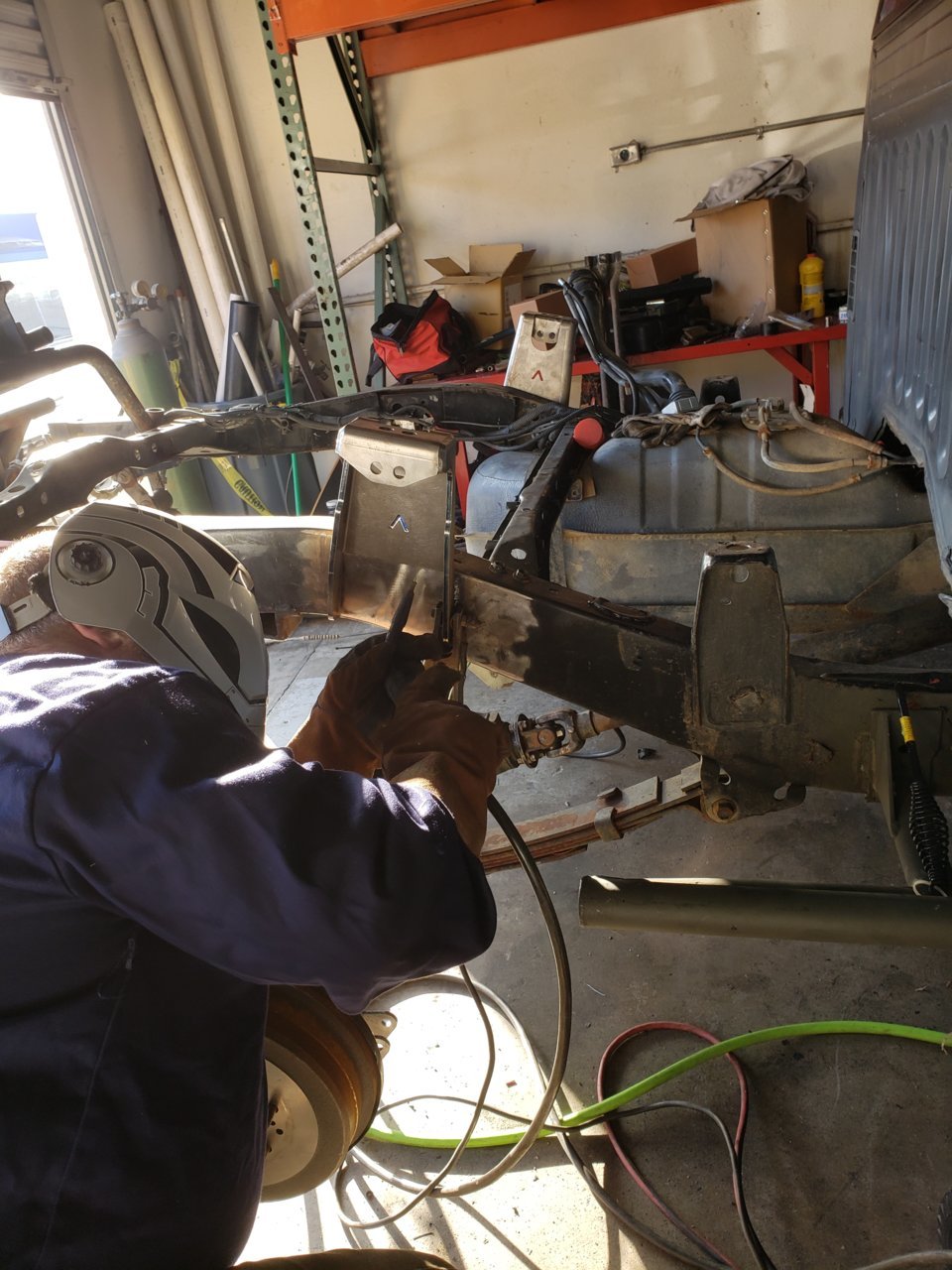

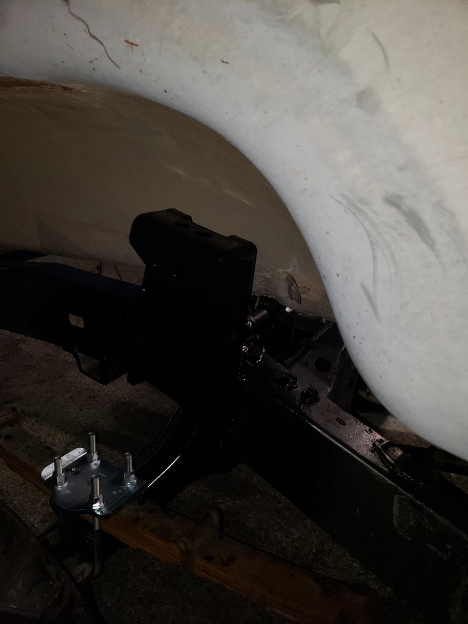

    Had a long night last night after a event so didnt get to the archive rear shock relocation but got the towers welded on today the tabs should be on at some point this week20190324_193603.jpg 20190324_174247.jpg 20190324_193609.jpg

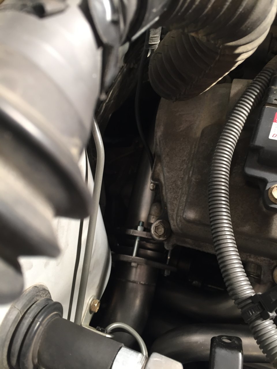

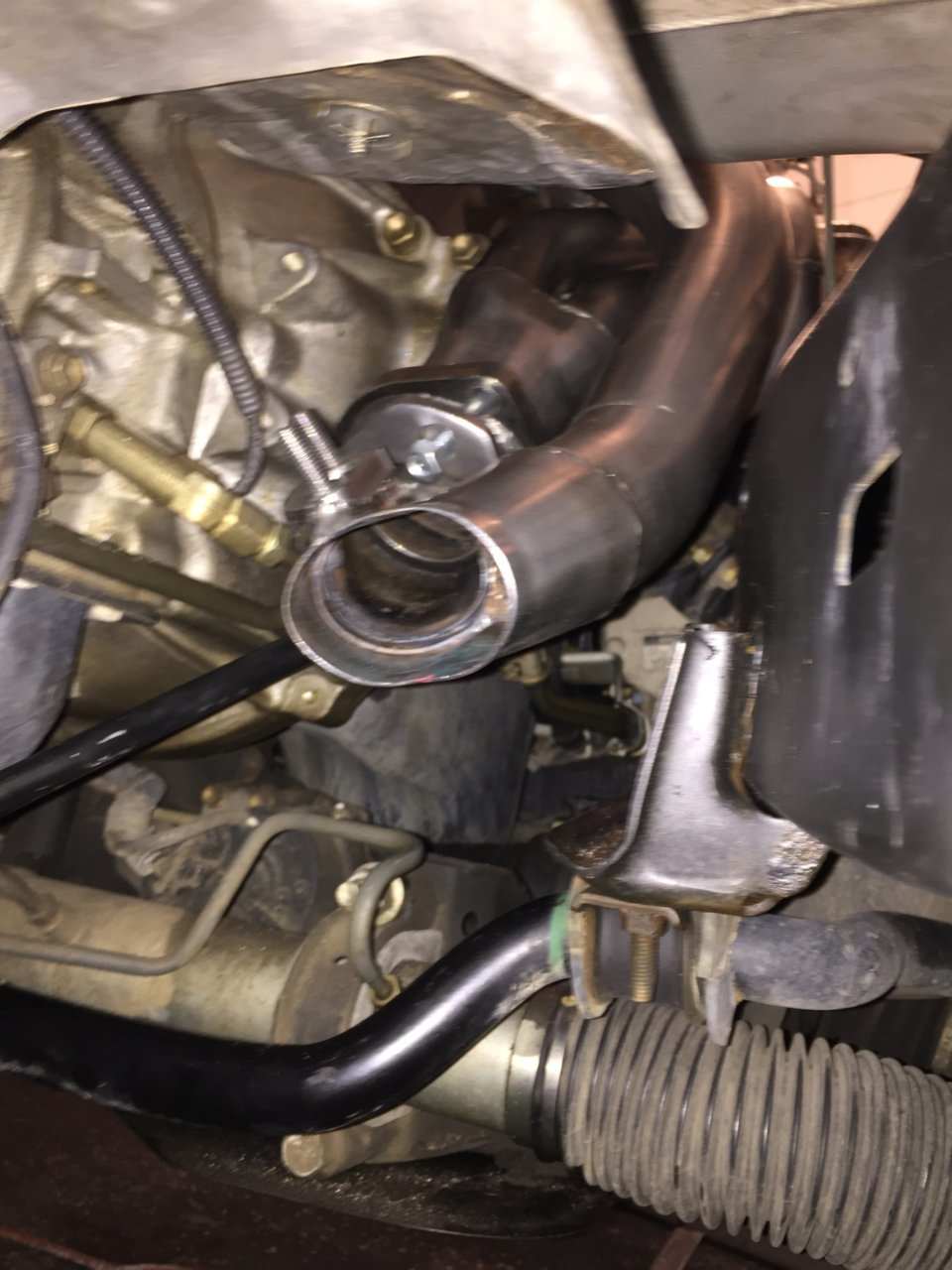

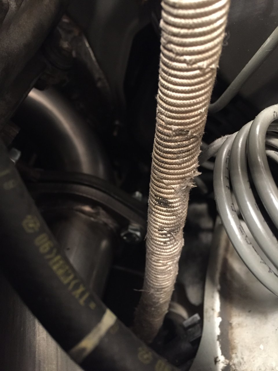

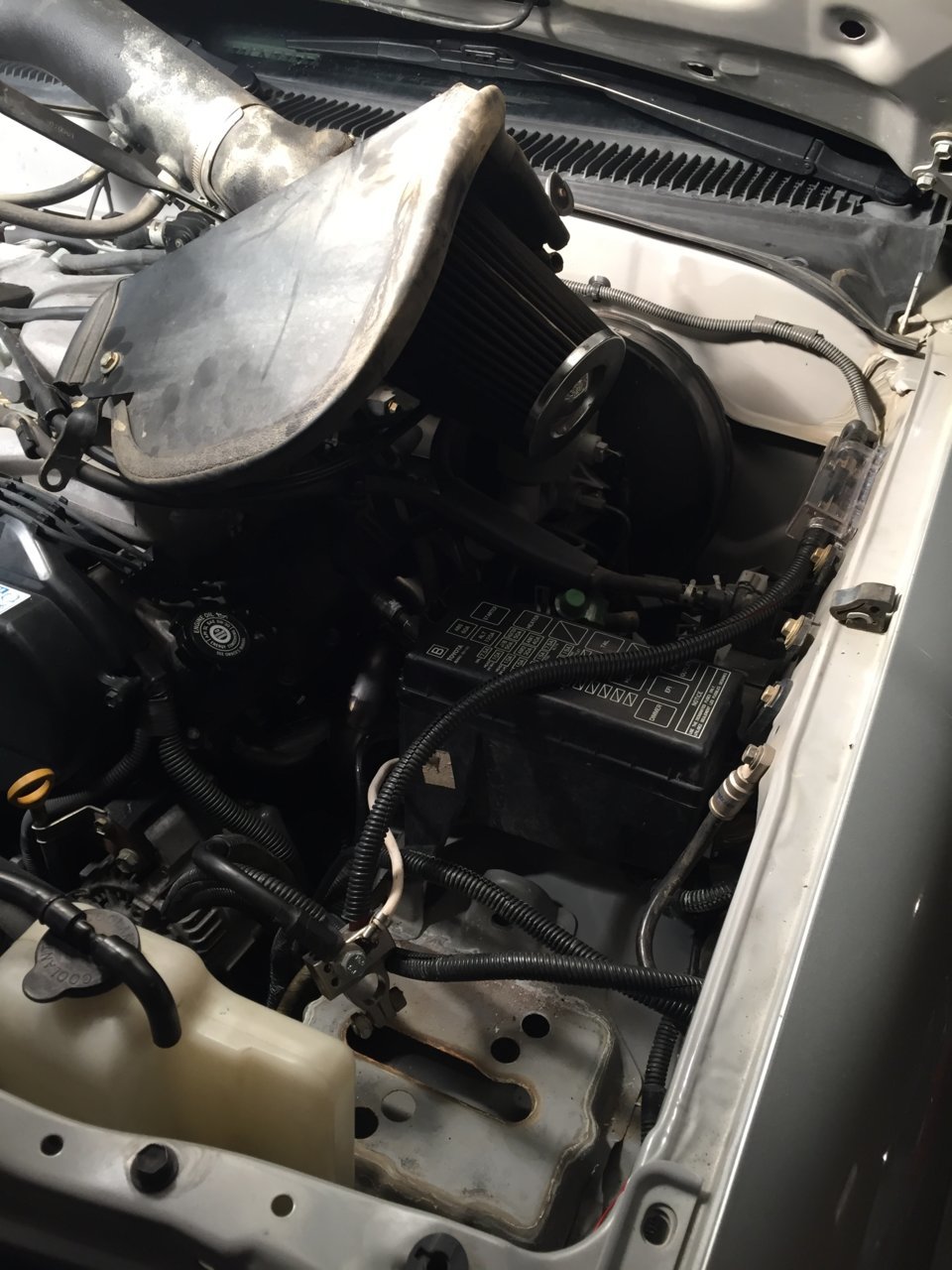

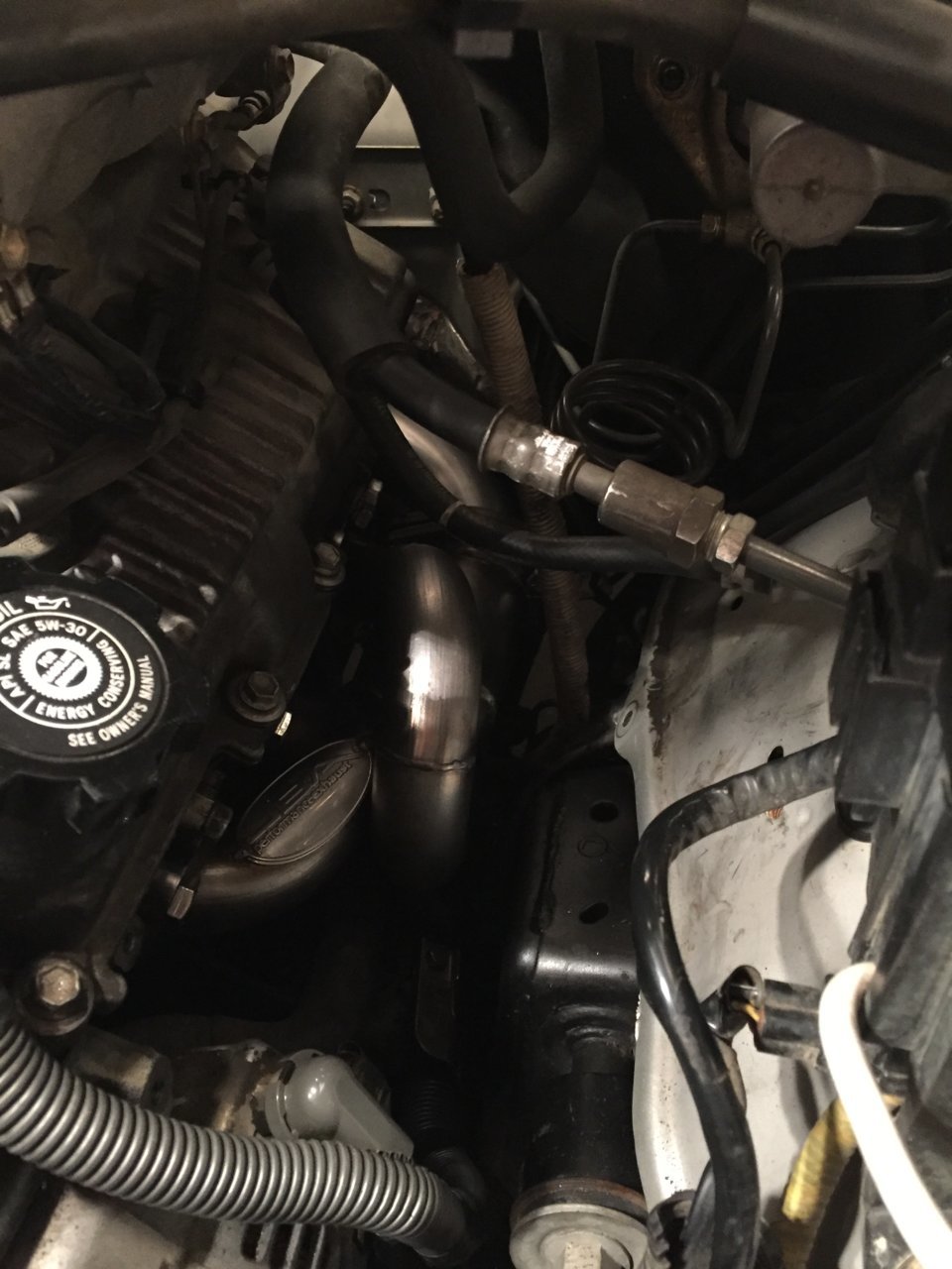

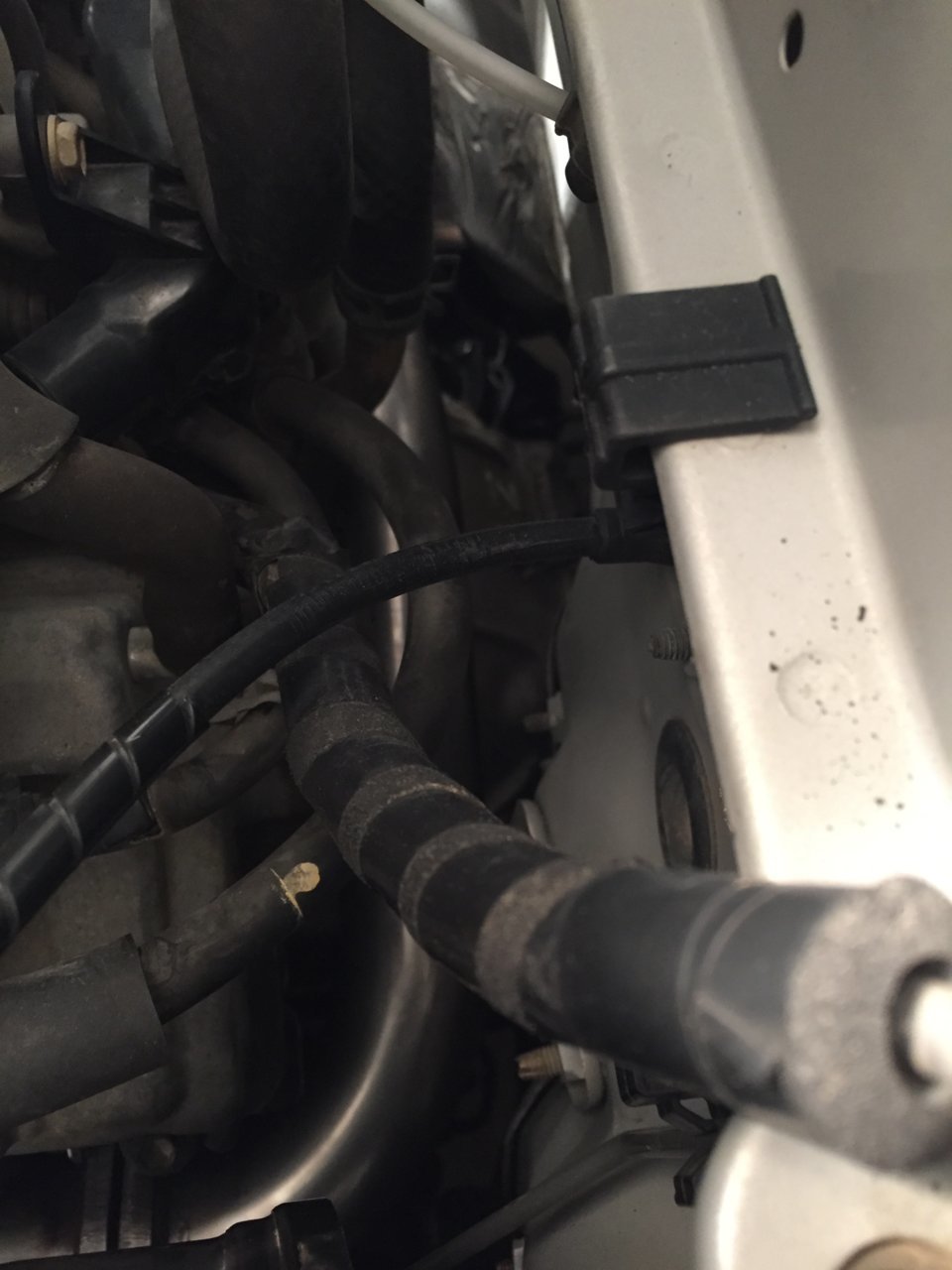

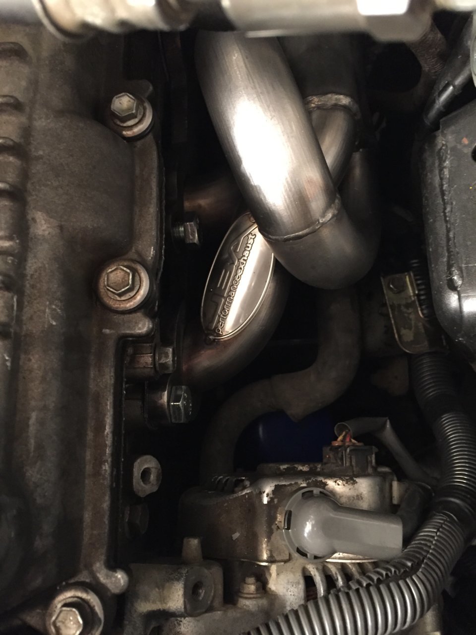

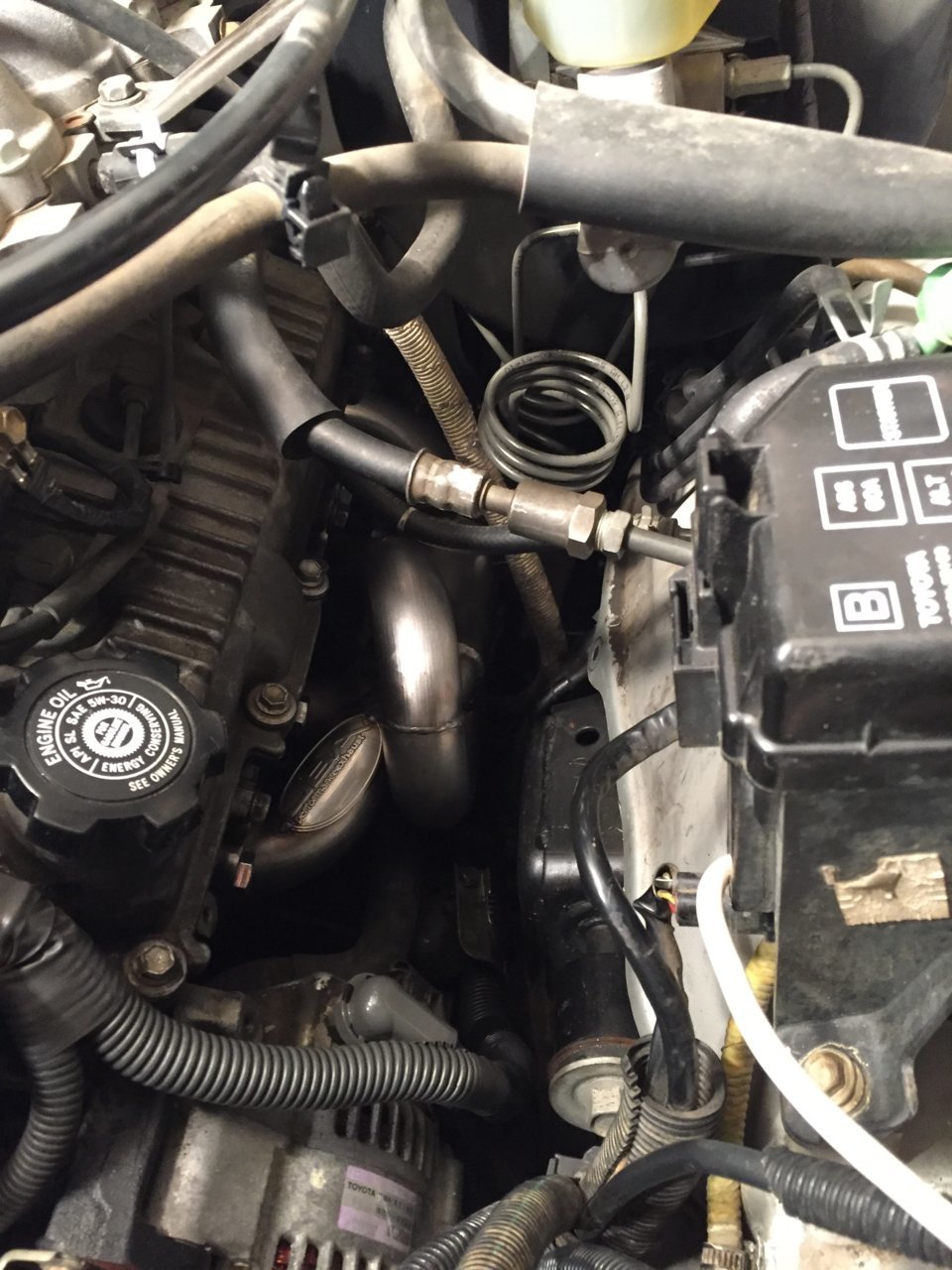

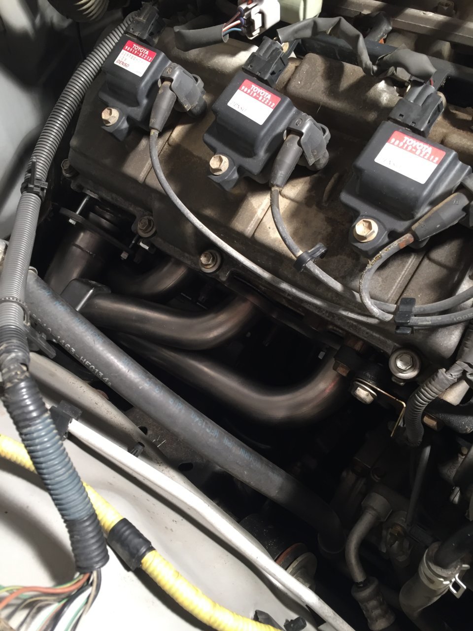

    JBA header install update

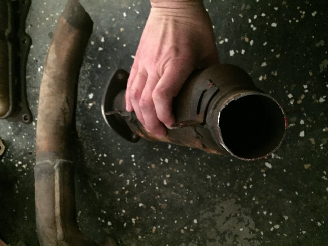

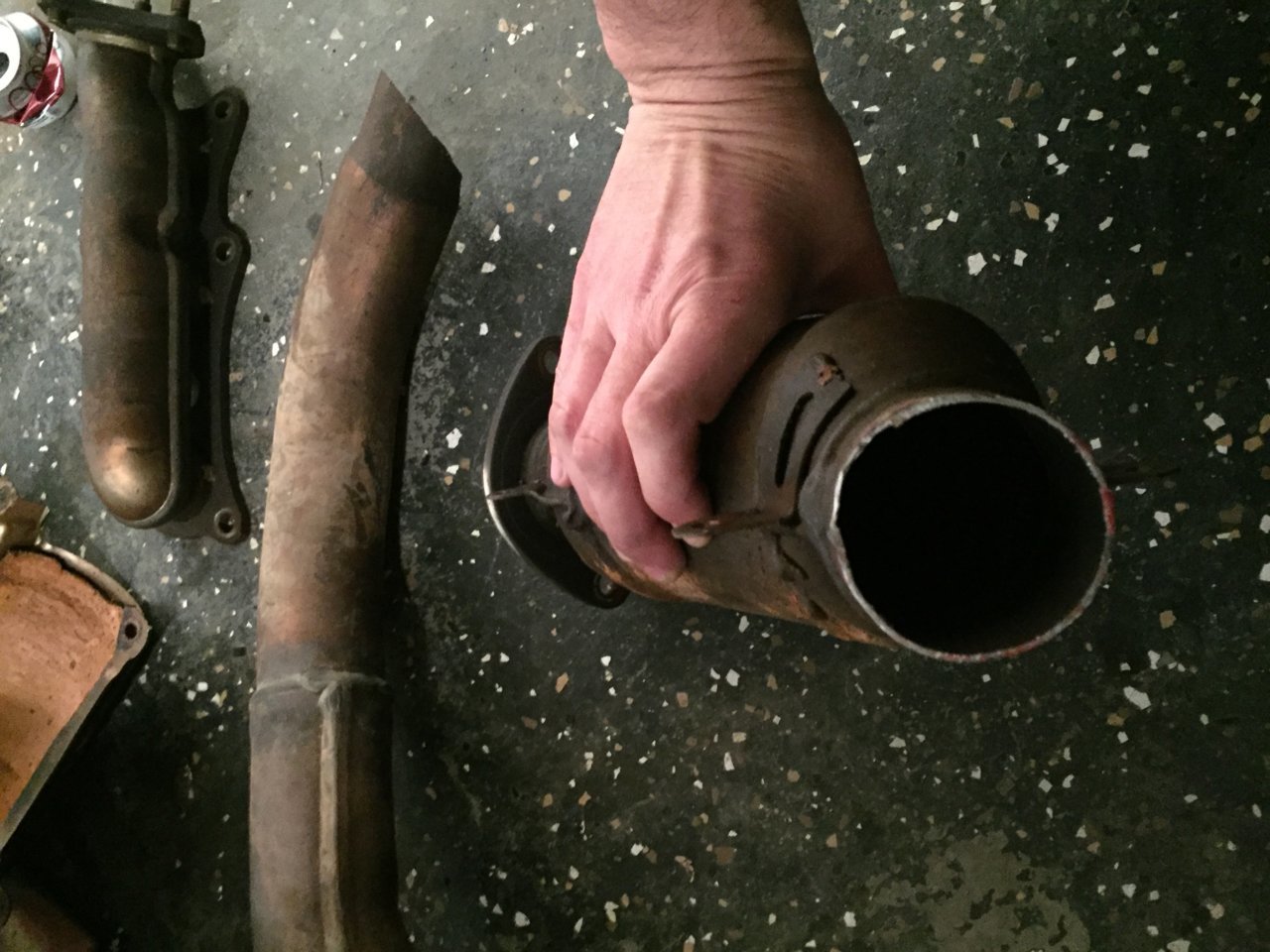

    Removing stock manifolds was not to bad. Didn’t want to remove stock studs out of fear, so I didn’t on the passage side. Passages header seems to fit fine on the stock studs. Driver side however would not go on without removing 2 top and 1 bottom stud. I bought some new locking nuts to put on the stock studs in all but two spots. I don’t have faith in the lock washers provided by JBA withstanding the test of time. Lining up Y pipe was a pain. Put the cross pipe in before you put in the Driver side header.
    Get everything in place and lined up so I can weld the cat to the y pipe. I will mark the y pipe for welding and then remove it to weld.
    Fortunately, the second cat and exhaust are on rubber mounts and have some give.

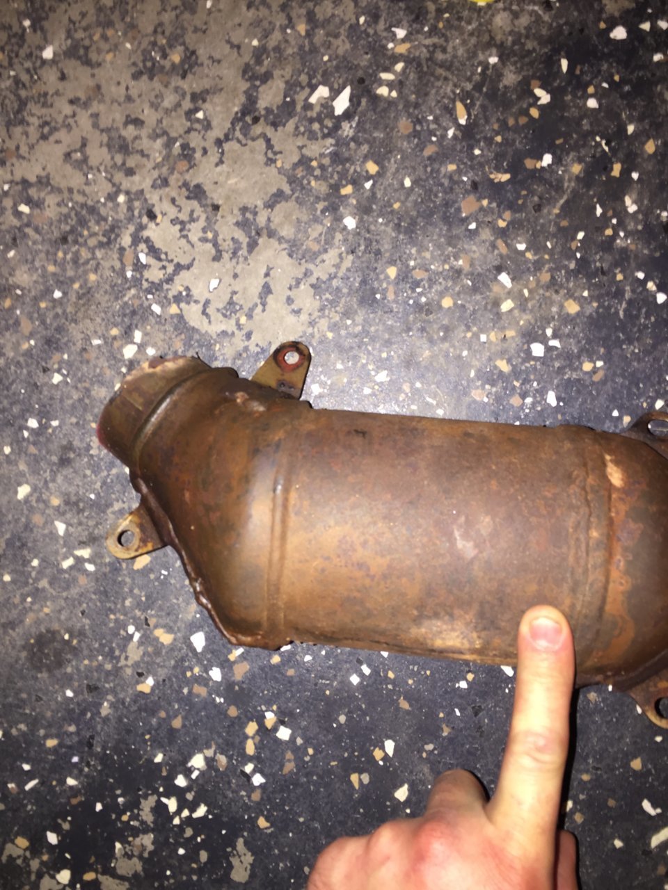

    You have to cut the O2 sensor off the first cat. I cut it as close to the O2 sensors as possible to give myself plenty Off extra metal to work with.
    I will update again next weekend

    Wow, that looks super close to the frame. How close it’s it actually?
    And the flange that is right on top of the passenger side is close to when I mocked it up. Does it touch?

    Not touching anywhere. It comes pretty close in several places . As close as 1/4 inch. May take some extra precautions with some extra heat shield.
    I have not tightened everything down yet. I’ll follow up next weekend with more details .

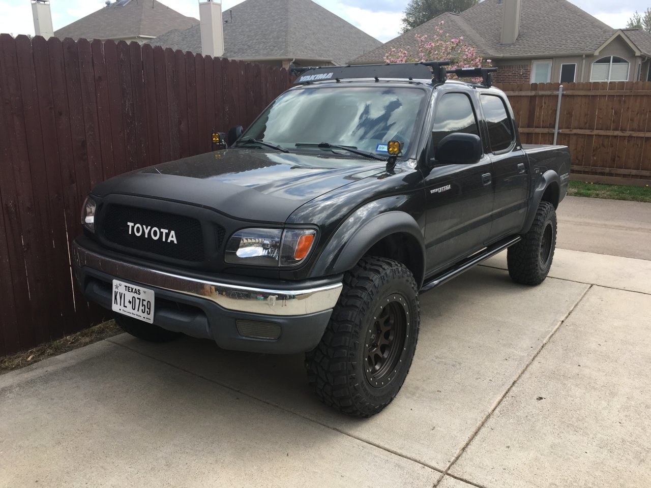

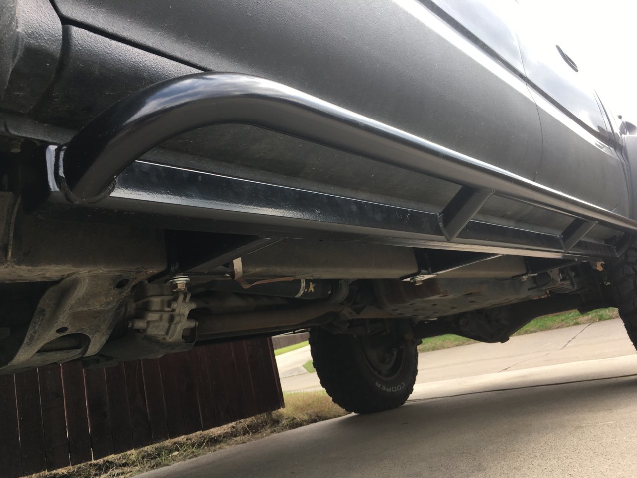

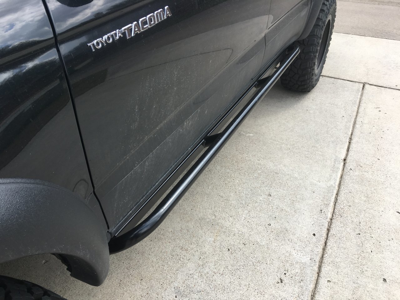

    Got the sliders on! Thanks @Oriojasjr

    I’m most worried that it would hit the frame right there at the Y and cause one hell of a racket. I’m not sure how much a motor/trans can move on the stock rubber mounts but that’s a concern.

    The engine on rubber can move around quite a bit. More than a 1/4 for sure.
