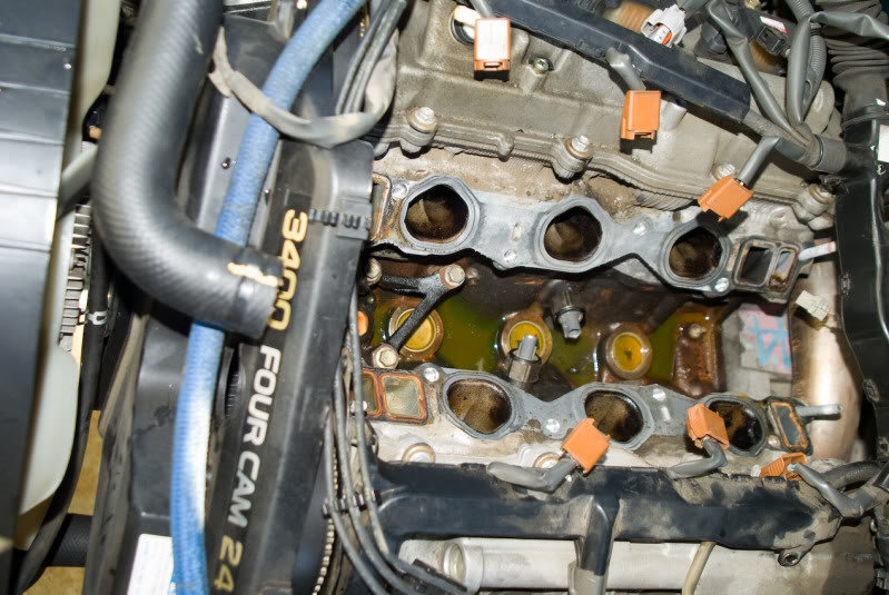

    Thanks! Definitely seems like a good amount of work. I want to verify that that is where the leak is coming from before tearing everything down. Does it normally fill the whole valley with coolant? The front of the valley is dry on mine. It also seems like it would leak down the passenger side of the engine as well, which mine isn't doing. Just the drivers.

    the ones ive seen differ on where the leak. some passenger side some driver side. just depends on where the "gasket" on the plate is more open i guess (its not a gasket but kind of? its foam i think)
    but judging by your pics id say is safe to say is that coolant plate. ive never seen a head gasket leak that bad. The front of the valley is taller so it'll fill till it leaks out the back.

    Will it hurt anything to drive it like this for a little while until I can get this fixed? As long as I keep an eye on the coolant and add as needed?

    ive never seen people who ignore it have issues. but im sure it potentially can cause issues with the knock sensors eventaully
