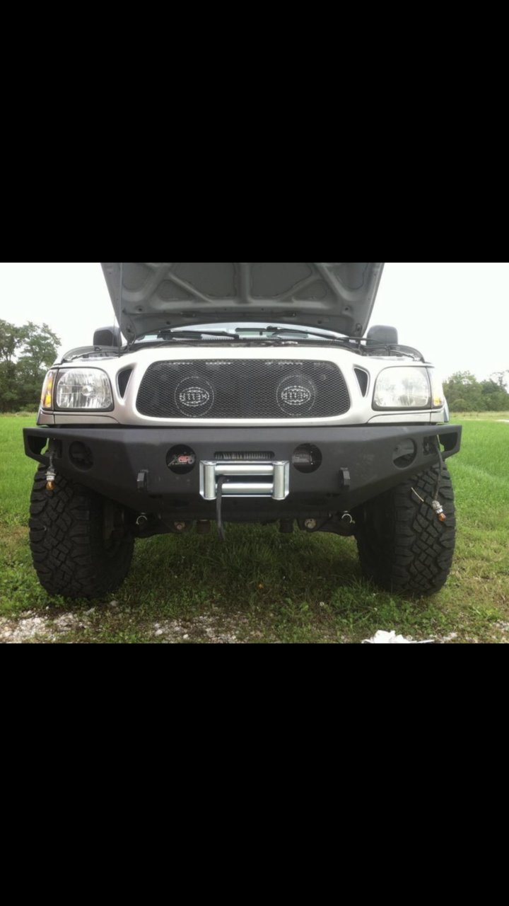

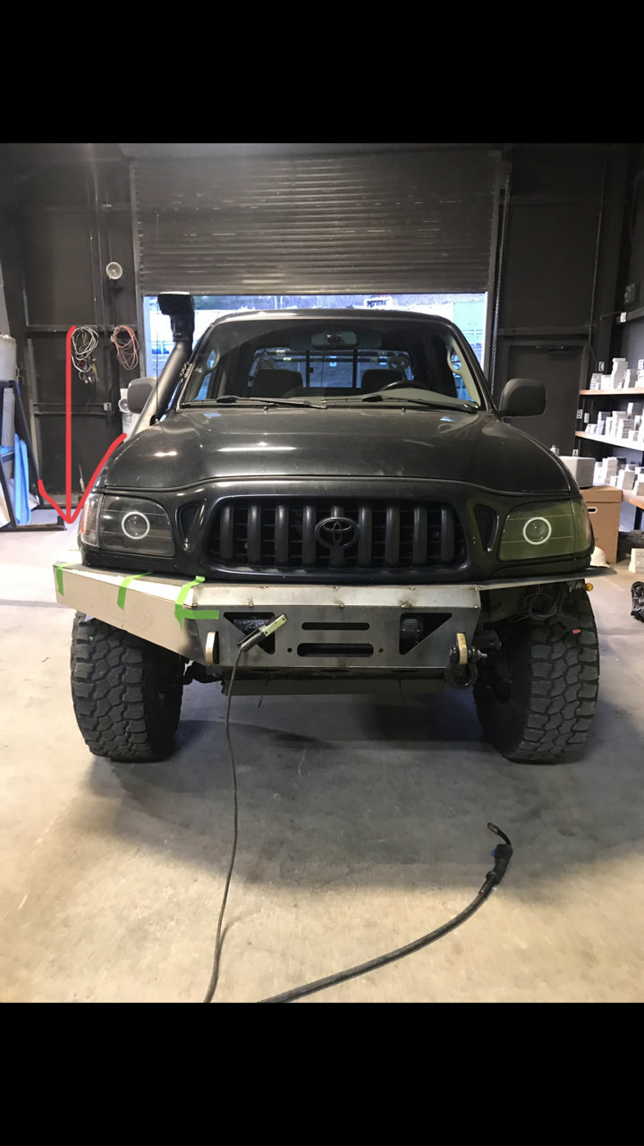

    Need some visual advice. I’m in the middle of my bumper build. Can’t decide if I should keep the sides this wide or cut it back 1”?
    Other pictures of the elite bumper for reference. Let me know what y’all think.

    I vote trim it an inch

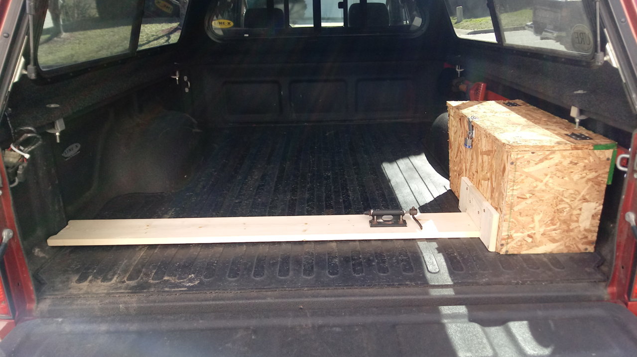

    My dad always use a 1x6 across the bed. I adapted it to fit with my toolbox. 0302191347a.jpg

    I'd trim it and get it a bit closer to the truck. Unless you plan on doing full hoops
    Edit: or just trim the corners a bit

    trim it

    Trim it. I wanted to say something when you first posted the design but didn’t want come off as a criticism. Now that you ask though I say trim it.

    Trim it. And can you angle the sides a bit more? I feel you will be losing some approach angle on the sides with the walls being straight down like the center.

    Thanks guys for all the input. I’ll work a little more on the design today.

    Trim it by putting an angle to the corners and make the ends smaller for better clearance.

    Ill play around with this option too. really want to keep it as close as possible to the original elite bumper design.
    By the way did you decide if your doing full hoops?
  15. Mar 29, 2019 at 8:31 AM
    xtremewlr
    xtremewlr Well-Known Member
    Oct 25, 2018
    #270626
    8,394
    Todd
    Tucson, AZ
    2003 4Runner V8 - 2012 b00sted XRunner
    I have mods
    Nope, not doing the full headlight hoops. Going to add a kicker to each side of the center hoop and fill the cutouts on the ends somehow.

    Im still trying to decide what to do with mine.
    Filling the holes should be fairly easy.

    Yeah, I'll probably weld some of the pipe for the headlight hoops in there and then cut them flush and weld a cap in place. Something along those lines. Waiting for the additional material being sent out to increase the thickness of the recovery points, then I'll finish up the front bumper. Again.

    Yeah, get a copper spoon and draw around the hole with the welder. Take a few passes, then grind smooth.
