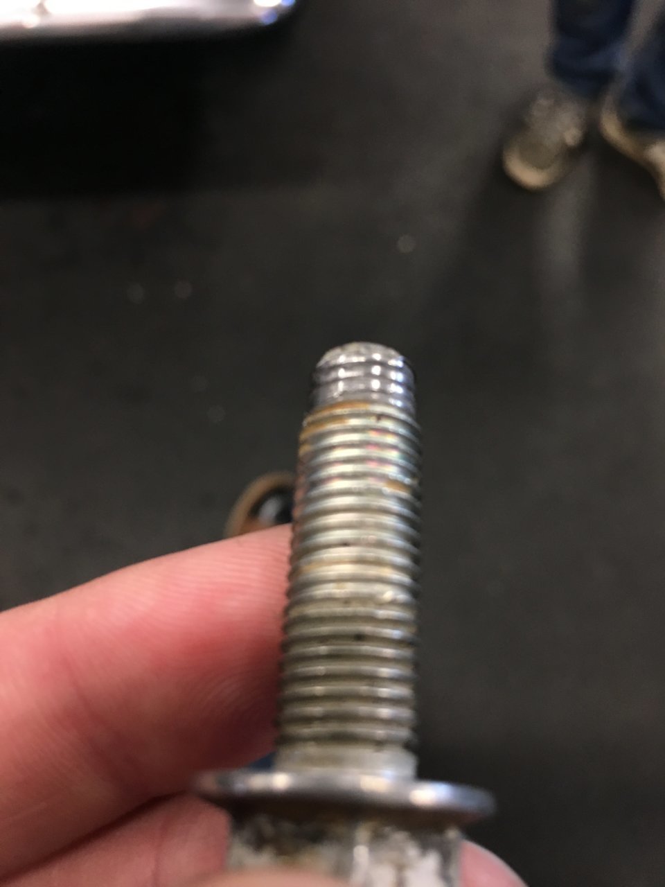

    Thanks. I said torque but I meant impact wrench. The impact wrench could not overcome the stake.

    I used new oem bolts when I did the ball joints.

    Tried chasing them with a new bolt . I think I’m either going to helicoil it or just get a new spindle.
    Anyone know the part number for the spindle?

    only thing id trust is a time sert. helicoil is kinda weak for something like that.. probably best to replace the spindle seeing how 1st gens dont like balljoints and their bolts

    I usually use a punch and smack the part that was staked but in the opposite direction. Or small chisel point.

    Yeah, normally I would agree. Unfortunately, no way to get behind the stake.

    Why? Just turn it till its at a good angle.

    There is no gap to work with.
    edit. The trans mount crossmember is also in the way.. I have one small screw driver that might work to get into the small gap but no way to get a good swing at it.

    Hmm. Need a bigger impact then I suppose. Or drop the crossmember.

    I just have someone hold the brakes in gear and reef on it with a breaker

    leverage would win here for sure. If Mike can get some help with that.

    Working alone here. Frustrating for sure.
