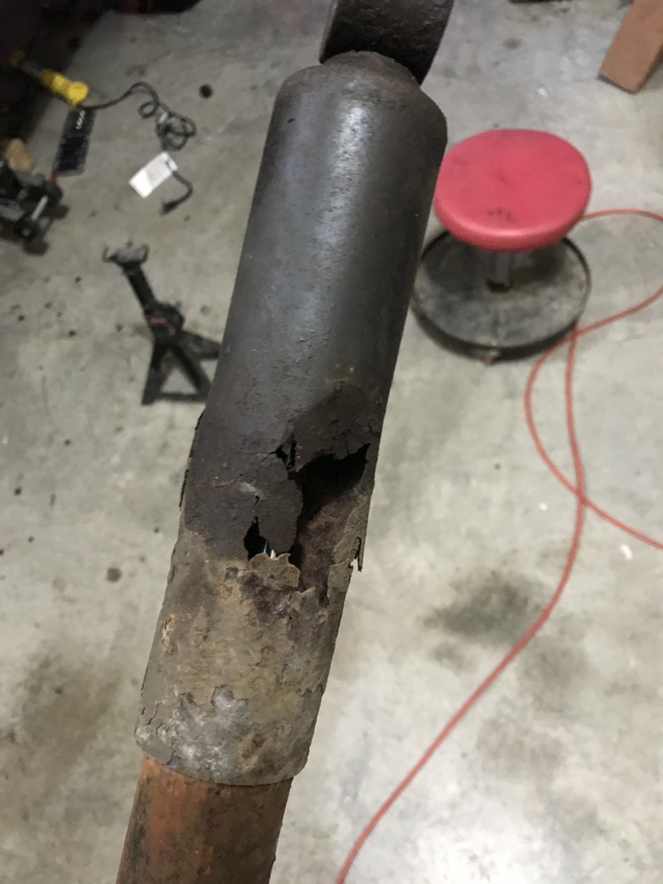

    Well decided to do some maintenance on my 2000, has 146,000 miles. This weekend radiator cracked so that got replaced. Replacing the shocks and coils. Got the rear shocks swapped out today. After looking at the stock ones, I guess you could say it wa time.

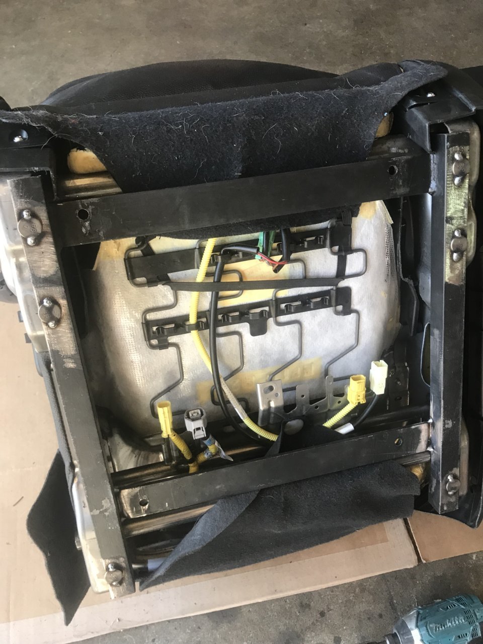

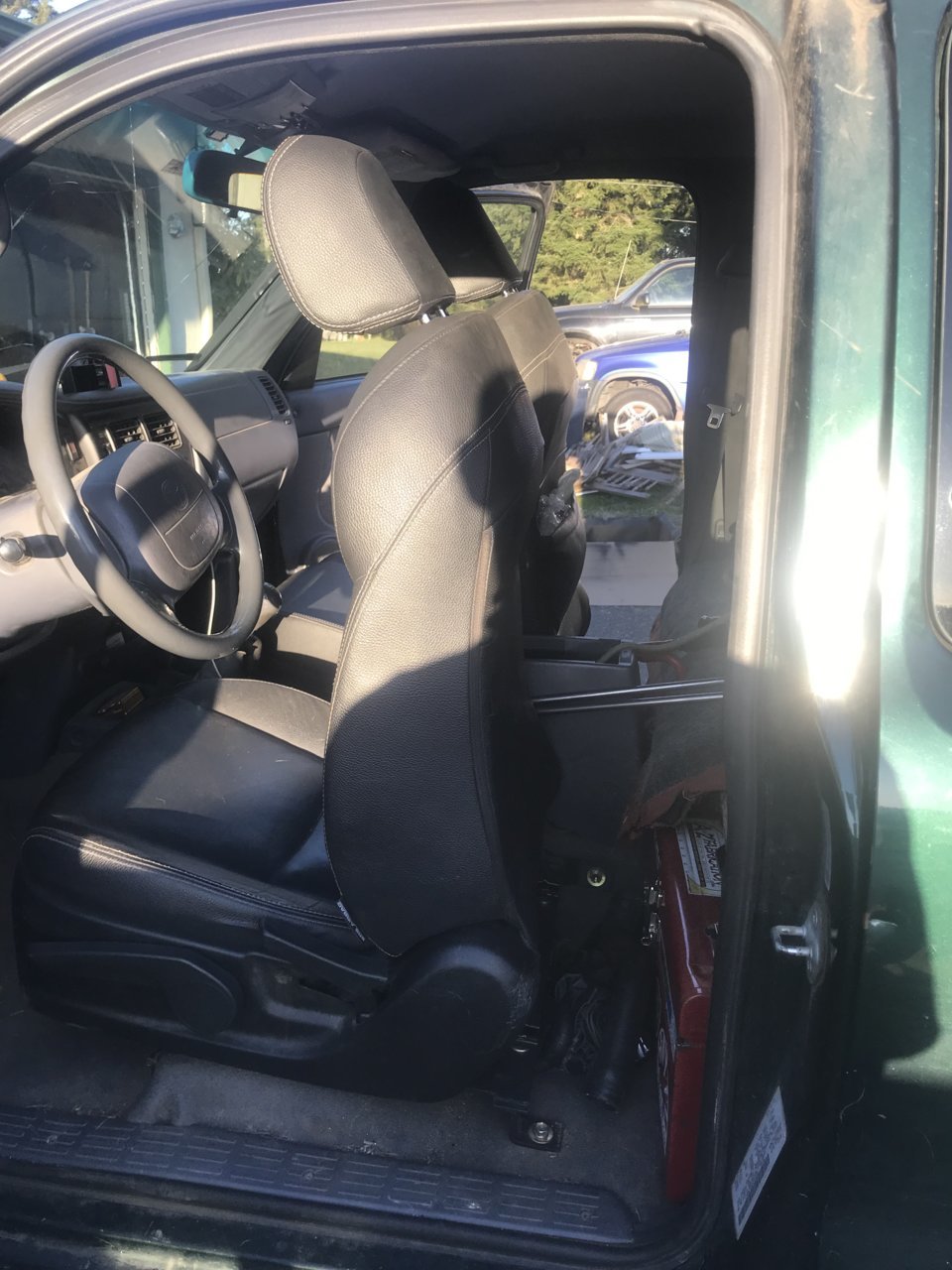

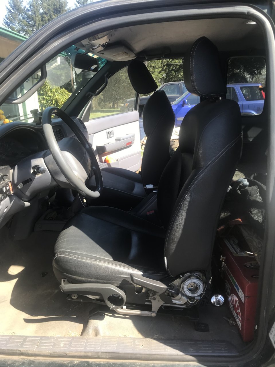

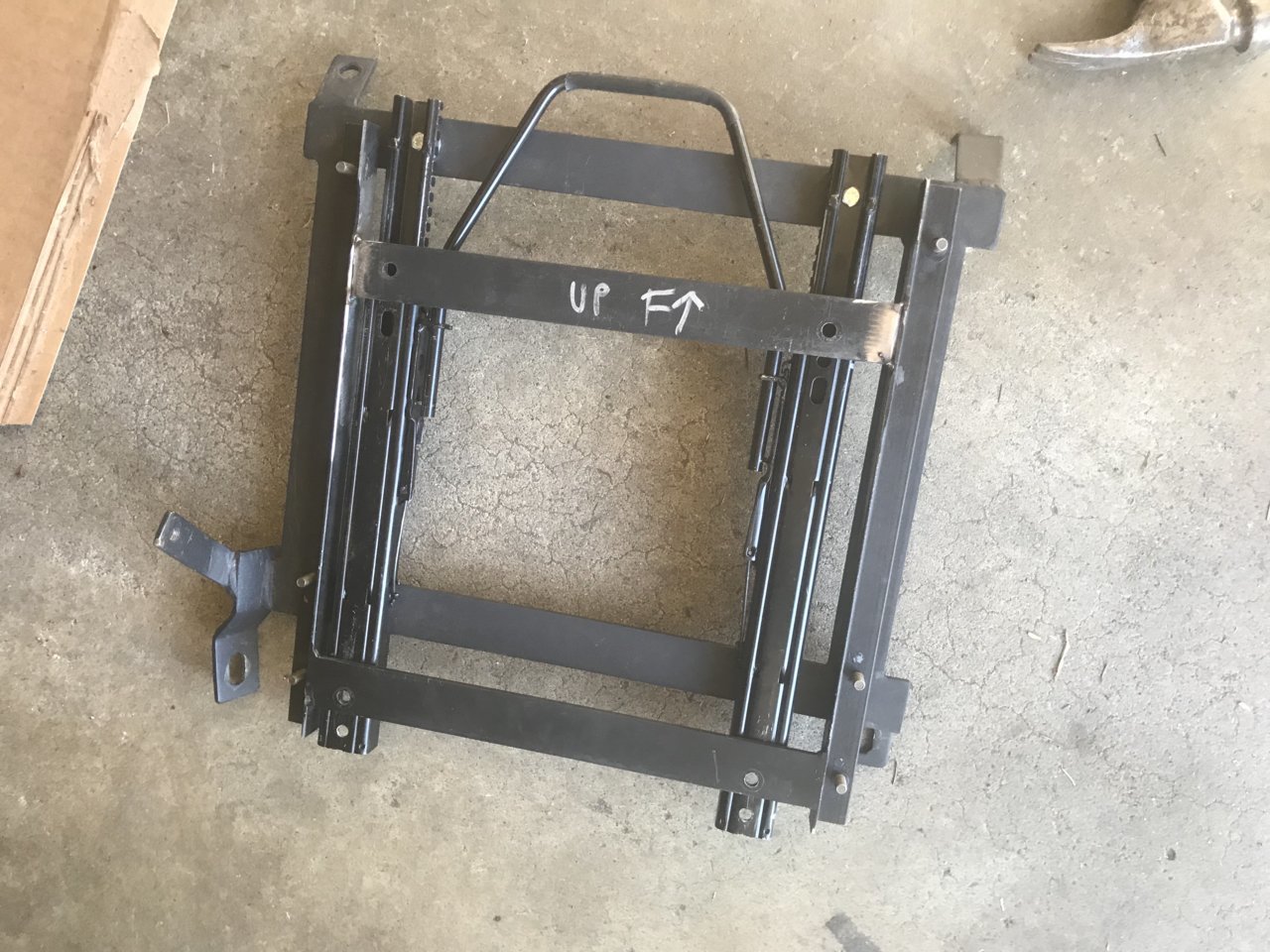

    I finally got my seats dialed in.
    842CCF30-365A-4A35-9F07-2ECE10B588CE.jpg Thanks to witch doctor for selling me a pair of Corbeau seat brackets.
    About 2 years ago I swapped out my stock buckets for leather seats from a Subaru XV Crosstrek.
    From the get go there were obvious problems, and with that, my obvious mistake- didn't try out fitment first.
    For starters they sat about an inch and half higher or more than stock. Passengers over 6’ tall were not comfortable at all, especially wheeling since they said there center of gravity was scary high. My wife who’s 5-7 wasn’t happy with that either. Most guys were almost hitting their head on the headliner, had to pitch the seat back to have head room so had to find a solution or go to new seats again.
    For me as the driver the height was good for some reasons like seeing over the hood on trails, but I was hitting the top of my head trying to get my head out the window to spot myself.
    Even the sun visor was an issue now since when it was down it was so low I couldn’t see under it.
    The hood also produced a ton of glare from the higher sight line which sucked at night with car lights and sunrise/sunset. I alleviated that by bedlining my hood, and happy I did.
    The second issue with sitting so high was my dog hated the new setup because she couldn’t get her head out the window. anymore. This issue I can’t solve since the seat backs are really tall, again, could have figured this out by going out and sitting in the seats in the oem car.A647A9F1-54E8-454E-B4F5-55DB214BC389.jpg
    Total bitch getting them perfect, I dropped them as low as I could using angle to drop the height below the Corbeau sliders, still wanted as much range front to back as possible, lost a little from the stock Subaru sliders that traveled about 8” since the Corbeau brackets had about 2” less travel front to back.
    Third and possibly worst issue for me, since they were from a 4 door vehicle they didn’t swing forward far enough for me to get into the back of the cab. I dealt with this for like 2 years, I don’t know why, it was a fix that literally took like an hour per seat. F3436A07-4579-488B-AC7B-B073D9F4738B.jpg Passenger side is how far it pitches forward now, driver side was as far as it went forward...for over 2 years. That forward lever is a height adjustment so I can still raise the seat a good 2+ inches when I’m on the trail.
    4E7EBBE4-22AE-4644-8E01-63CB44670E8A.jpg Huge improvement
