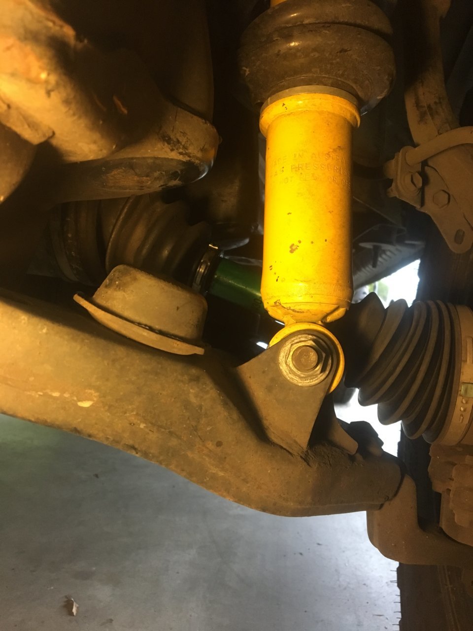

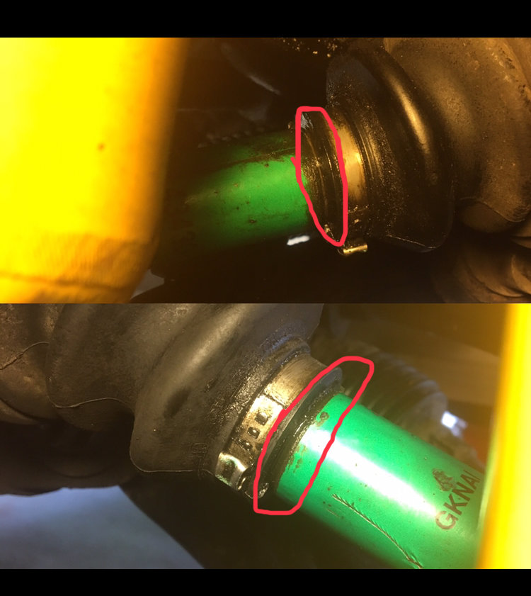

    You can see metal if you zoom in the picture, closest to the tire side. Yeah that was definitely where the grease was coming from. Just seeing if anyone else had success with re clamping them. I don’t want to take the boots off if I don’t have to...

    Sure, if you don't use cheap shit hose clamps with sharp edges, you can prolong your CV boots. I had the same issue on the passenger side of my truck right before I was about to take a long road trip. I bought two separate bags of hose clamps after researching - smaller and bigger for both sides of the CV boots. $35 in clamps and I have a surplus now that I supply to friends and family that start having leaking boots or want a trail fix in the toolbox.
    I have about 5,000 miles on this so far and I haven't touched it once after initial install and ensuring it was still tight after a short test drive.

    Definitely worth a shot to put a worm clamp on them and see if that helps.

    Is having 887 coils not crazy on a first gen?

    I thought so too at first but after looking it up, 883s are 375mm and 590# and 887s are 400mm and 590#, so they really aren't much different. Just a tad taller

    Wonder how much weight he has up there and what his cv axle angle is.

    Here’s a better shot of the highlighted area where grease can come out of the boot:
    Thanks for that information! I’ll try and find a link when I get home on a computer
    Okay so I fudged up, I had 887s on my 2015 Tacoma... I currently have 883s on this 2002 Taco
    No weight currently. Waiting on a steel bumper to come next month from Relentless. Should add #150 up front and close to that in the rear.

    Yeah thats a little on the steep side. That bumper should make it more reasonable though. What does your upper ball joint look like?

    You can see the grooves in the outer CVS. Too tall. The bumper will help a bit.
