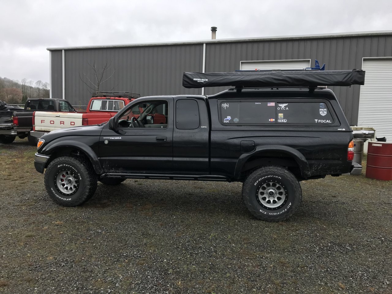

    That’s hawt. Twins on the rear set up! :cool:

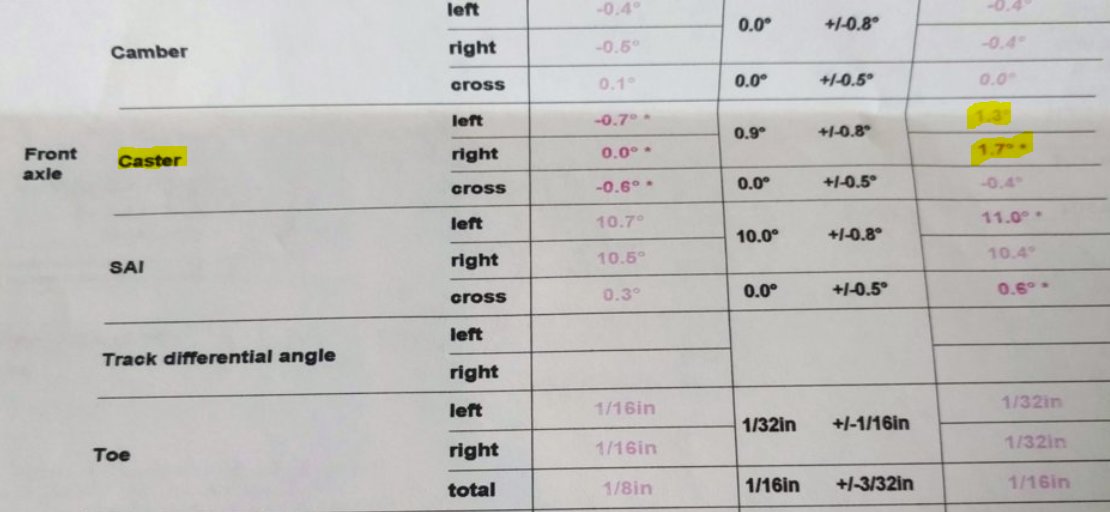

    Back after I installed my OME kit, I took it in to toyota for an alignment. They said they couldn't do any better and had me in negative caster. They said only aftermarket UCAs were the solution. Here is the report:
    After discussing here in my local area section, I had a referral to a shop specializing in alignment only - its all they did. Several other TW folks had used them so I quickly made an appointment. Cost a bit more and I was already out what I 'donated' to toyota but the techs at this other shop had me back into positive caster and everything else dialed in as well - all with the stock UCAs. FWIW, I was running 265/75/16 at the time.

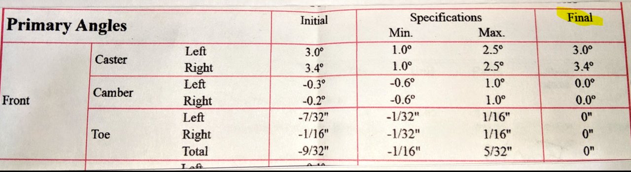

    on the subject of aftermarket UCAs, just a few days ago I installed SPC UCAs since I was moving to 255/85/16s. Took it into my new "go-to alignment shop" and here is what they have me at now:
    Its all about the tech and how they do their job.

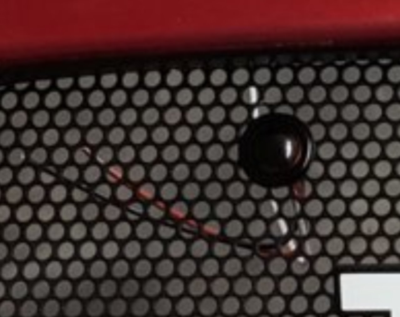

    Curious though, what's this? Adding LEDs?

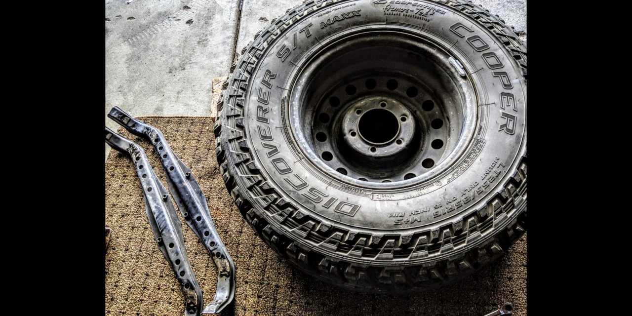

    Met up with @loyaltothetaco to exchange spares, he needed one of my recently removed 265/75 KO2s and I needed a 255/85 spare. Worked out perfectly - thanks bud, good chat this morning.
    Thanks for the patch :thumbsup:
    Now I just need to hammer out my spare tire tabs so it'll fit o_O
