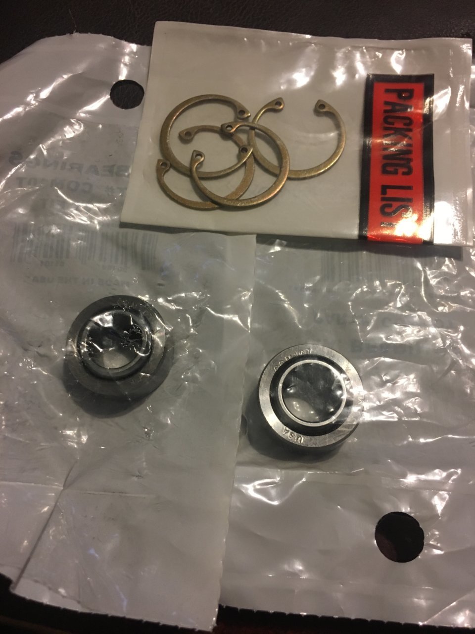

    Hoping these fixes my creaky noises when turning slowly, probably won’t get to put them in until Friday or Saturday.

    Creaky noises when turning slowly? That would almost certainly be uniballs and not spherical bearings on the shocks.

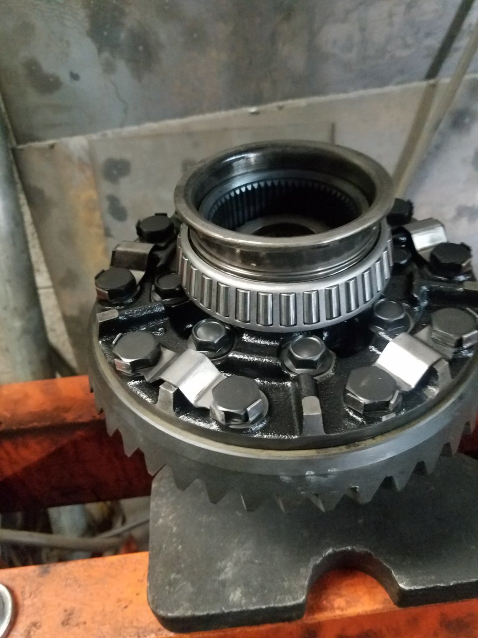

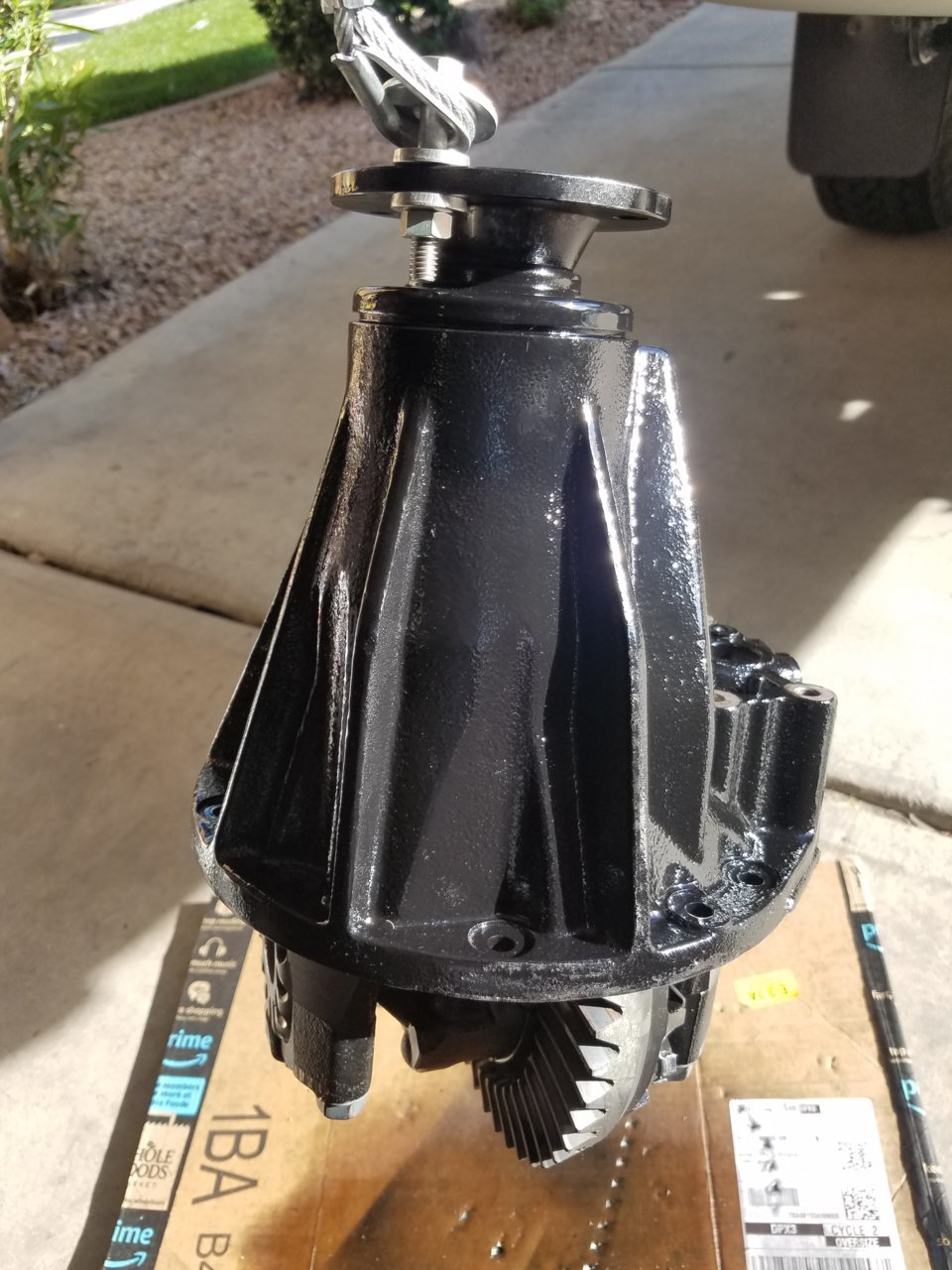

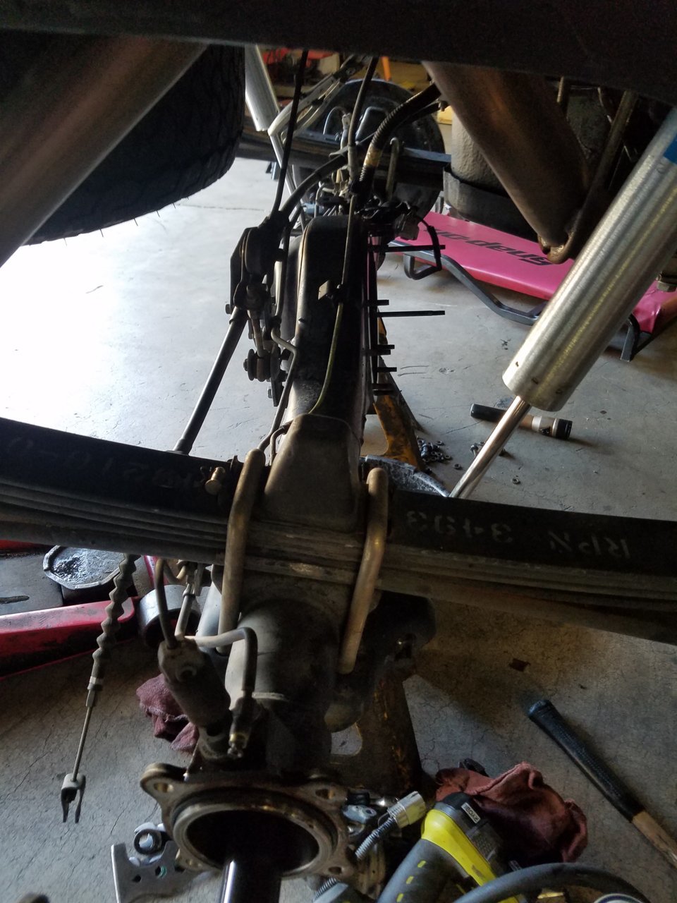

    Diff carrier bearing replacement? Does this require a full setup of lash and everything on this sort of axle?

    You'll be real close to the correct settings if you put everything back to it's same settings. Mine was right on after pinion and side bearing replacement. Put I small pin punch mark on the side carrier bearing adjusting nuts helps.

    Thank you sir. I am about to do R&P on my D44 for the SAS S10, so thought I'd get an idea how this one will compare. I will eventually be SASing the Tacoma, still haven't determined if I will stick with the Toyota rear axle or go with a D44. I already have a set of D44s available (sitting in my back yard) and am a big fan of using "standard" parts (that is to say, same axles across my builds).
    I need to learn more about the Toyota axles, first, before I make my decision. If the Toyota axle is demonstrably stronger than the D44, yes, it will stay- especially since the lug patterns already match.
