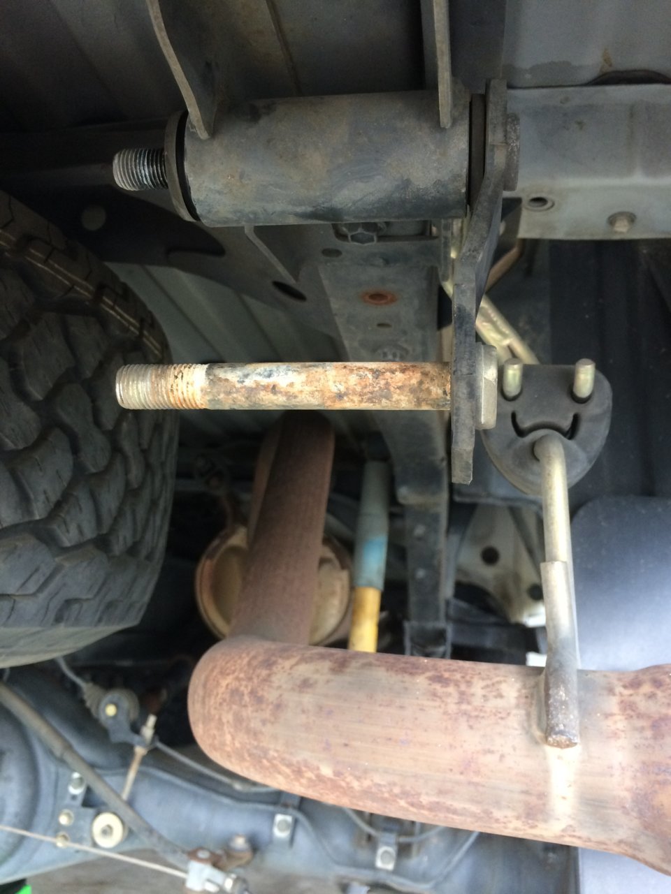

    Hit that bitch... Or cut it... The rust and shit is what's holding it in there.

    They’re press fit, have to hammer it straight out

    They're pressed in, I thought the daystar bolts we're just for the main eye in the front if the leaf pack

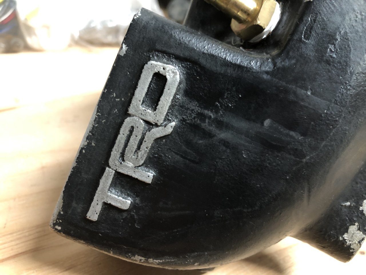

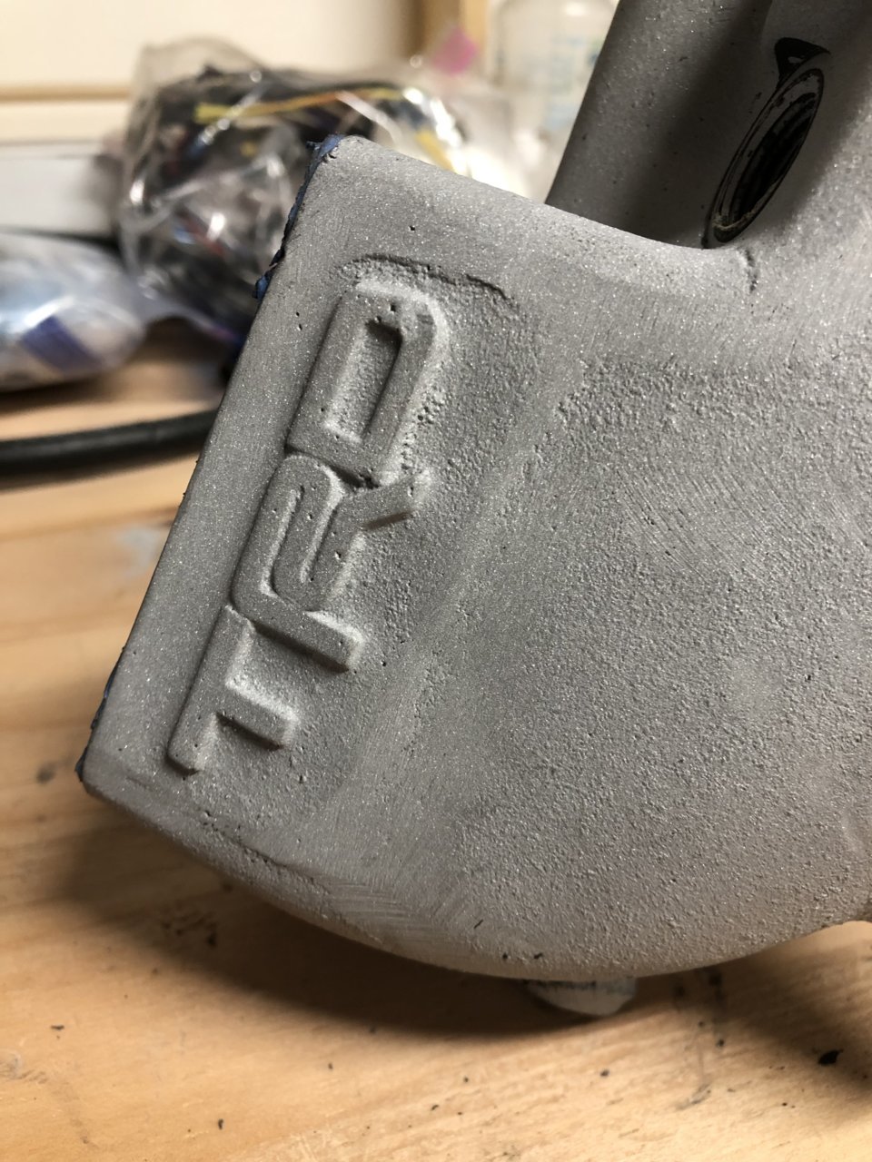

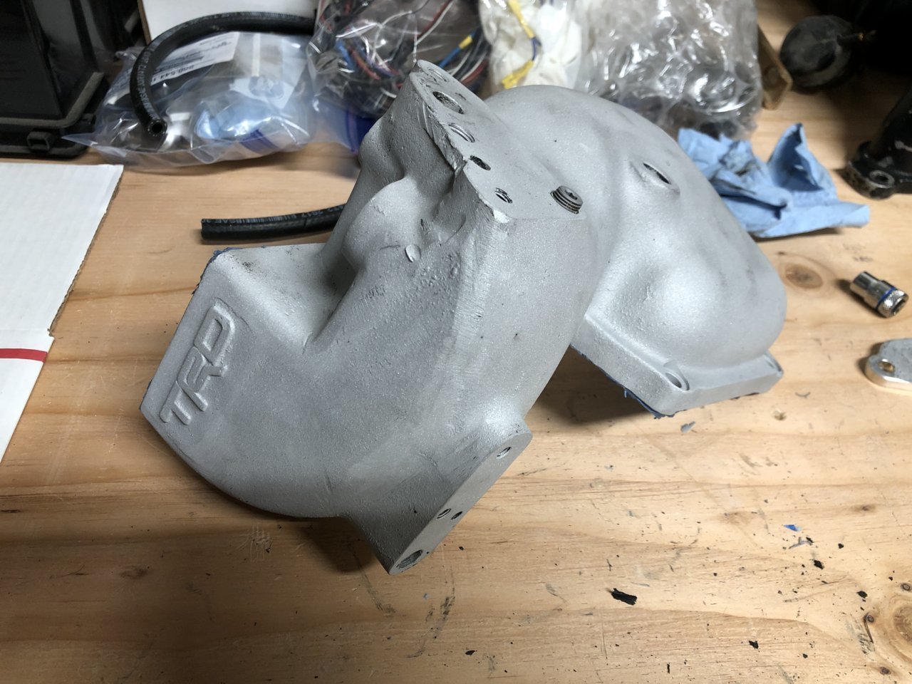

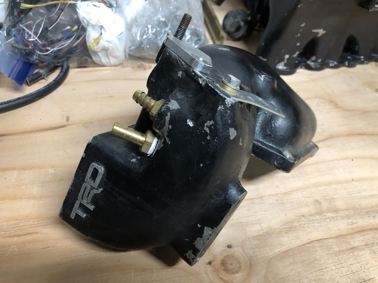

    Here’s round one of sandblasting, next up is the intake manifold.

    Newest mod for the truck, Alpine TRD I4 supercharger. Few things that need to be done before I can install it. Both EGR stud holes need to be welded shut and re-tapped, and the rotor casing side of the intake manifold needs to be machined flat.
    Going to get it jetwashed too, the inside is absolutely horrifying from the EGR residue. I'm hoping the meth injection will help combat the oil and sludge buildup.

    Technically yeah but I've used them in the rear for several months now and they work well. They're maybe 3 threads shorter than the stock bolt but I haven't had any problems. Didn't realize until recently that they make another kit for the rear shackles but the only difference must be the length of the bolt being slightly longer.

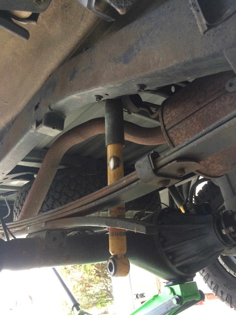

    Eon blue had them on the back too. Doing the same.
    Dumb question that I think I already know the answer to but these don’t come with instructions - military wrap to the front of the truck, not the back, correct? I ask because I’m not quite lining up I want to make sure it’s not on backwards before I go further.

    Military wrap always goes forward, 1st gen leafs are uneven too so that's a good hint
