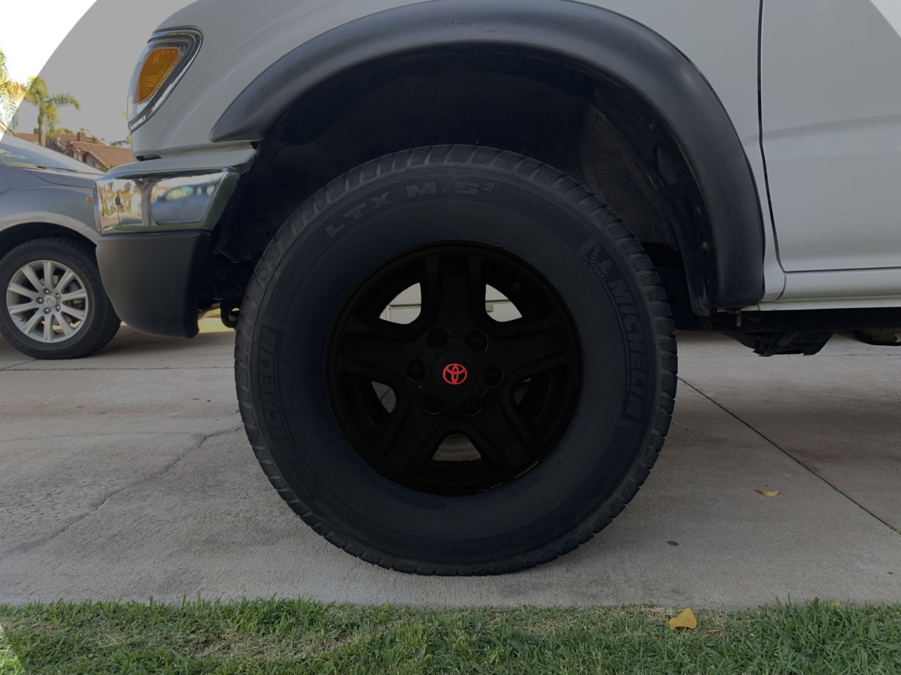

    Its probably my swingout that throws it off, but his truck is definitely wider than my 1st gen...its pretty square, but our trucks are close to the same height.

    I never even thought about it till now that its been brought up lol. Guess you could do a side by side measurement ha but yeah it looks almost the same length...

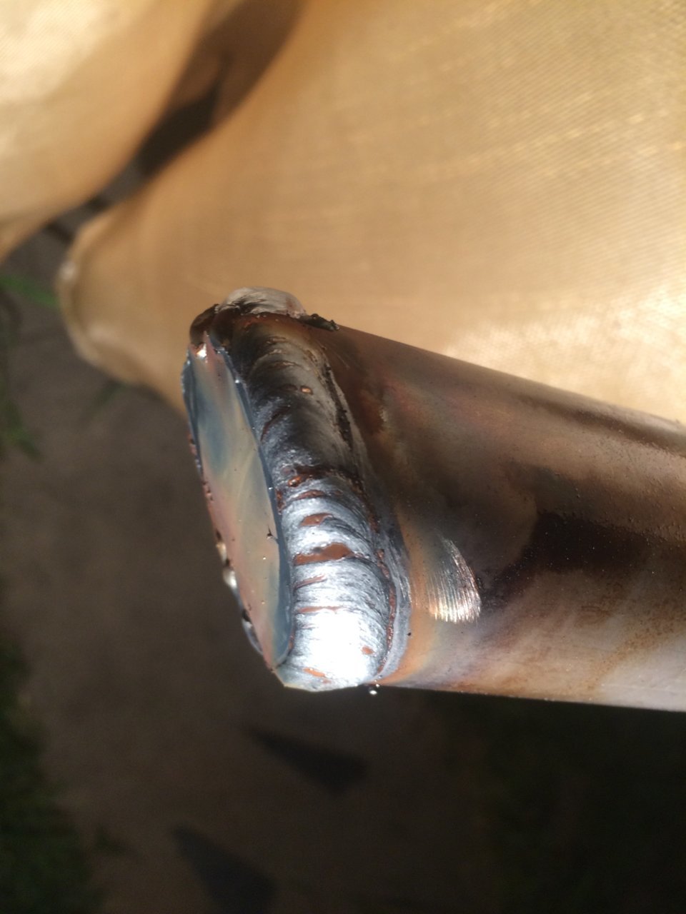

    Modified a Trail Gear rock defense bumper I got awhile back to just have a straight cross bar instead of a curve at the fenders - wouldn't work with my fenders.

    Looks like a handlebar mustache!

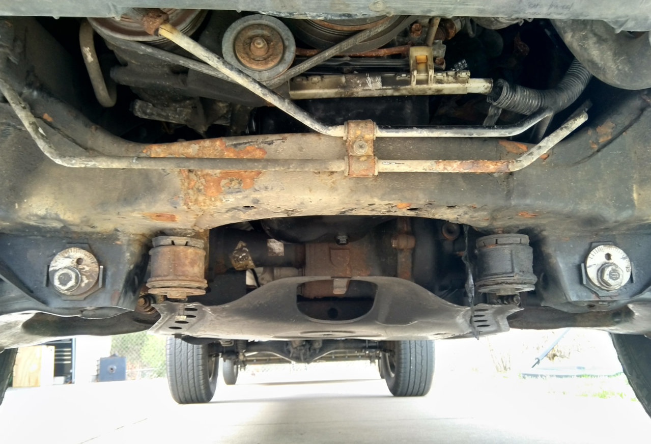

    I'm planning to install a new power steering hardline assembly to replace the old crusty ones. I've done some searching through the forums but haven't found any discussion of this job. Looks like you just unscrew the bottom support and disconnect all of the fittings. Is there anything else to it?

    Given how rusty everything is in that pic, the first step would be to douse everything in PB Blaster once a day for a week prior to trying the job.
    MAKE SURE to use a flare-nut wrench to break loose those fittings. Less chance of rounding them off. Once you get them broken loose and spinning easily, you can use a regular open-end.
    Likewise, use a flare-nut wrench to firmly attach the new lines.
    *Strongly recommend* an inline filter be placed in the *return* line (it will explode if it is put in the high-pressure side). This will keep your system nice and clean. Should also look into adding one to your transmission if it's an auto. I use these: https://www.magnefinefilters.com/ and these are quite a good alternative, as well: https://www.oreillyauto.com/detail/...8964/4836716/1997/toyota/tacoma?q=58964&pos=1 noting that the Oreilly link is for a 3/8" filter. If you need another size I can track it down for you, PM me. These things are highly recommended for any fluid-power system (Power steering and auto trans).
    Other than the above info (which FYI I have not done this job on a Toyota yet, but many times on Jeeps, Hondas, Fords, Chevys, Land Rovers, etc), yes, it is pretty straightforward. Do make sure to have the front wheels off the ground and engine off when you bleed the system after reinstall. Otherwise you will cavitate the pump (air bubbles explode in suspension in the fluid, as they are compressed against the pump vanes- and literally rip steel off the pump walls/vanes) and damage your brand new system.

    If that’s considered rusty my trucks totaled haha

    Everything that @burntkat said. Especially on adding the in-line filter. Magnafine would be a good choice, I run one on my truck.
    Note that there are 2 more line supports, one on the passenger side frame rail that is easily accessed and then the one that sits on top of the crossmember, close to the frame on the driver's side that is a bit of a bitch to get to.

    Install the new lines, then bleed it. Put the filter someplace protected yet easy to access- you'll want to replace it about once a year (honestly, probably ok to do every other year, but it is cheap insurance). Pay attention to the flow direction- these filters have a magnet as well as a filtration cartridge inside, and a bypass valve. If the filter gets too plugged up the bypass will actuate, so you don't burn up your system by plugging the return. If you install it backwards, the bypass will be slammed shut and you will burn up your pump.
    These filters work so well that I don't even bother replacing the stock transmission filter anymore once I have installed one and swapped out the interior filter after I purchase the vehicle. They are quick and easy to replace, and filter better than the trans filter. I install a drain pan with a drain bolt, and fluid/filter service is much more easy to do- so I do it more often.
    OB PS system- change the lines, then bleed it. You're going to lose a good portion of that old fluid when you swap the lines anyway (might as well just let it drain off into a bucket when you remove the line from the PS pump, depending on how nasty it is). So you will replace that with new fluid, and then the filter will screen out the crap in the old fluid. End result- you have much cleaner fluid. If you really wanted to go nuts you could do a fluid replacement along the lines of how Timmy (can't remember his actual nick, sorry!) does it. That would be a great idea if the fluid is really nasty. Otherwise, I'd just install the filter, top off and bleed it, and then drive. Know that you will be making your fluid cleaner as you drive, and don't worry about it.
