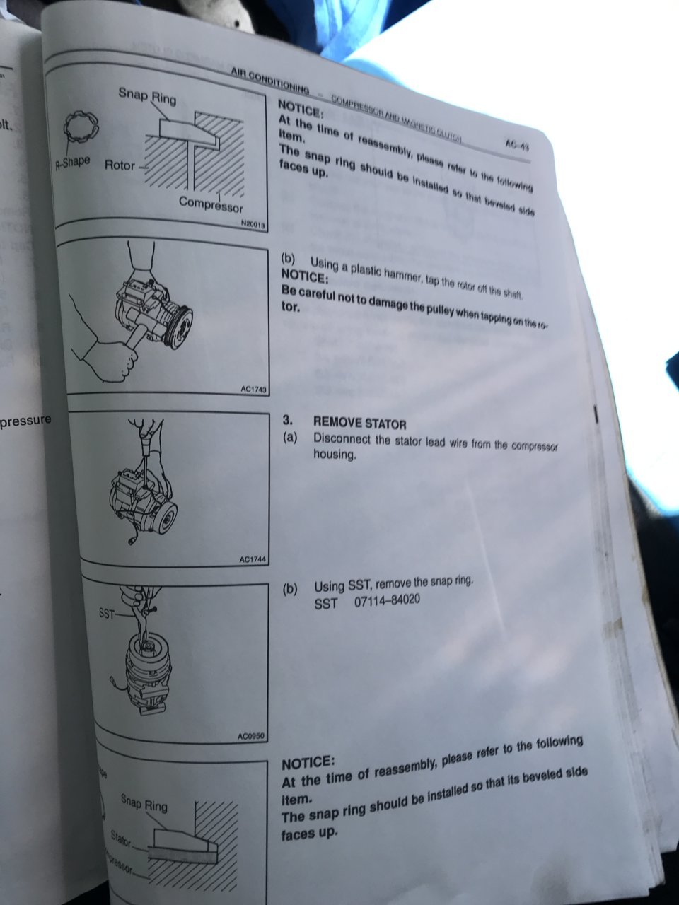

    So far I am finding the entire clutch assembly, like here: https://www.partsgeek.com/gbproducts/DC/8215-05330547.html?utm_source=google&utm_medium=ff&utm_content=DN&utm_campaign=PartsGeek+Google+Base&utm_term=1995-2004+Toyota+Tacoma+A/C+Clutch+GPD+4321399+95-04+Toyota+A/C+Clutch+1997+2002&fp=pp&gbm=a&utm_source=google&utm_medium=ff&utm_campaign=PartsGeek+Google+Base&gclid=Cj0KCQjw-tXlBRDWARIsAGYQAmd5bSRjgcLzS1vinMYIzCXzGWcpgQjWZ7kpgkFqADXd9Q-IaKFkjXAaAjt1EALw_wcB
    IIRC, the bearing alone was $50. So for $85, to get an entire assembly, might not be a bad idea...
    EDIT: so much for my memory... https://www.autozone.com/cooling-he...ech-a-c-clutch-and-components/107355_440948_0 $18 for the bearing.
    I am finding so much contradictory information, and indication that a bad bearing often scores the other clutch parts, that I'm just going to purchase the clutch assembly.

    Unbolting the compressor is the easy way. You don't need to disconnect the lines just the compressor so you can see what you're doing. Pretty straightforward once you can see what needs to be done. Get a good set of snap ring plyers.

    Once you are down to the snap ring and it's out, does the back half of the clutch come off easily? I am seeing some folks had trouble.

    I don't think I needed to pull that off to replace the bearing.

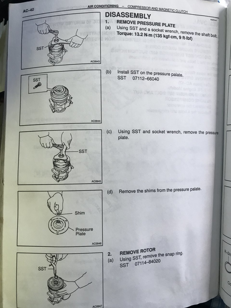

    I checked my FSM a little bit ago and this is all it says
    But you have to get the Freon vacuumed out first, so I may try and not do that. But for the time being I'm going to cut my AC belt and push this issue farther down the road
    Edit: It also says stuff about the clutch coil but if you're just replacing the bearing or the entire assembly you should be able to leave it on there

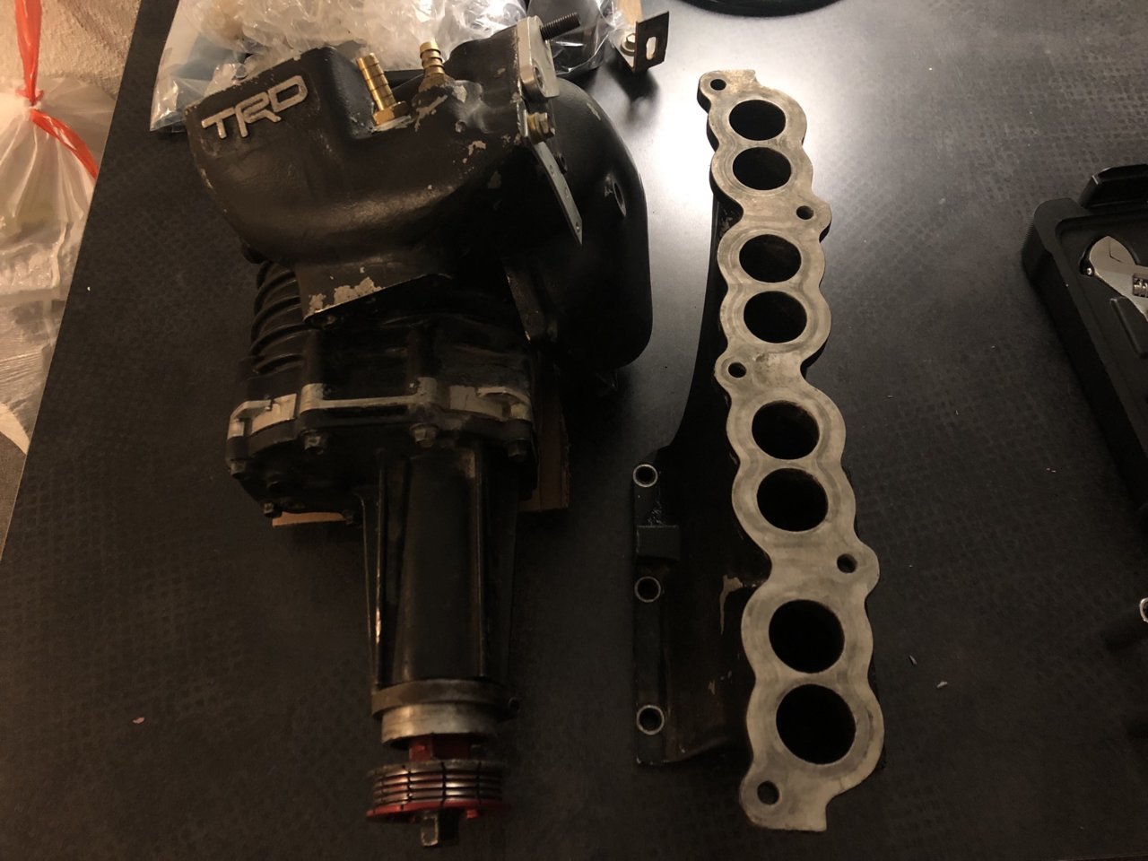

    It doesn't fit on my supercharger manifold which is strange. Holes don't line up and the hole for the EGR is too big.

    @se7enine
    Here is the gasket on my intake manifold. I believe I need the EGR valve to intake manifold gasket and I was given the EGR tube gasket.
    As you can see the EGR hole is too big, and the stud holes don’t line up.

    Bringing the intake manifold portion adjacent to the throttle body to a machine shop today, have to get both EGR holes welded and retapped. I’m asking about the gasket because I want to give one to them as a template.
