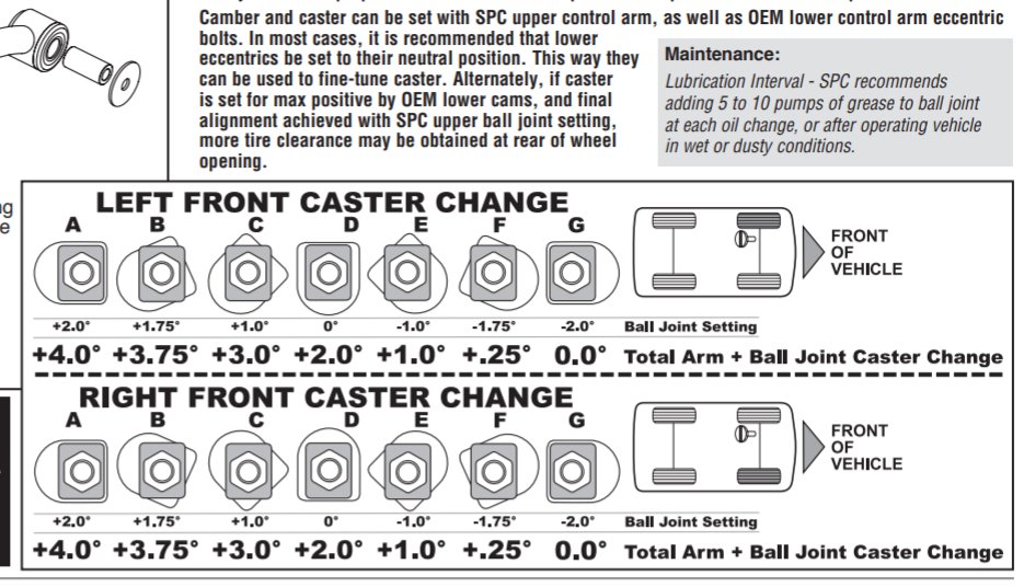

    Not sure where yours are currently set, going to guess position "G" since you mentioned 0 degrees of Caster. Then again, the ball joint @ 0 degrees would add +2 degrees of Caster. Anyway, when I installed mine, I set them at position "D".
    Took it into the alignment shop and had them put me at these numbers (my UCAs are still set to position "D") -
    Edit: not saying this is the best route or the correct route - just putting out there where I'm at in terms of numbers

    D = 0° of ball joint setting (see the little 0° under)
    Edit *** That's where mine are set. 0° of ball joint setti g is what I mistakenly called caster.

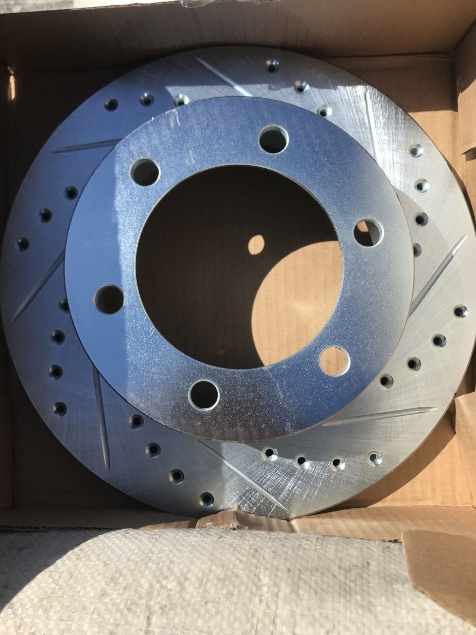

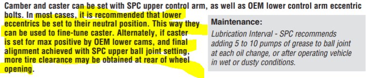

    SPC mentions this in their pdf as well -
    Reh5108[QUOTED] likes this.

    Ok... so tell the alignment tech to peg out my LCA caster and fine tune at the UCAs.
    I'll do that and then cut again if needed :sawzall:
