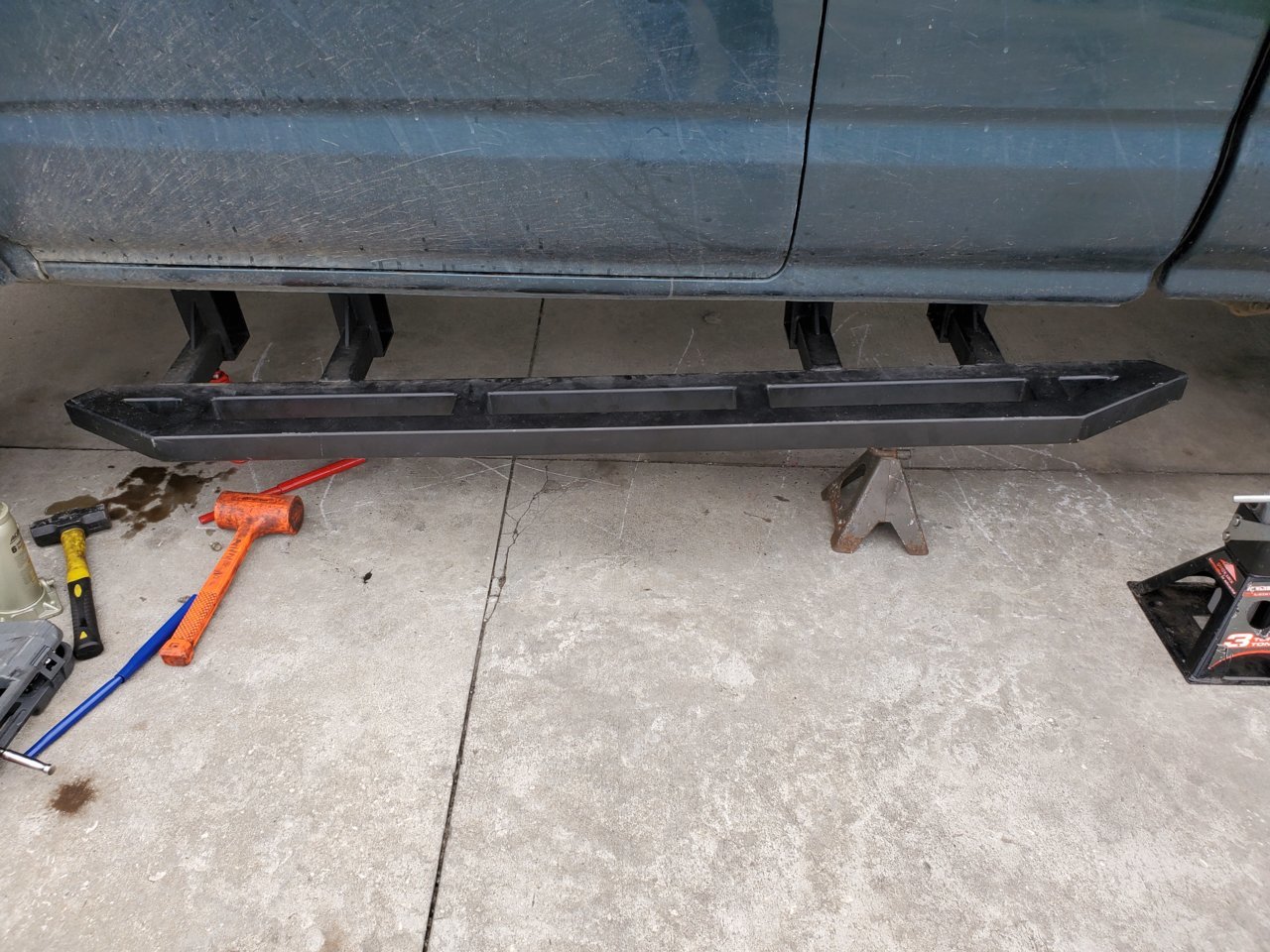

    What brand are these?
    I have same looking demelo sliders and dont remember having any fitment issues

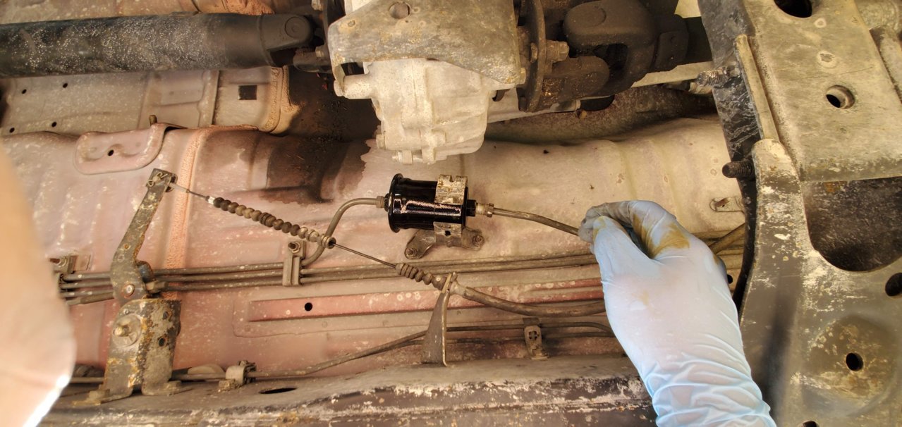

    Replaced my fuel filter. The old one looks like it had a date from 2013.

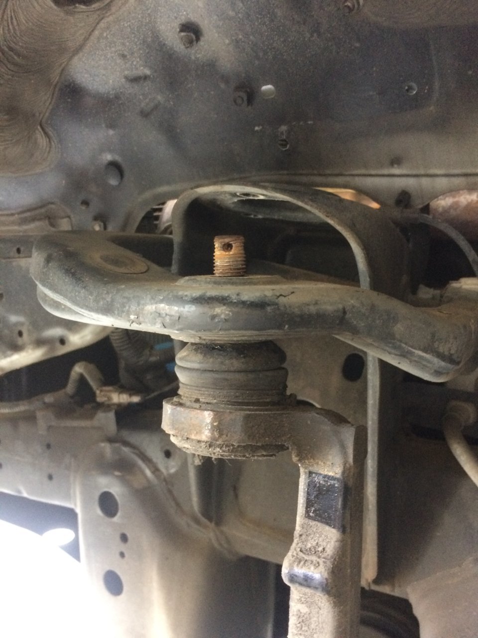

    How do I separate this ball joint from the stock UCA? BFH doesn’t seem to be working.

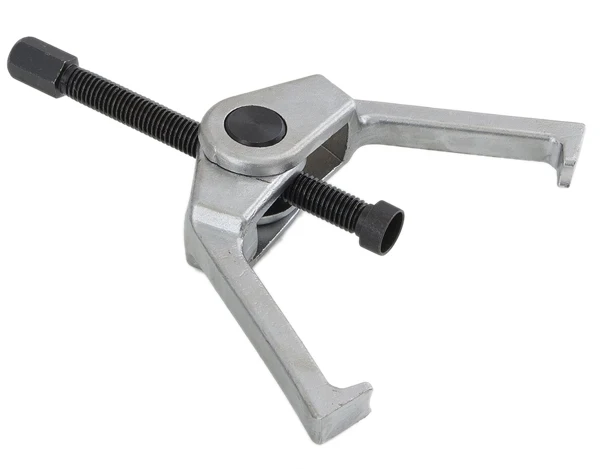

    Pitman arm puller or a pickle fork should be good. If not you can always cut it since you're getting new upper ball joints
    Edit:
    Or whatever this thing is. I've used this so many times it's probably paid for itself in frustration savings

    @SwampYota - put the castlenut back on - upside down is fine also, give it a turn or two just to get it back onto the threads. Use the puller. When it pops, nothing will go flying loose :plane:
    good practice for any of them (UBJ, LBJ, Outer Ties)

    I’ve got the jack under the LCA just snug to hopefully prevent that too. Going to pick up a tool.
