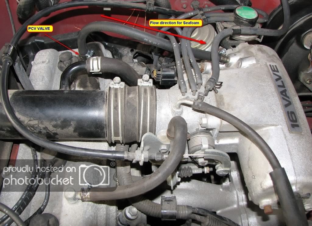

    Ordering up parts for my top end job, someone mentioned replacing the hoses are a good idea. Do I need to replace all of the hoses pictures included the ones for the throttle body, or just the problematic one for the PCV?

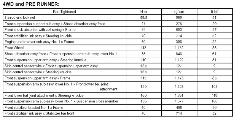

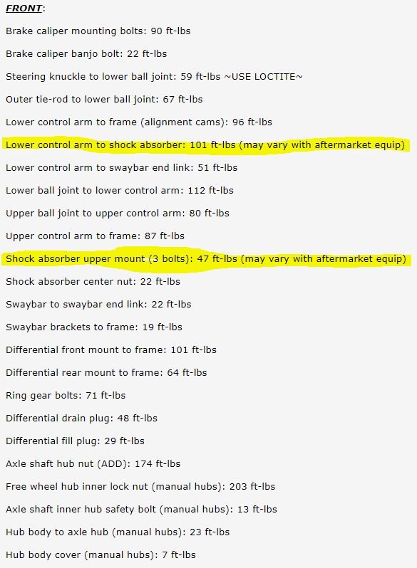

    Can anyone tell me factory torque specs on the front coilovers? Bottom bolt and top 3? King says torque to factory specs.

    Bottom is 101, top is good an tight without being tight enough to strip. I do those by feel for safety
    SwampYota[QUOTED] likes this.

    47 ft/lbs for the top 3 bolts and 101 ft/lbs for the lower bolt, iirc. Someone correct me if I'm wrong
    edited for correct numbers

    61 is very light for an M12 fine fastener. Mine I pulled from a 2000 FSM, maybe his screenshot is from a 2nd gen or something

    cool thanks, saved that link to my phone...I'm always fumbling around the internet in the middle of working on my truck trying to locate a good source for torque specs lol, this will come in handy

    Here's a little baby cheat sheet I keep around just for working on stuff away from the FSM
    also a good link to an even bigger one that is helpful
