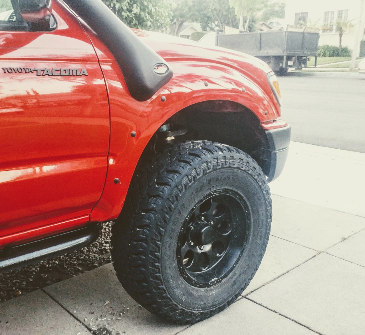

    What coils do you have? Looks like a good bit of preload you have going on. May want to drop it a bit and it’ll probably ride a tad better. Plus CV angles would look better

    23” from center of hub to bottom of fender is ideal. That’s 2” over stock.
