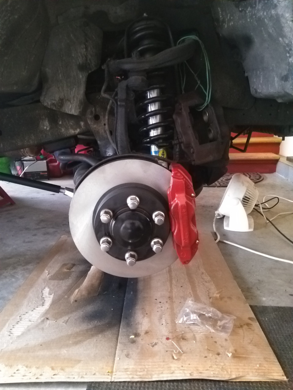

    Started on the Tundra brake upgrade last night, making good progress today. Had to use a propane torch to bust the 17mm caliper bolts loose, and getting the old rotors off was a pain, but I'm in the home stretch now. Used turbodb's parts list and instructions, and painted the Napa 13WL's red. Had to do a lot more cutting and bending of the dust shield than I anticipated. Now I'm just waiting on the UPS man to deliver some Wheeler's brake lines..

    Looks good, I had to absolutely mangle my dust shield to fit. I found tin snips are very handy

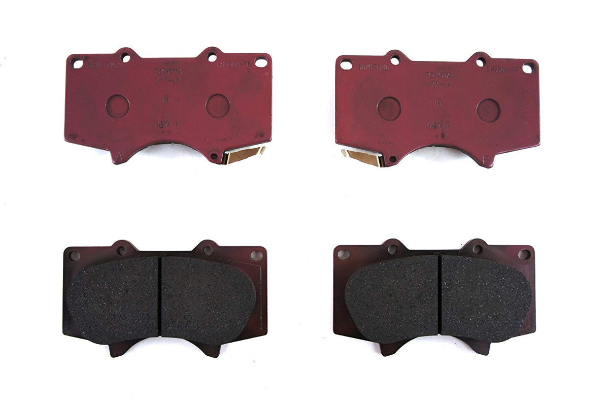

    On the OEM Tundra pads, two of the pads have metal clips on the inner part of the pad (the upper two in this product pic). Are these the inner pads or outer pads?

    You can put the metal clips on either the inside or outside. I chose the outside so you can do a quick (easier) visual inspection of pad wear by looking through the spokes of the wheels, rather than having to take the wheels off.
