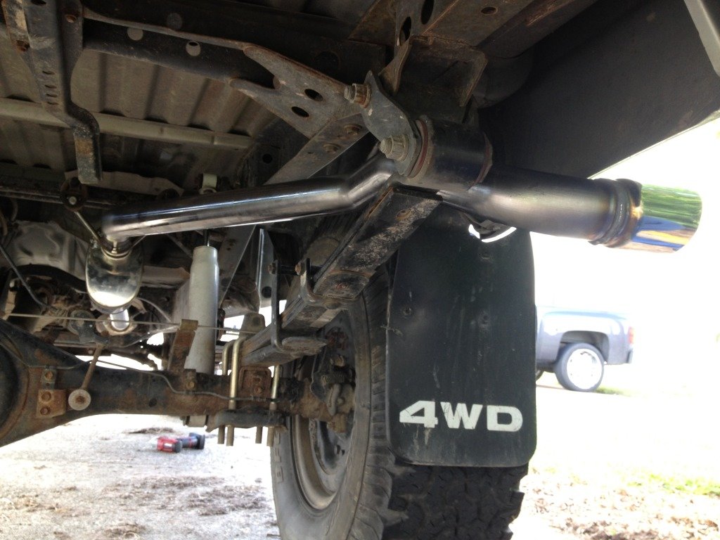

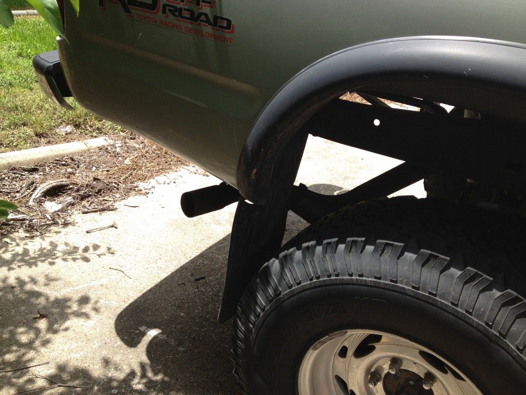

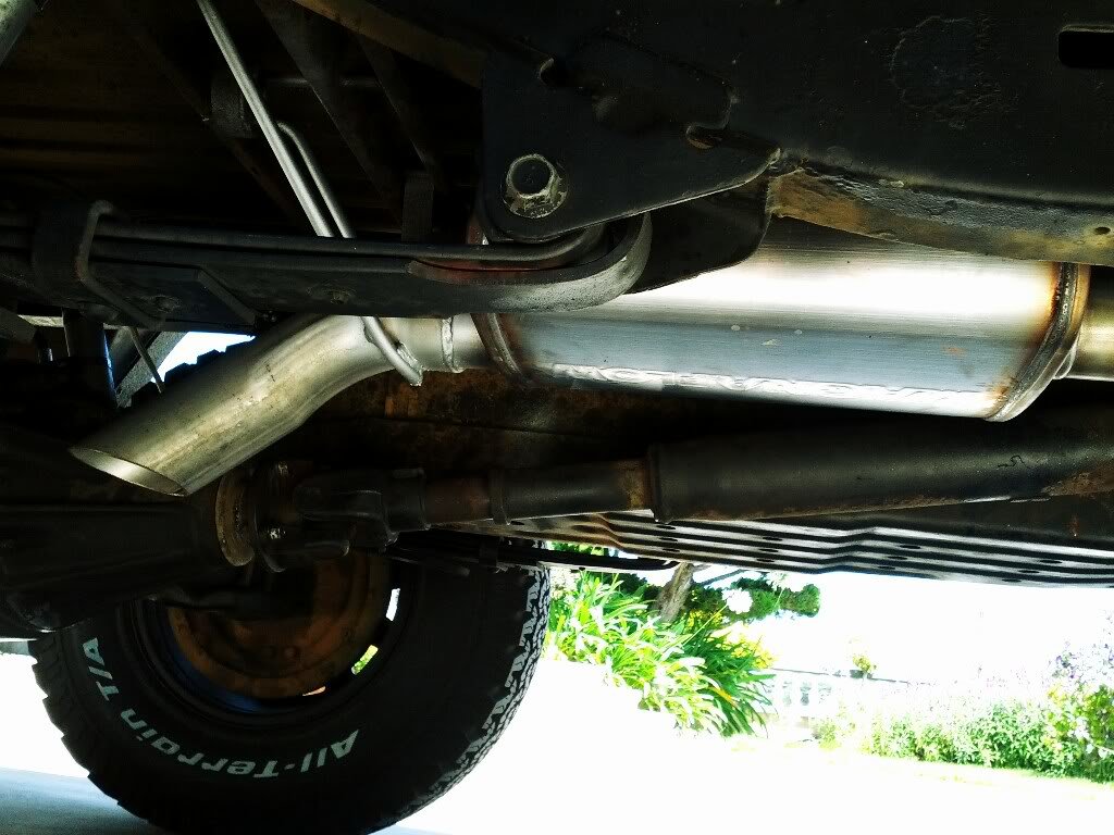

    Sounds good, but man does that tip look low.
    Mine is probably half the size of that and I already put a fat ass dent in it. You might want to look into getting a mandrel bent 90 elbow. Takes up less real estate and no kinks in the bend.

    Thx breddeh. I think it's the angle of the picture. The end of the tip actually hovers right above the top of the leaf springs. The kink is the creation of my muffler dude lol....he actually used a 3" pipe for the tip so he could maintain the true 2.5" diameter on the outlet side.

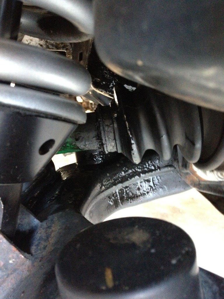

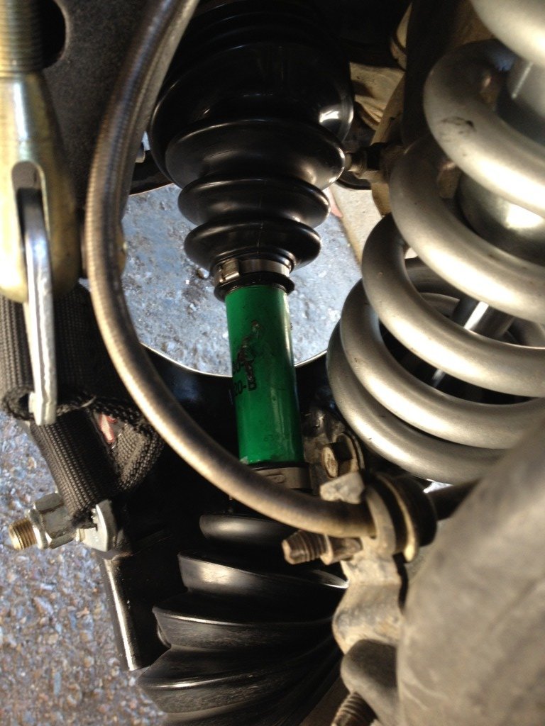

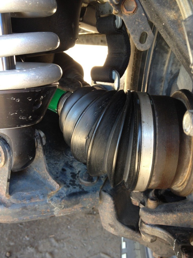

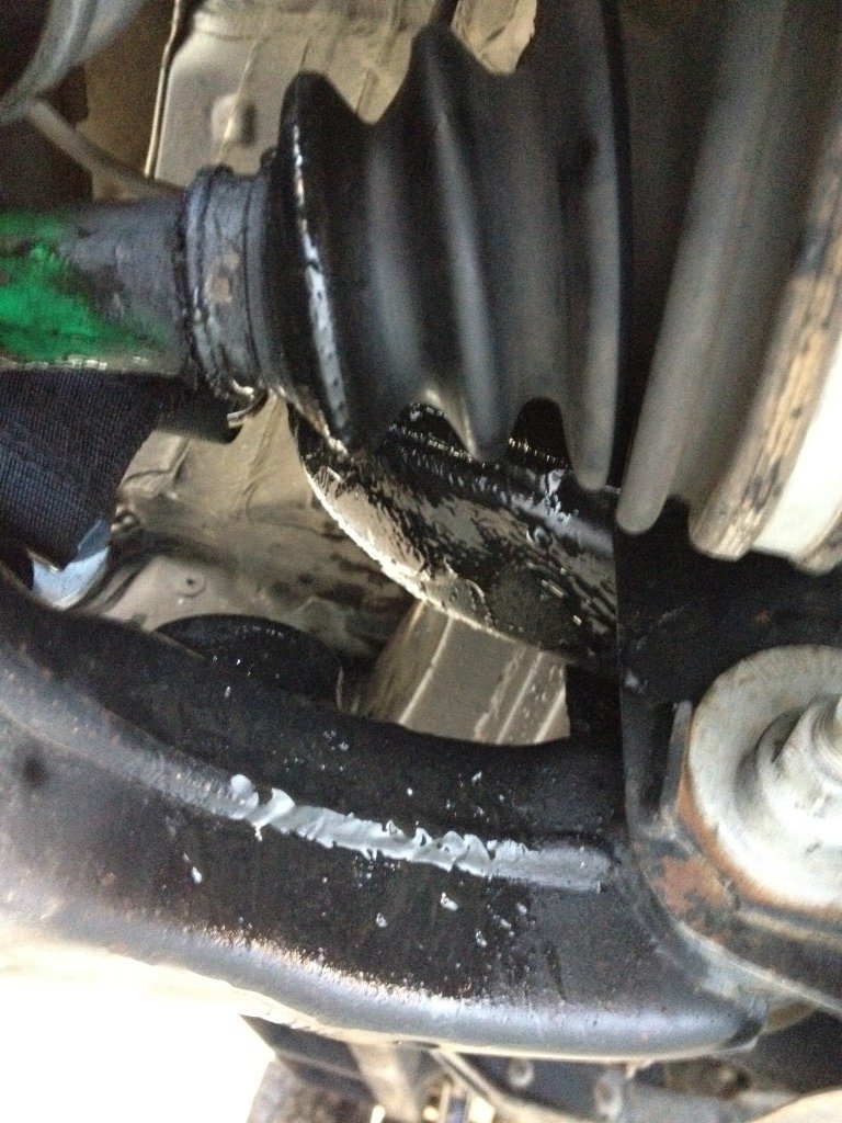

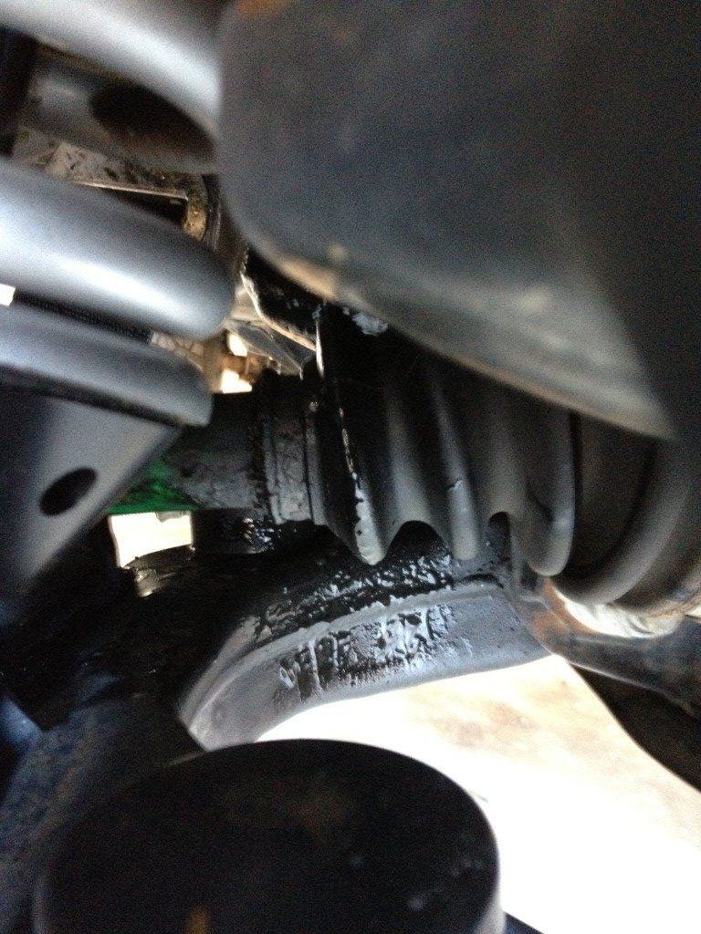

    The Truck Shop Replaced all 4 boots on my front CV's.
    Old
    New

    Good job! How long did the job take you?

    ...And what kind of boots did you go with?

    BTW, why didn't you go with 930 boots?

    I was Told OEM boots were used.

    Ya you should be fine without it for a while. I ram 4" of lift on stock hose. However I never did any serious wheeling
    Looks good man.
    T,e for the boot slide mod to prevent that from happening again!

    I will look it up.

    Ya should be a sticky. Helped mine a lot. Still tore OME in the roll over but still worth it I think

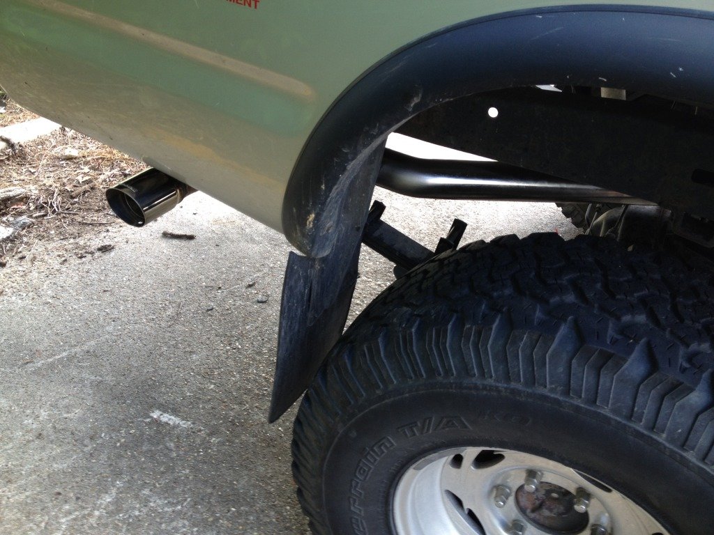

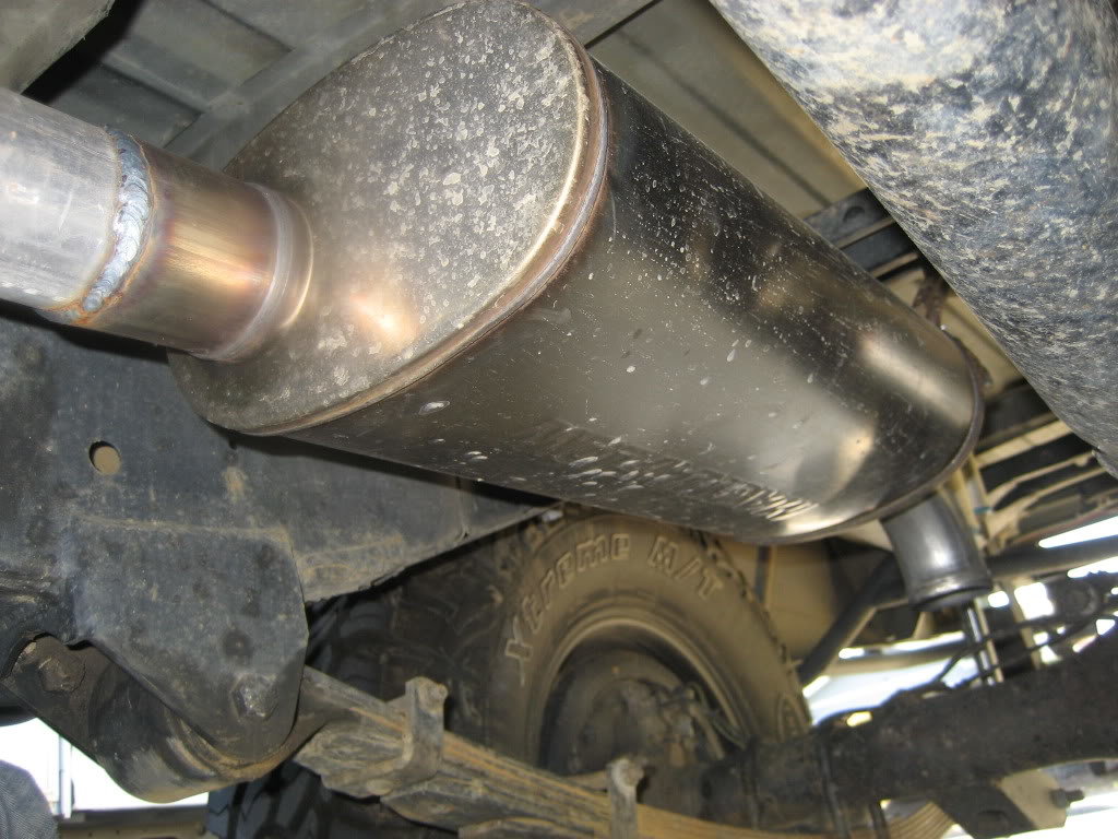

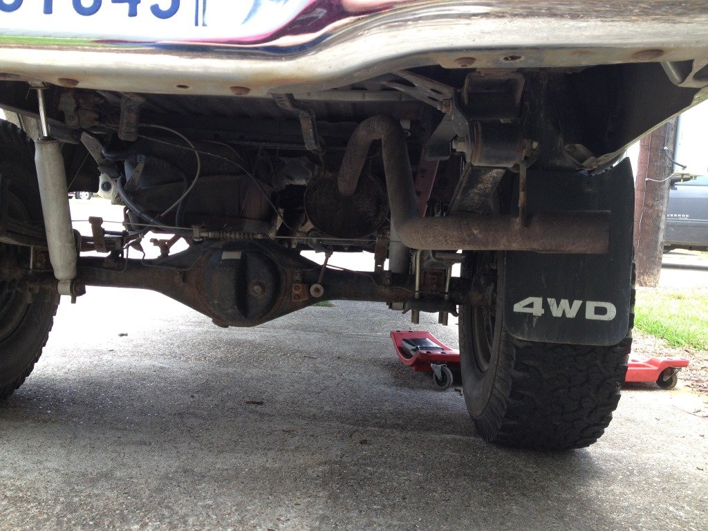

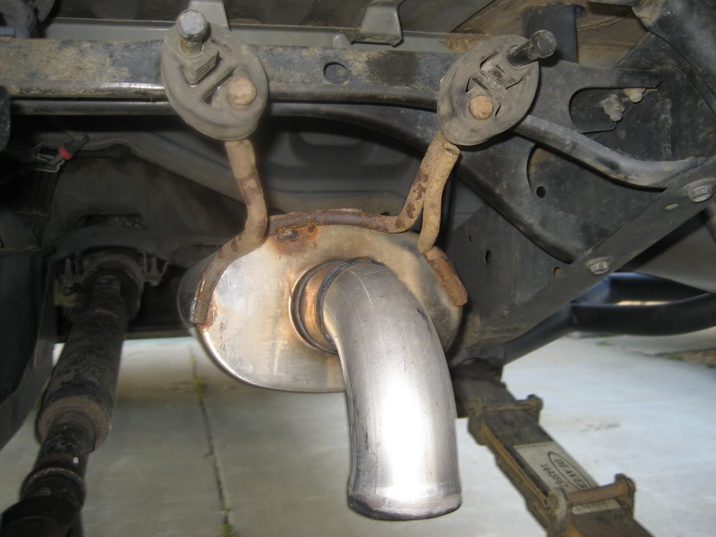

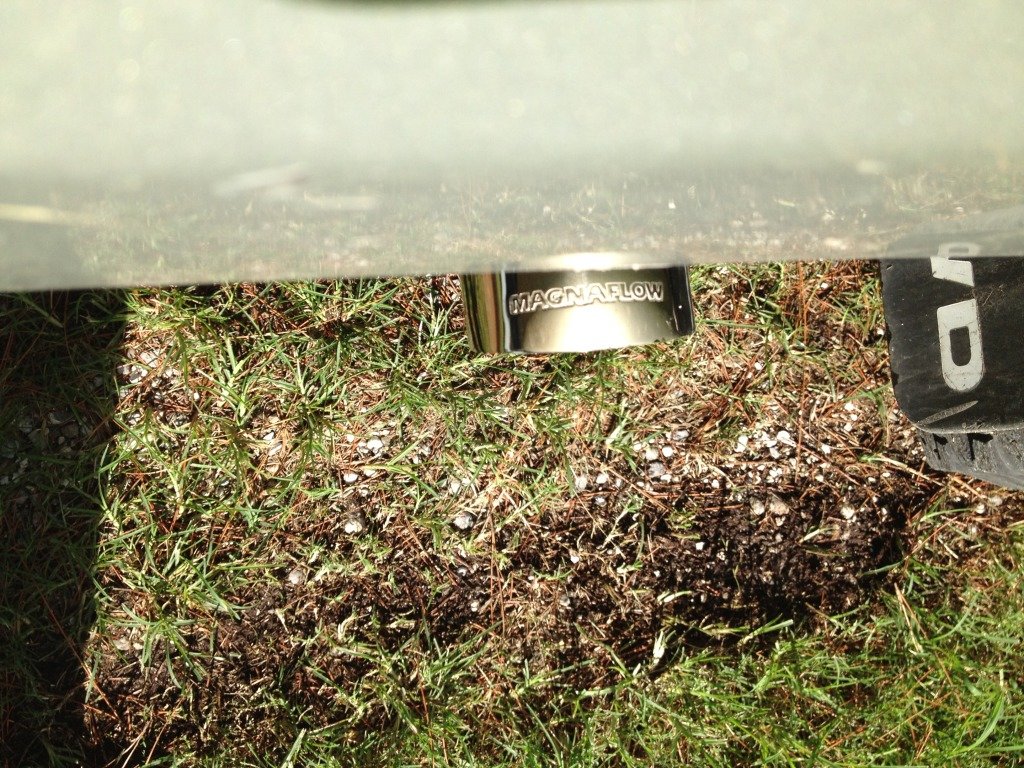

    Installed my new magnaflow 2.5" cat-back exhaust!!
    before:
    after:
    i like how they tucked the tail pipe up higher to the body, and i love the sound!!
