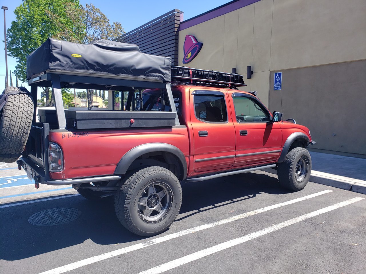

    Washed her up
    Waxed her
    Re-installed my freshly painted fender flares
    ... and headed for some tacos.

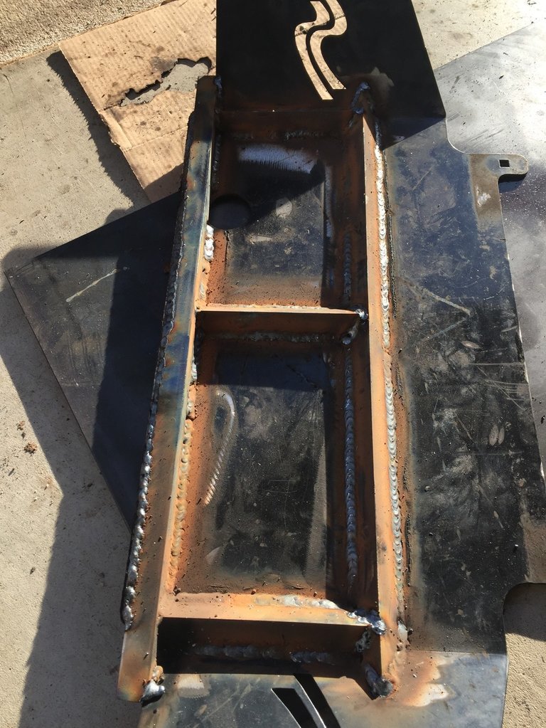

    Just realized we have the same Skidrow t-case skid, mines held up well for the last few years. It did take a really hard hit once that bent it up into the tcase and made all kinds of noise, had to get it pressed back into shape. But it was a really hard hit. Definitely did it's job in saving my tcase

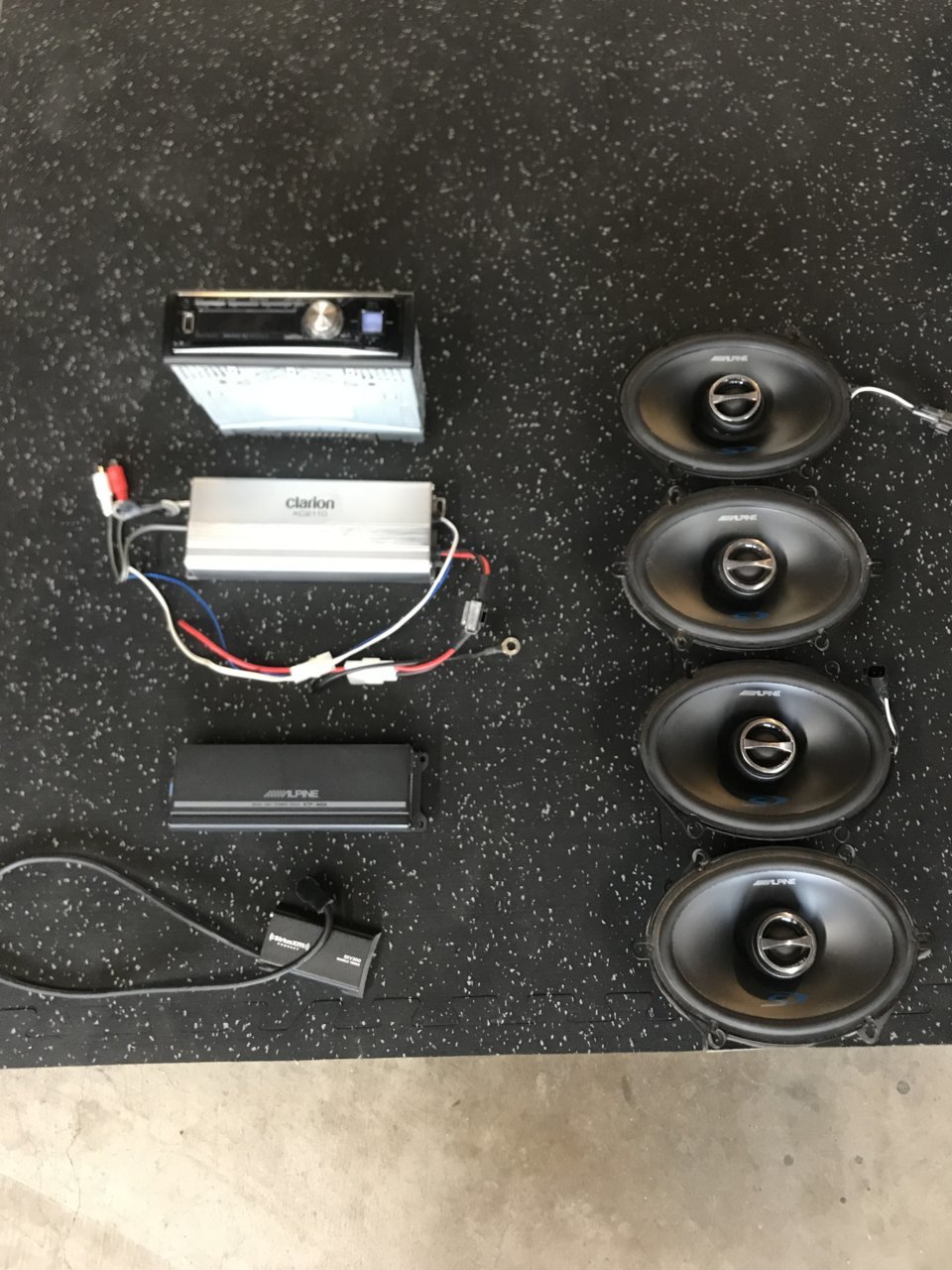

    Putting together some stuff for my Taco. Cant wait to get it installed. 95E0E0AC-A278-4FB9-A1B0-5D7B2BB7157E.jpg

    Those thin package amps are nice!

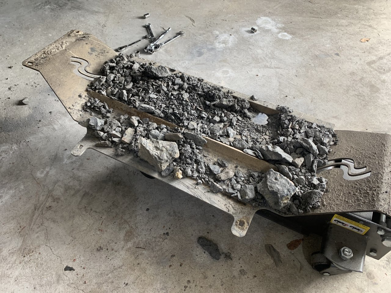

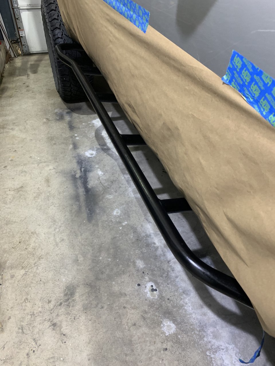

    Yes, they actually have been welded on twice already on my truck, and 3 times in their life total. :rofl:
    I only put half effort into the sliders since they get fucked easily. Basically wash the truck, spray the sliders with phospohric prep and etch to convert the surface rust, wash it off to stop the acidic process, mask and paint with VHT chassis black. Prep time in total is like an hour maybe.
    I had the same issue. I took a hard hit and the skid was contacting the t-case. After I bent it back into place I beefed the fuck out of it.
    I basically boxed the t-case in. And even with this, I need to take a sledge to the boxed in portion by the t-case because I have a bump right at the t-case spot.

    Nice, that explains the rock collection though lol

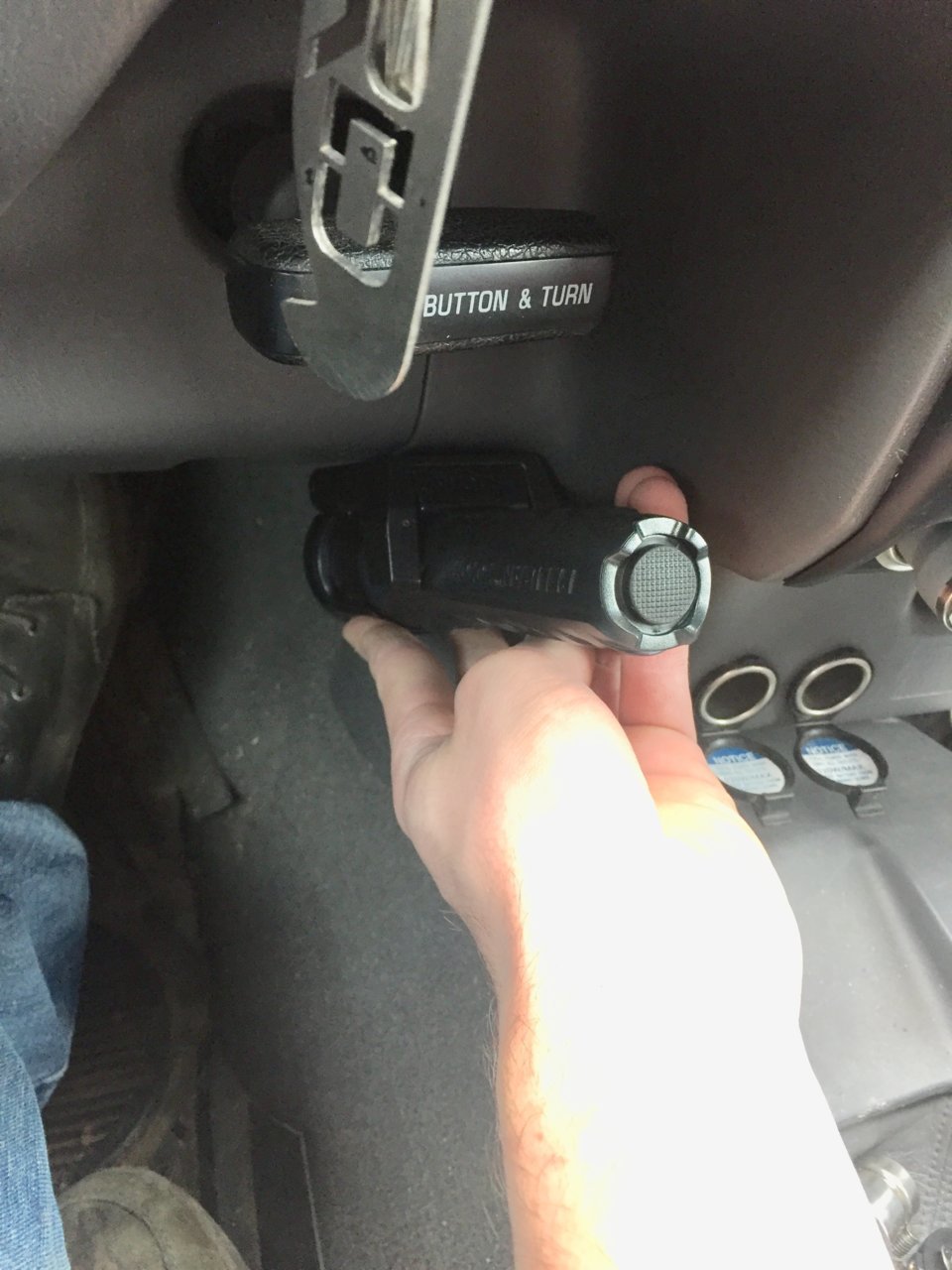

    Where are you guys putting flashlight holders/chargers?
    #tactical
    Annoying or nah?
