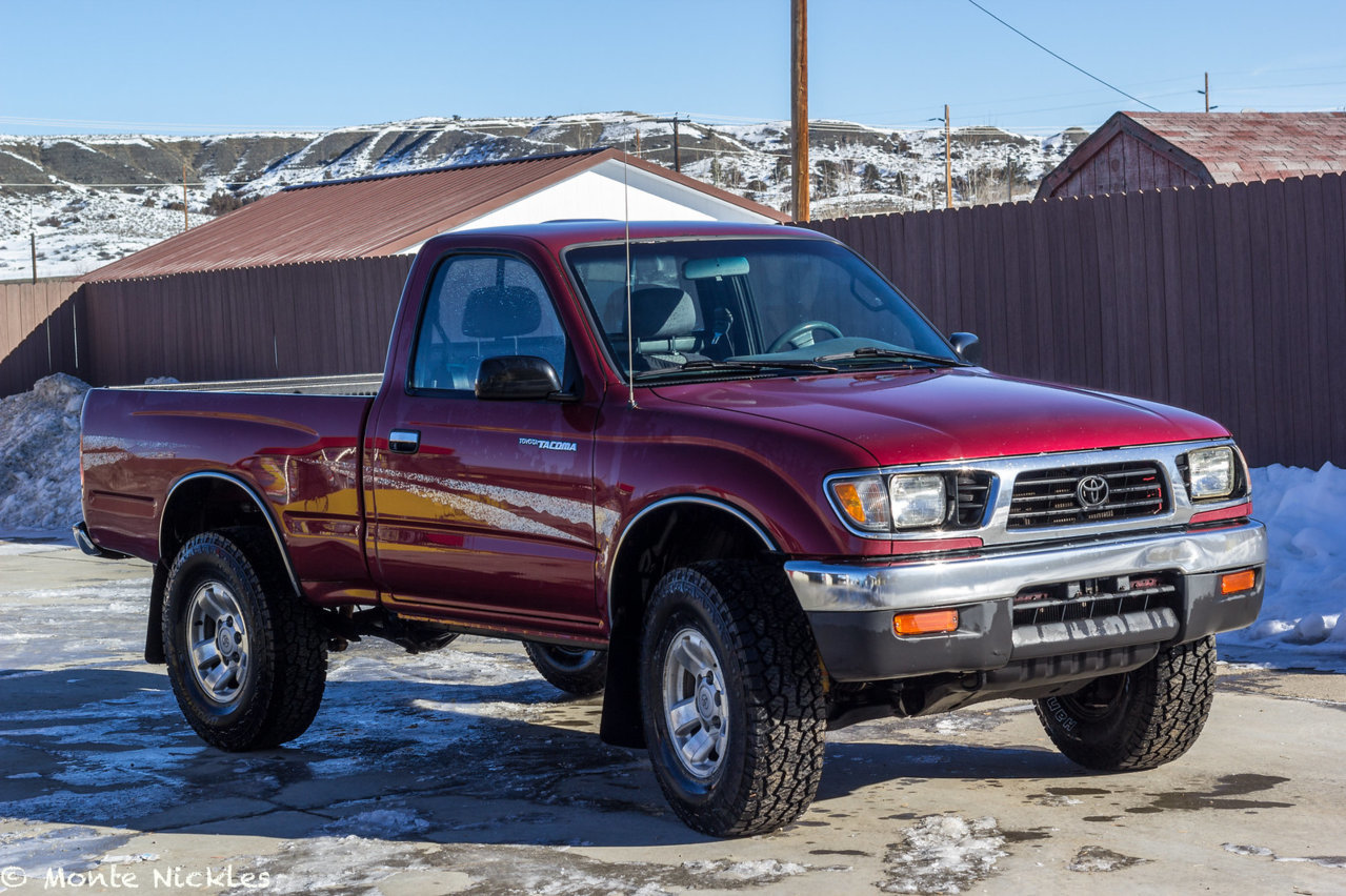

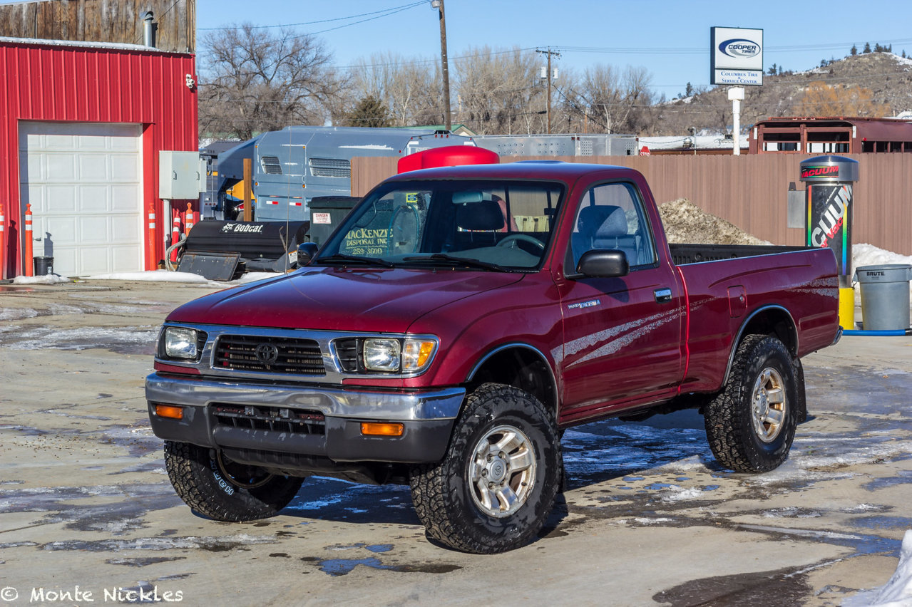

    If you ever swap Frank over to a double cab, please, please, please swap the front end as well!
    A '96 grill on a double cab would be the tits.

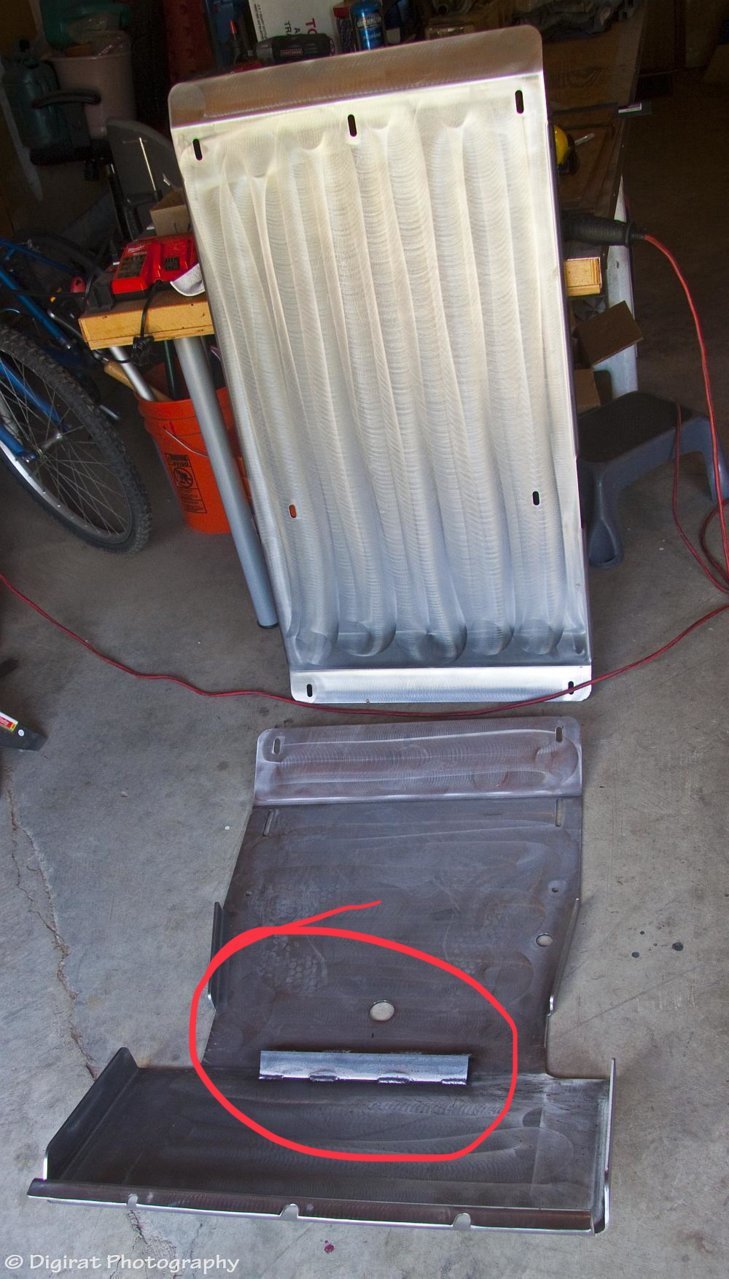

    Reinforcing the front bend in the skid plate is the main weak point, since it's the first part of the skid to hit anything and starts to flatten out after a while. There is room to add additional bracing around the differential and in front of the radiator, but at some point you're just adding a lot more weight without a huge benefit. Skid plates are somewhat disposable armor, they should be allowed to deform to absorb the energy of big impacts and then be replaced after a while.
    We also trimmed the front lip and opened the slotted holes to make it work with @Digiratus 's Elite bumper.

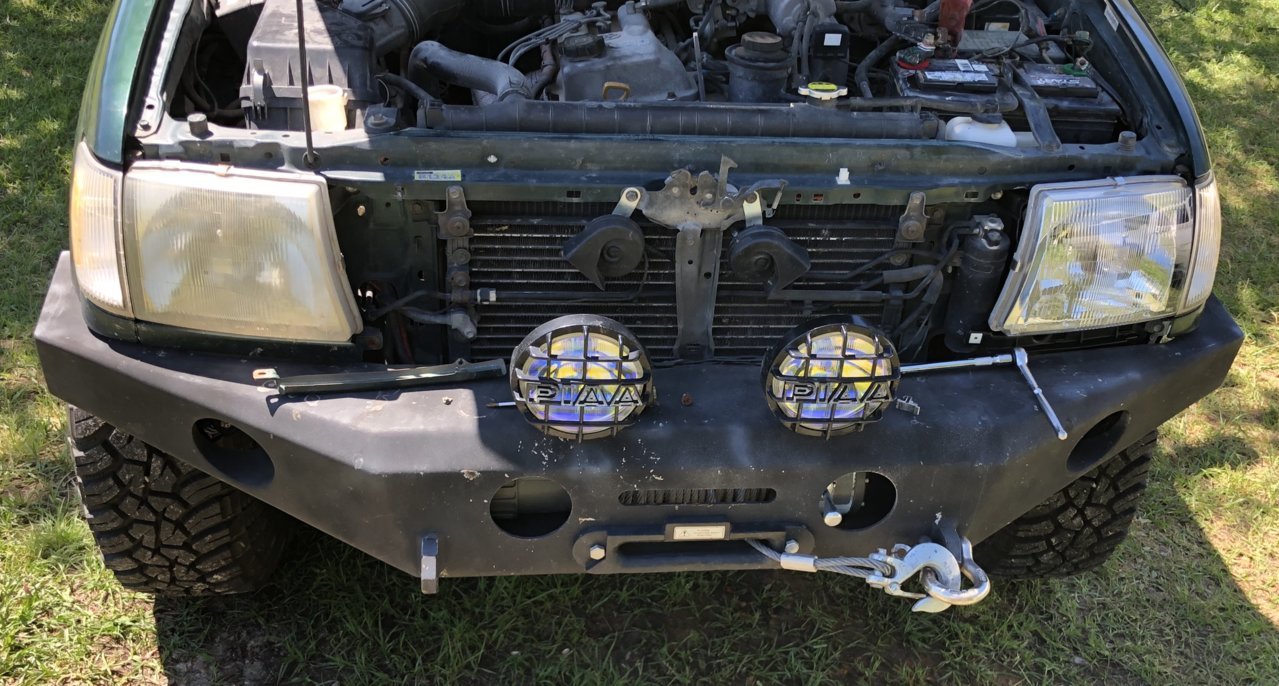

    Weld on sliders, fiberglass shell, 12k winch in an Elite Offroad bumper, front Aussie Lunchbox
    Went with replacement headlights. Nothing fancy for me. Just don’t wanna die at nighttime.

    Yes that is also the plan. Just have to swap the core support and hood which is fine with me since I'm running fiberglass fender anyways

    I can only speak about my own experiences.
    This is my 2nd set of the BB skids. The 1st set went 9 wheeling seasons. They have saved my bacon so many times. But as Dan mentioned, over time the front bend flattened out which effected the mounting locations. Rather than futzing with the old set any longer I just replaced them.

    What did you do with the damaged 1st set?
