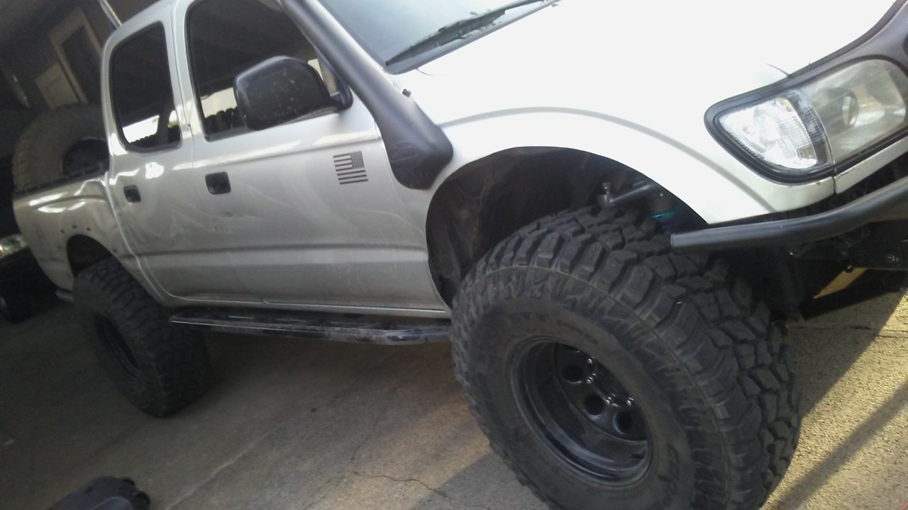

    Think a grinder could do that job? :sawzall:
  6. Apr 29, 2019 at 6:46 AM
    Blackdawg
    Blackdawg Dr. Frankenstein
    Dec 31, 2010
    #48500
    81,607
    Monte
    Wyoming/St. Louis
    The Trifecta of Taco's
    Yeah and a welder. You won't want to leave it open.
    Why did you cut so much out?

    Oh shit. I didnt know it was hollow.
    I used the skateboard tire method. Took 1 inch all around. I was hammering down and bent about 3/4 of my passenger fender. So time to cut

    Shit if that thing was solid round bar, you'd never be able to pick it up haha
    Cool, seems like more to me that 1'' but idk.

    I was thinking of cutting the front and back this week. What did you use to cut it? Pretty straightforward?
