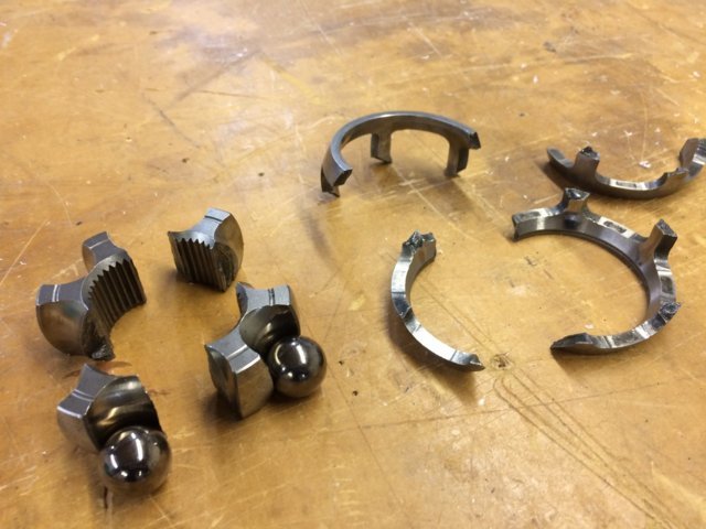

    Funny because I tore down one I had that was clicking for a rebuild. It ended up being the needle bearings in the tulip but the bearing cage looked fine :notsure:
    Is the clicking at crawl speeds? If so then it might be the bearing cage, but I've never seen them blow on a first gen yet.

    Yeah the clicking is happening at crawl speeds. I put it in 4lo to make a tight 3 point turn on a steep dirt hill and it clicked so loud at one point I was afraid it snapped (it didn't).
    I've had one CV fail and it blew apart on the inner tulip but it never clicked like this before hand. I'm hoping if I lower the ride height a bit it'll be okay, unless the clicking is an indication that damage is already done

    That makes sense too.
    Odd his boots are fine and its doing that though.

    Yeah clicking that loud at crawl speeds sounds more akin to what @Blackdawg said. The awesome part about rebuilding CV's yourself is you can piece a couple together. I always save my blown ones for parts. And when you do have one develop an issue like this, when you take it apart and see what's up you can equate certain specific noises to specific issues.

    I’ve only ever blown up one CV, and it was the bearing cage that let go

    Mine also exploded at the bearing cage. Was an ORielly deal, so no great loss. Tossed it out and have been rebooting OEM ones from junkyards as spares

    Bearing cage is the outer by the wheels, the inner is the tulip
