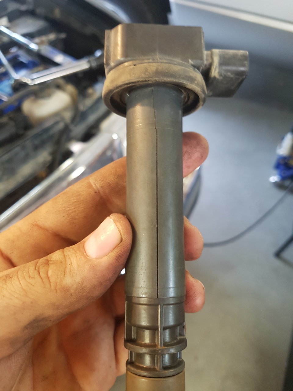

    New plugs, new vacuum hoses, and soon at least one new coil pack.

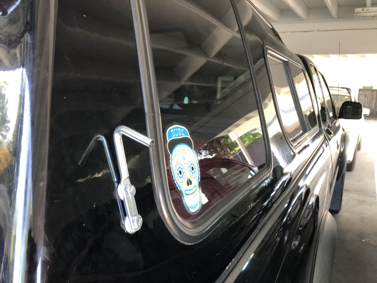

    Gonna put Thule and Yakima out of business with my new state-of-the-art campershell rack system

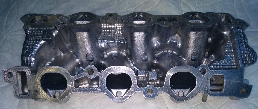

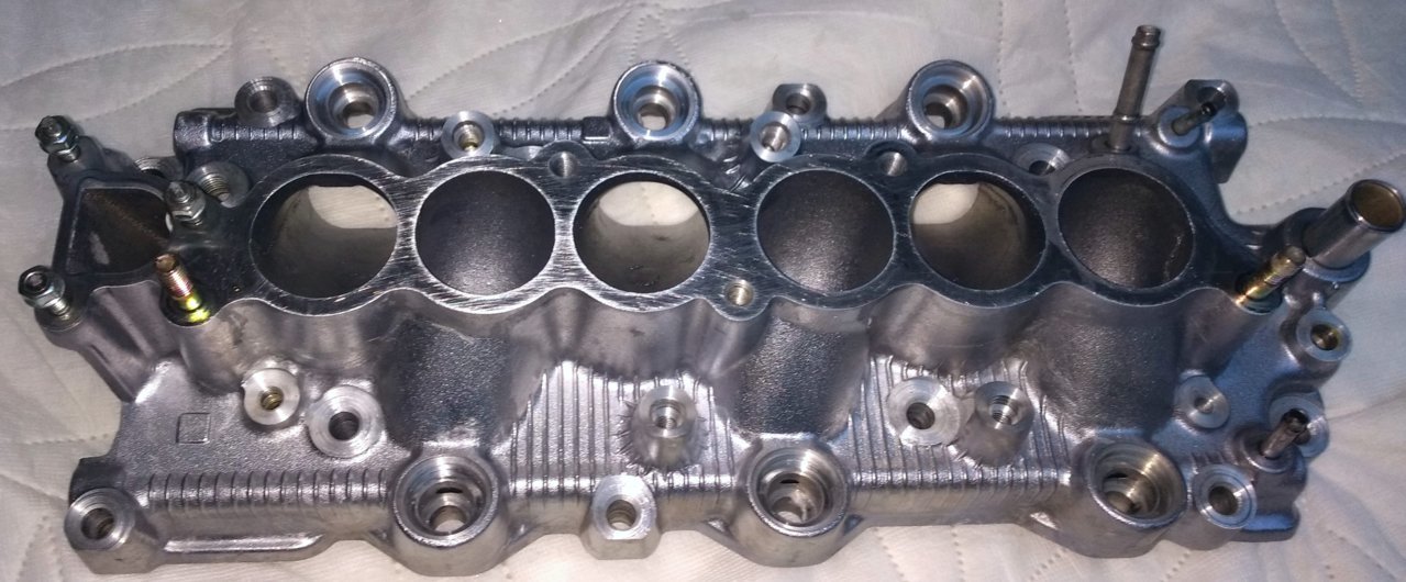

    One last post for today. Tonight I finished prepping the lower intake manifold for reinstallation. On to work on the uppers tomorrow.

    damn you got that thing clean
