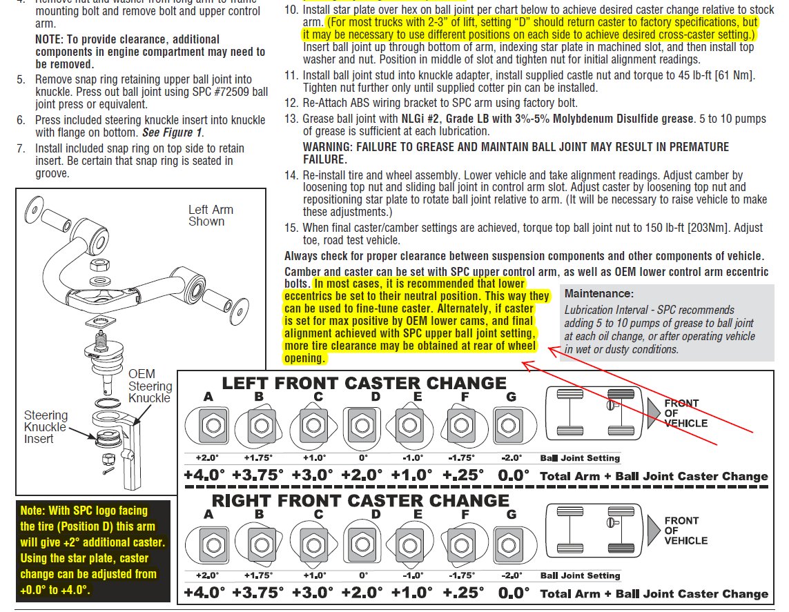

    Since my lower OEM cams are supposedly 'maxed out' according to the alignment shop, and from what I've read on here since yesterday, it sounds like I need to adjust the SPCs to the F or G setting to gain more clearance behind the wheel rather than what I was originally going to do ( A or B setting), since it sounds like the A or B setting will actually move the wheel closer to the firewall which is the opposite of what I want.

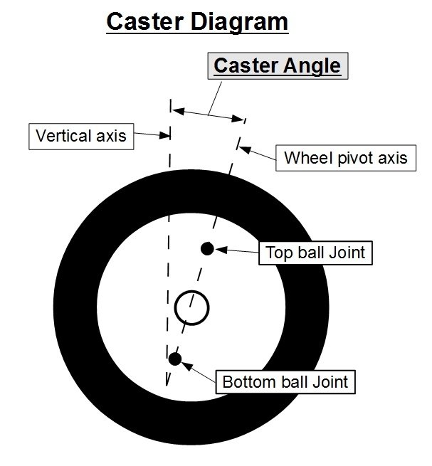

    02 3.4 DC TRD PreRunner 4WD SWAP

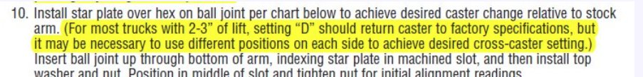

    See but one thing which is bothering my OCD (LOL) @turbodb, note the highlight I made on step 10 of SPC's install sheet - they are saying that a D setting, should return it (caster) back to factory specs on a 2-3" lift. Which is why I left it at D and then took it in for the tech to mess with the cams.
    Again, this is all a shot in the dark - I'm no alignment tech and really have no clue. What I do want and I'd be thrilled if someone could figure it out - what is the best ball joint setting to ensure the most clearance away from the back of the wheel well(?).

    Yeah I'm at the 'D' setting right now but it ain't working for me, I guess I really won't know for sure until I adjust them and see what it's like. Won't be hard to go back to the D setting if I have to I guess

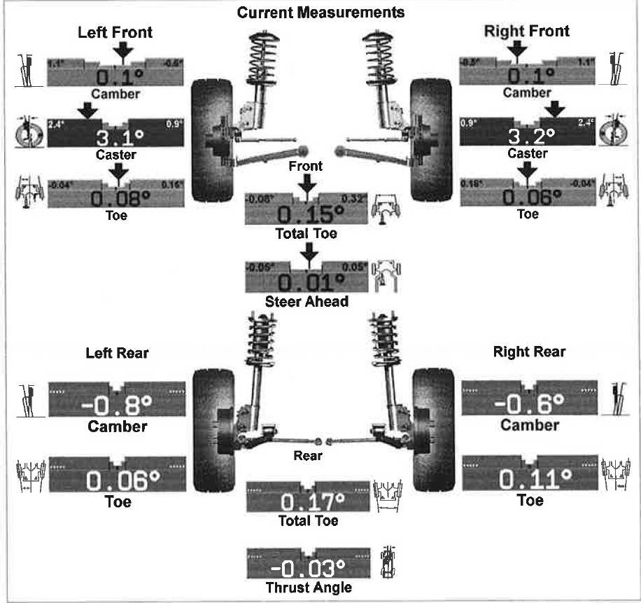

  14. May 3, 2019 at 2:16 PM
    Digiratus
    Digiratus Adventurer
    Mar 26, 2010
    #34006
    23,801
    Roaming the PNW
    The RedHead
    2002 XtraCab TRD 4x4 SCv6 AutoTrans With Lots of Mods ADS COs w/Compression Adjusters Camburg Uniball UCAs Whiteline Lower Control Arm Bushings Kartek 7" Limit Straps Plastics Guy Front Bumpstops Total Chaos Sprindle Gussets Custom Alcan Springs +800 lbs +3" ADS 10" Stroke Triple Bypass w/Resi Rear Shocks Custom Rear Shock Relocate All-Pro U-bolt Flip w/Timbren Bumpstops 4.88 Nitro Gears ARB Front Locker ARB Twin Compressor Black 17x8 Konig Countersteer Type X 285/70r17 Falken A/T3w Gunmetal 16x8 SCS Ray10s 255/85r16 Maxxis Bighorns Limited Edition (Relentless) Elite Front Bumper Smittybilt X2O 10K Winch Diode Dynamics SS3 Sport Selective Yellow Fog Lights in the Bumper Diode Dynamics SS3 Pro 4,000 Kelvin SAE Driving Lights with Clear Lenses on the Bumper Morimoto D2S Projectors XB35 Ballasts + 4300K Bulbs Badland Sliders FrankenFab Tire Carrier Swingout bumper w/kitchen BudBuilt Front & Bellypan Skids BAMF Rear Diff Skid Dometic CFX 55im Fridge/Freezer Alpha II Hardshell RTT Badland Custom Bed Rack Denso 210-0461 105 amp alternator Dual Northstar 24F AGM batteries BlueSea 7622 ML-ACR Battery controller Peak DBI Dual Battery Voltage Monitor Haltech IC-7 Display with Mako Dash Insert Haltech Elite 2500 Standalone ECU Magnuson MP62 Supercharger w/URD 2.2" Pulley Doug Thorley Headers Denso 650cc Fuel Injectors Aeromotive Stealth 340 Fuel Pump TransGo A340F Reprogramming Shift Kit OEM ECU Delete Full A340F Trans Control with the Haltech 2500 ECU 2.5" Magnaflow Hi-Flow CAT Magnaflow 18" Muffler w/Vibrant Resonator 13WL Brake Calipers with OEM Rotors & Pads Braided Steel Brake Lines Kenwood TM-71A Dual Band Ham Radio STI-CO Flex Whip VFH/UHF 1/4 Wave Antenna Midland MTX275 GMRS Radio w/Roof Mount Antenna Pioneer DEH-P9400BH HU Alpine Amps & Type R components (F) and coaxials (R) Wet Okole Seat Covers Weathertech Digital Liners Deck Plate Mod 1" Diff Drop Carrier Bearing Drop

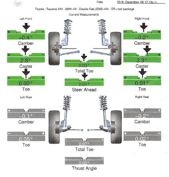

    Here is my alignment sheet. This is with new cam assemblies and whiteline bushings. I do not have the SPC uppers tho, I have the Camburg unibal arms. No rubbing on pinch weld/mud flap area at all under full flex. 285/75-16s on 8" wheels with 4.0" of backspacing. About 2.5" of lift.
    Area51Runner and eon_blue like this.
