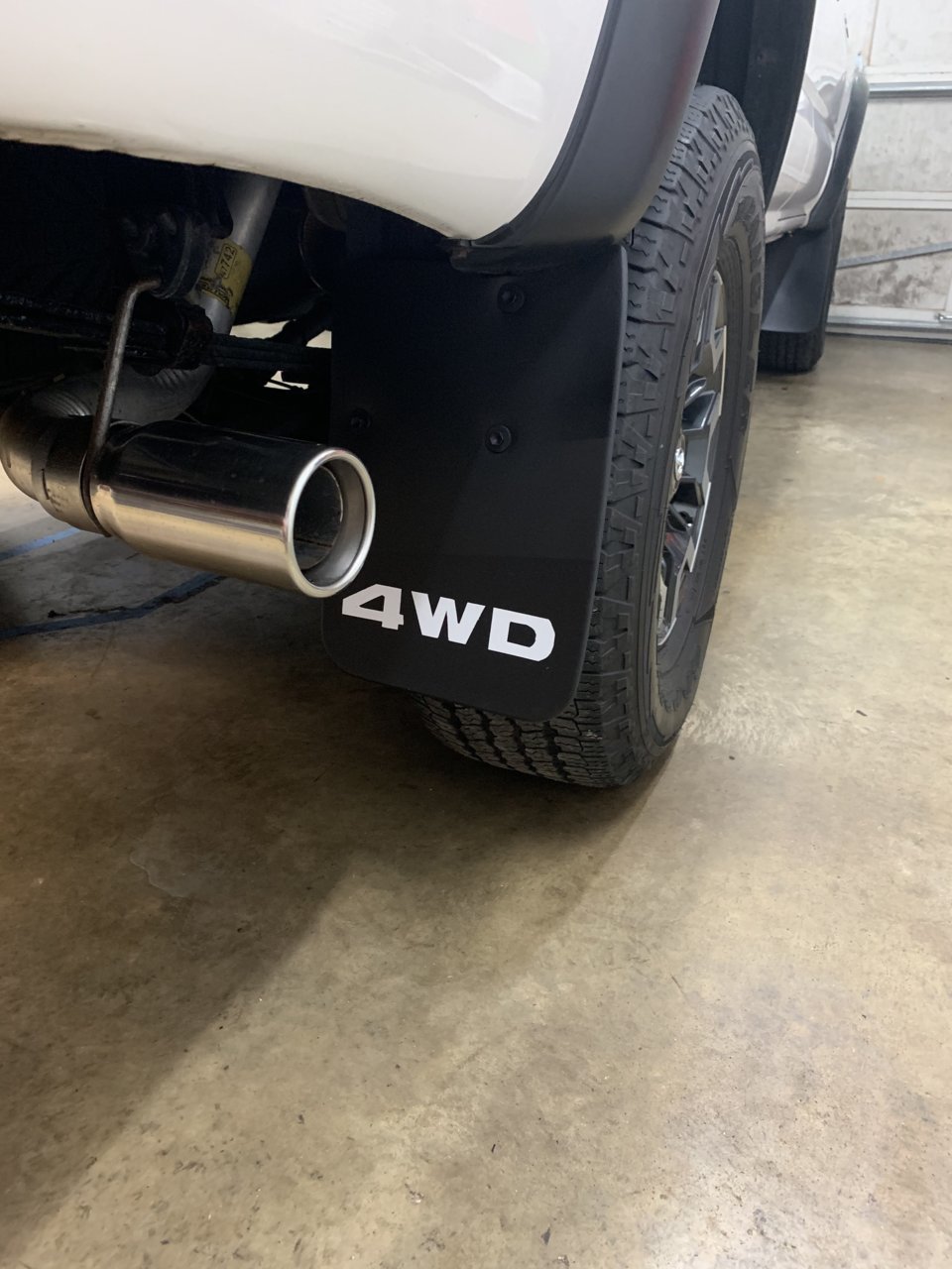

    How did you refinish your flaps? I’m about to do mine?

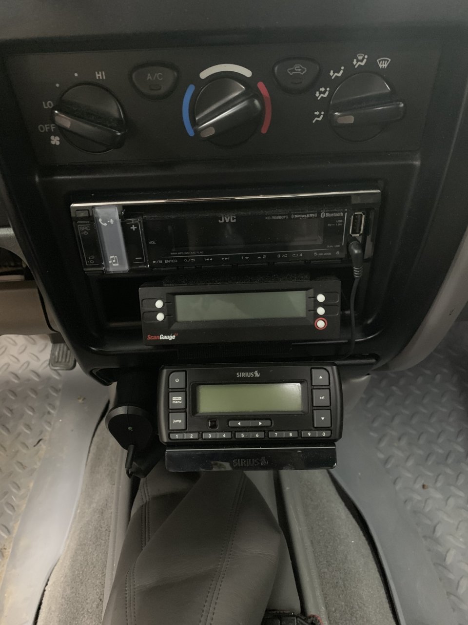

    Just look at the build thread
    Will do. Just gotta find a place to install it that it's easy enough to get to but out of the way of rocks and such.

    Took them off then stripped them down and painted them flat black last weekend. There was a noticeable outline were the letters were so this weekend I masked the letters off and painted them white. Not perfect, but came out pretty good.

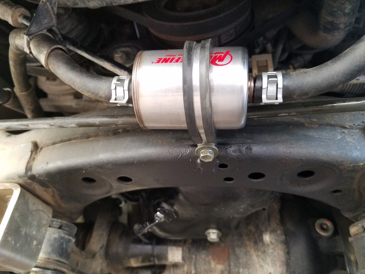

    Same design I have but I'm using it for a power steering filter.

    Just make sure you change em every once in a while. They have a low contamination capacity so they need a change like every year or 15k I think... Might have to look that up

    Where to you tap into the PS line? At the reservoir or by the rack? Have you noticed longer life with the components?

    Use the return line. I haven't had it on the truck long enough to say if it gives longer life or not.

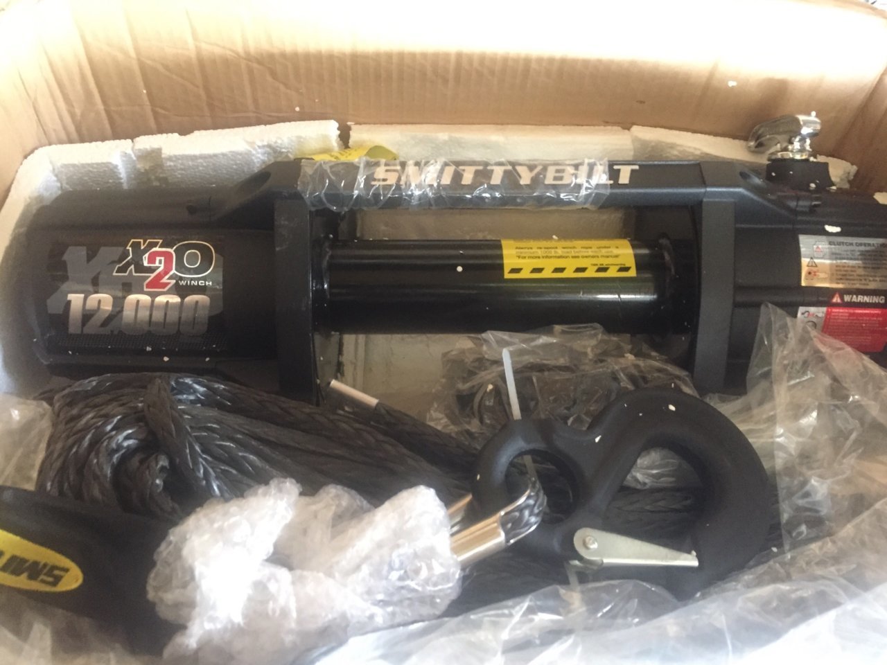

    No work done on the Tacoma today but scored this 400$ Winch for the Tacoma so that counts.

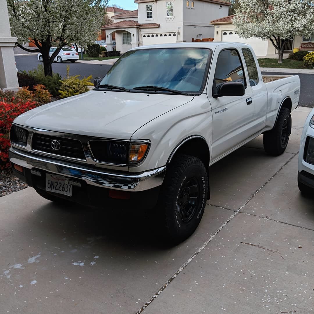

    Went from this:

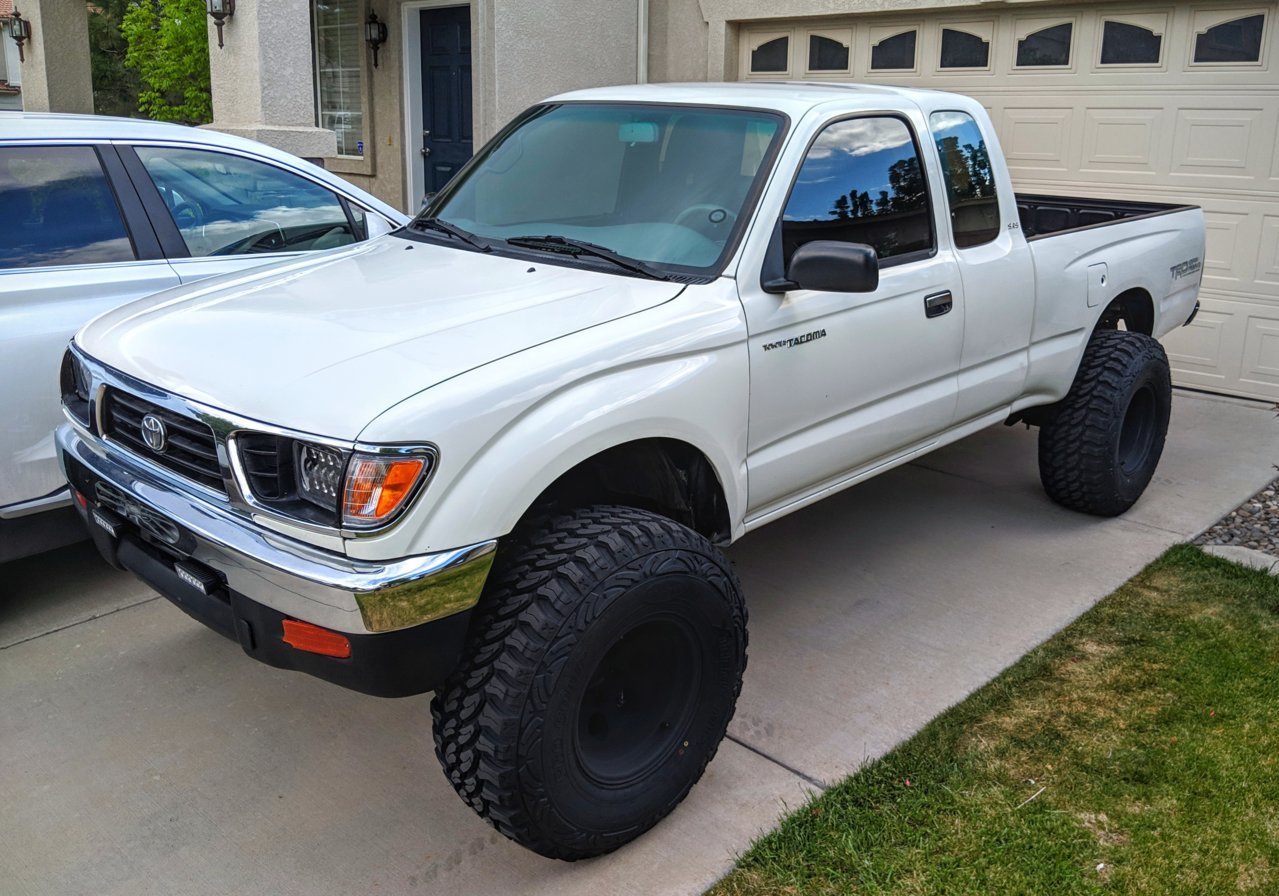

    To this:
