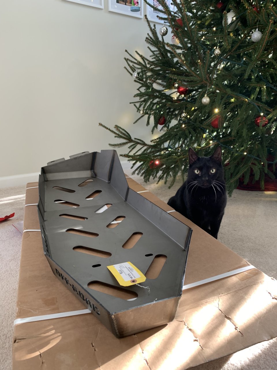

    So, apparently, I didn't fix my 4x4 by banging around, as it wouldn't shift in again yesterday. So, replaced all the vacuum lines in the engine bay. Still not engaging, so I disconnected at the ADD, plugged and pulled vacuum on the line from the other side. Kept losing vacuum, soooooooooo, guess what I get to do today!!! YAY, more vacuum line replacement. Since I'm OCD, I'm gonna get 20' of line and replace all the lines I can find. :)
    I dig that skid. How does it mount on the end closest to the camera? (haven't messed with the tank yet)
    Also: That cat looks like you photoshopped it in... god they are creepy.

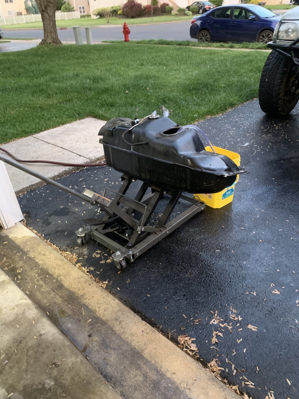

    is that a new or used tank?
    i priced new one more than $500 :mad: wonder wot squirmies i got swimming around in mine
    that does look good, is it corrosion proof or do you get it coated? .. is it much heavier than the old stock?
    i would like to see what that looks like when its on!
    dammit pending LineX job and the big pay0ut for that
