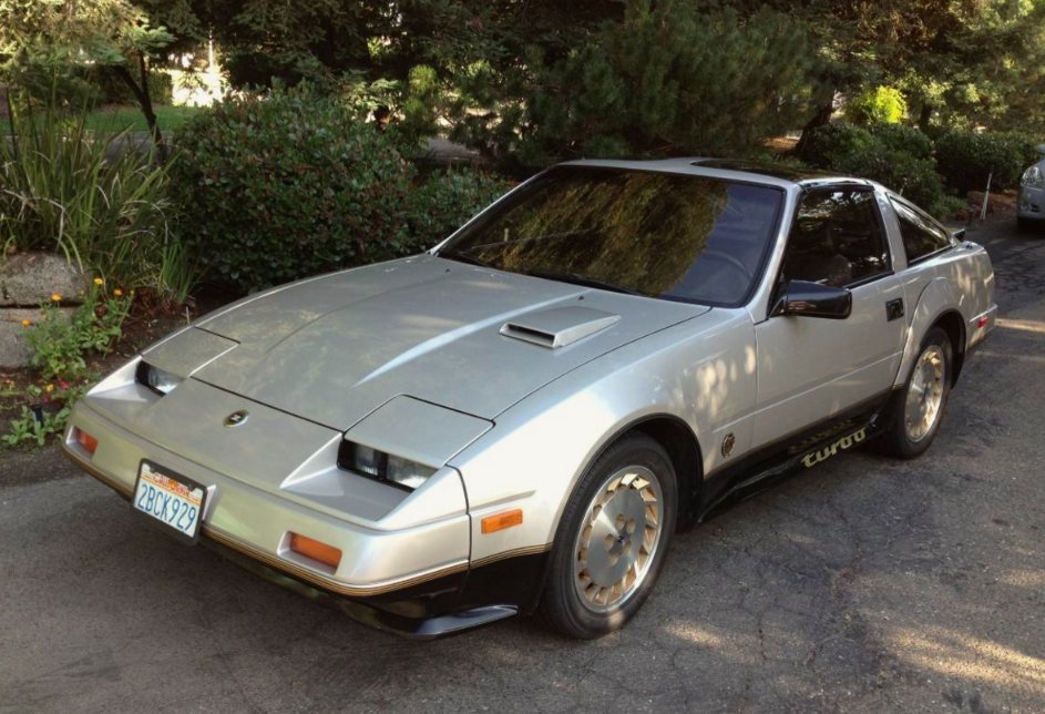

    It's less Tacoma and more mod
    280zx vents look badass, seen em used on Jeep's and other cars
