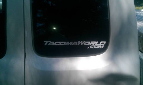

    finally got my TW sticker in the mail this mornin

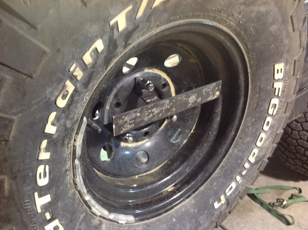

    Made a liscsense plate bracket

    good idea, monte! i like it. :cool:

    Thanks man! I like it. Keeps my receiver open amd it's nice and outa the way yet very visible.

    Does your state require a license plate light?

    Yep. That'll come easy. Just need to extended the wires forgot the OEM light and mount a new light. I'll do that when I do all my other bed lights.

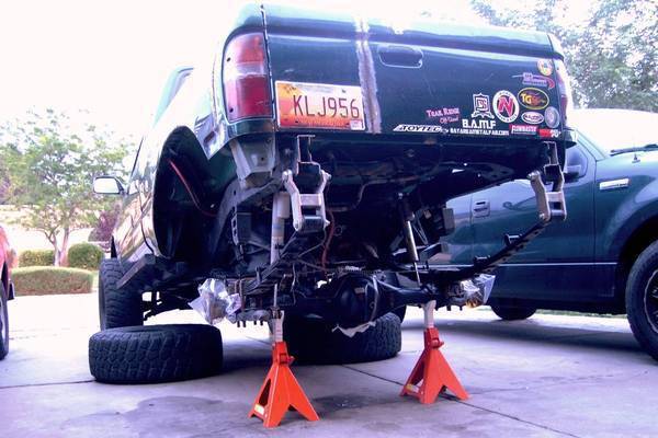

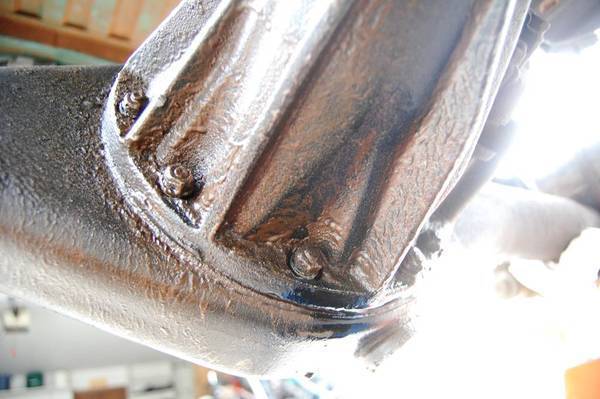

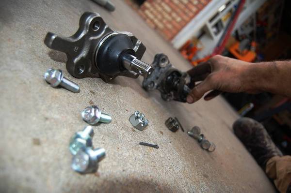

    Not exactly today, but I replaced the driverside LBJ with Moog...

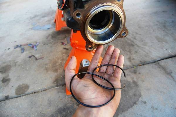

    Replaced passenger side axle tube o-ring

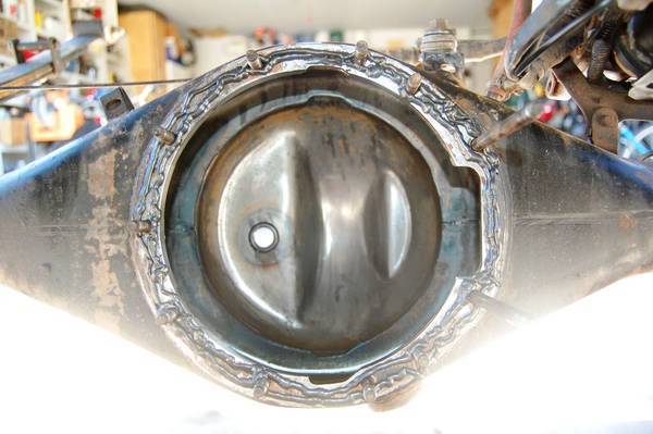

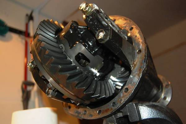

    Pulled the third member to reseal and inspect. It has been leaking pretty bad since running Cliffhanger in Moab....
    All pre-loads and backlash looks good! :woot:

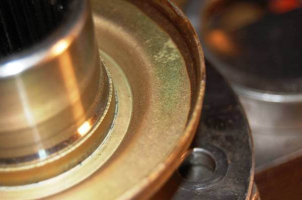

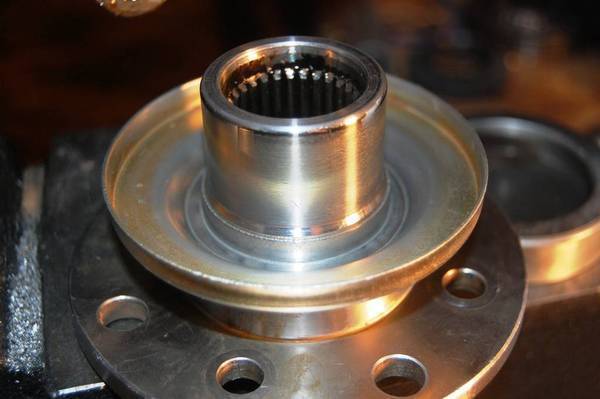

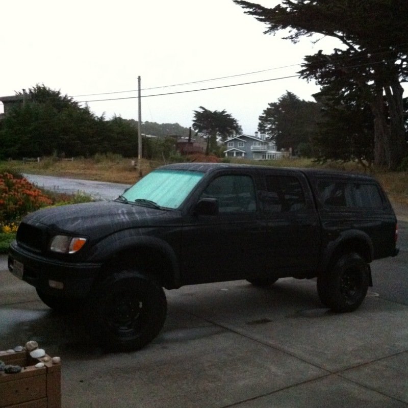

    Was going to replace the pinion seal since I thought that was leaking too, but it appears that Marlin sent me the wrong size.... Only reason I ordered from them is because I really wanted the eco-seal, but they said they don't have them for my rear but we have OEM in stock... ah well. So I re-seated the leaky one as best I could with black gasket maker instead blue RTV like I did the first time.... Also sanded down the flange where the seal sits and so far, it has helped a lot!
    Before sanding flange:
    After:
    "Double" sealed the diff with permatex gasket maker 1 min cure and popped her back in. :) And not a single drop of oil leaked on the driveway last night!!! :woot:
