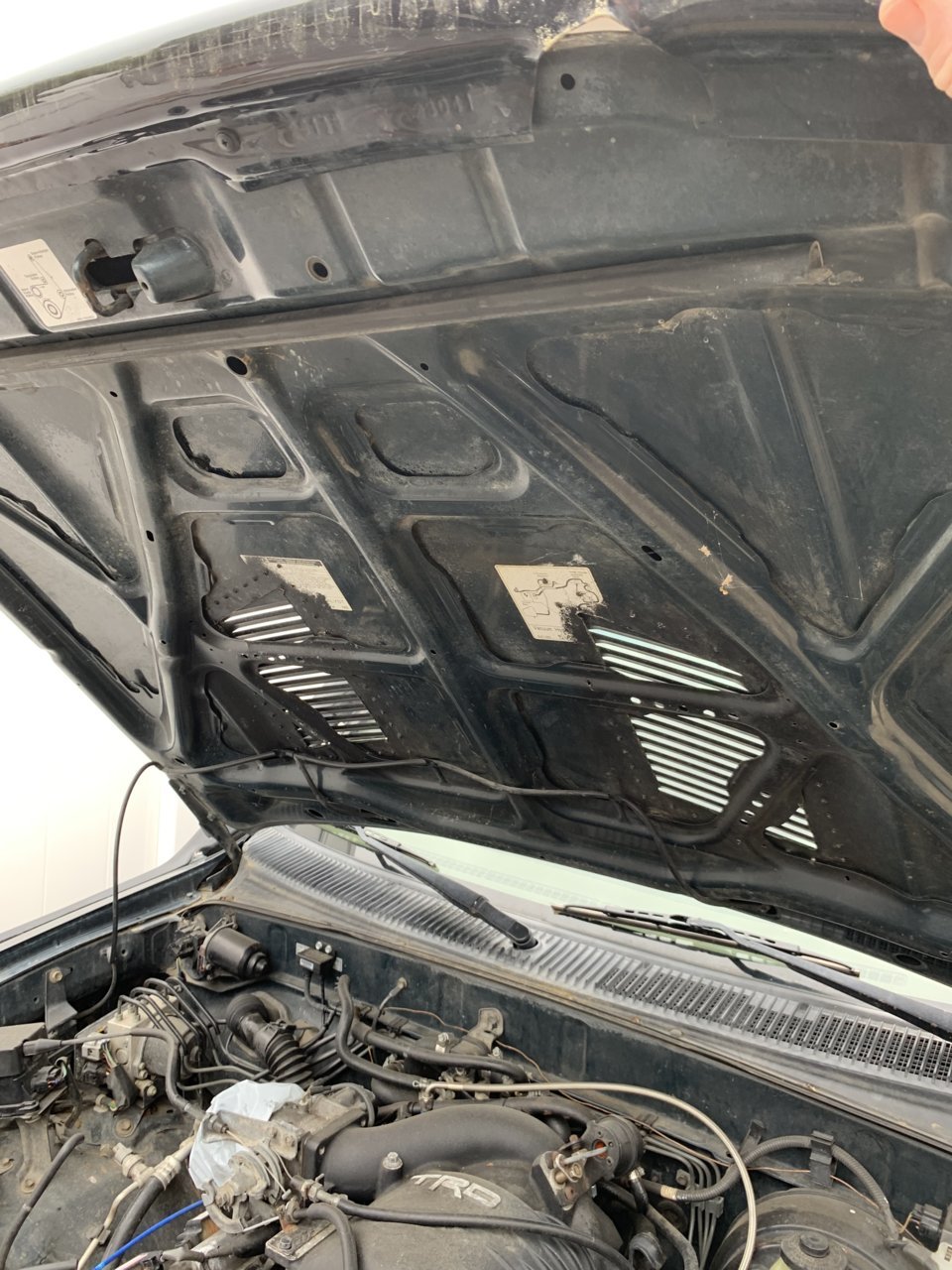

    I see you have the supercharger as well, so you noticed a considerable effect on lower intake temps with these hood vents?
    Considering this myself, once summer hits here my intake temps skyrocket with how hot the charger gets under the hood

    I didn’t measure that before/after as these went on long before the super charger. But they move some hot air! On hot days you can see the heat waves coming out at stoplights; wave your arm above the hood and you can feel the warm air blowing out. With the stock fan blowing this gives an easier escape path for the dispelled hot air to vent.
    With these on, plus the snorkel and (later) 11# of boost I never had a heat problem. Rest of cooling system was 100% stock save for external trans cooler (just done to prevent the pink milkshake).
    We loaded the 4runner heavy-full armor, rack, 100# dog, 100# girlfriend, 200# me and full camping gear. Crawling around at altitude in the hot Cali summers and never had a single “uh oh it’s getting a little hot” moment. Ran air conditioning too.
    The only downside is cutting up your hood. Never had a problem with rain getting in there; yea I’m sure a tiny bit did. But the engine sees water every time I run through a creek or puddle anyways?
    Had it in big snowstorms skiing all winter too, no problems. Actually kinda cool example of them working-the hot air melts the snow above the vents first.
    IMHO it’s a cheap, easy no downside kinda mod-unless you REALLY hate the look. I personally dig it.
    Our K9 guys all have these to keep the squad cars cool running AC for the fur missiles in back.

    I noticed a difference in intake temps just with the snorkel pulling in air from outside the wheel well/engine bay so I'm sure this helps a bit too.
    I dig the look myself

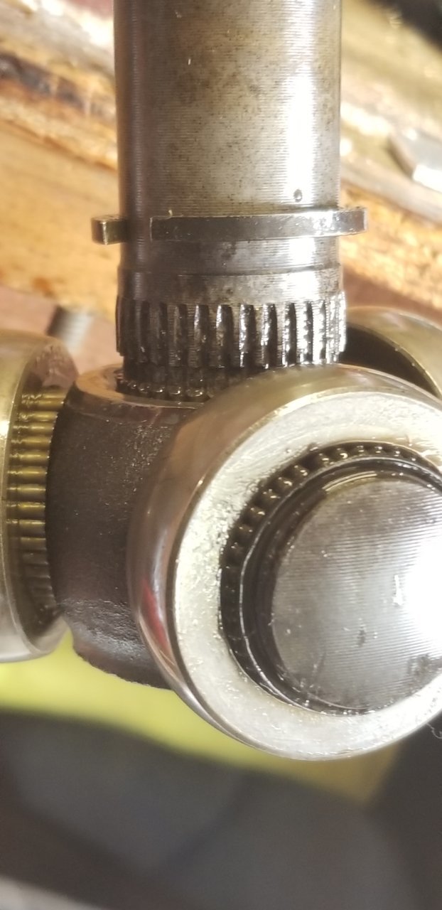

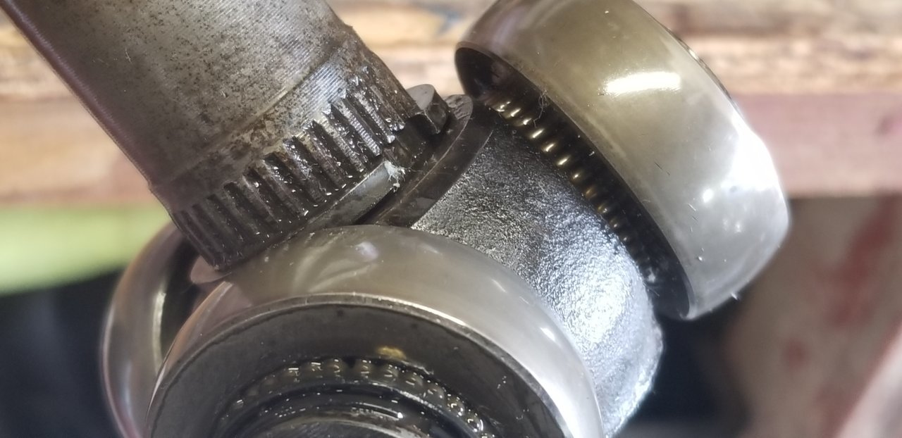

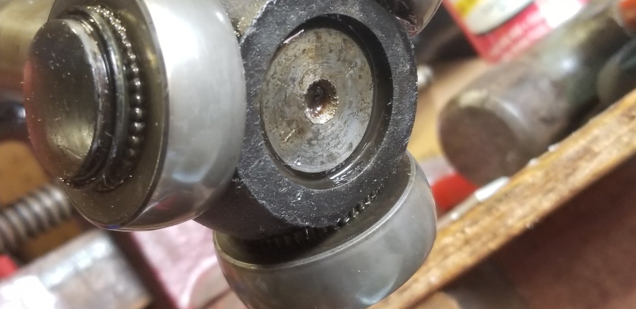

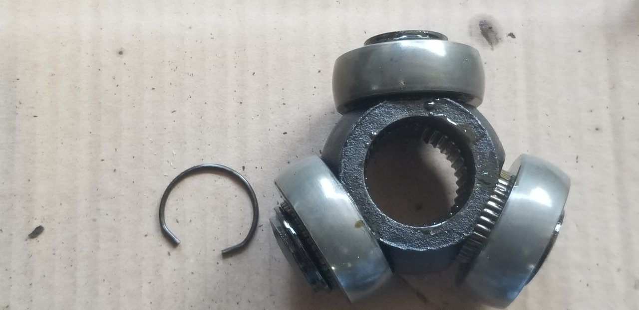

    Alright fam. Need some help. Should have snagged a fsm. But I'm hoping the collective knowledge of tw can get me through this.
    I'm putting new boots on my CVs and have come to a "roadblock". The timmy the toolman video showed a lock ring at the end of the CV. However it was on a 4 runner. I'm not seeing one at the end. Its below it. See photos.
    Should I just keep using the punch to tap the top mechanism off? Tried a little but I didnt get any movement.
    Is there a trick here I'm not seeing?
    I want to make sure this is right before I proceed.
    Thanks in advance

    Theres a snap ring in there can see it in your second picture
    erice likes this.

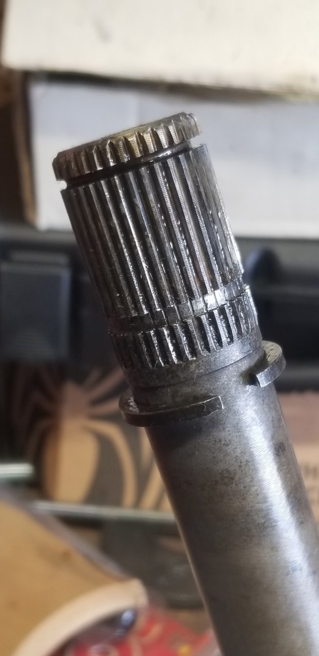

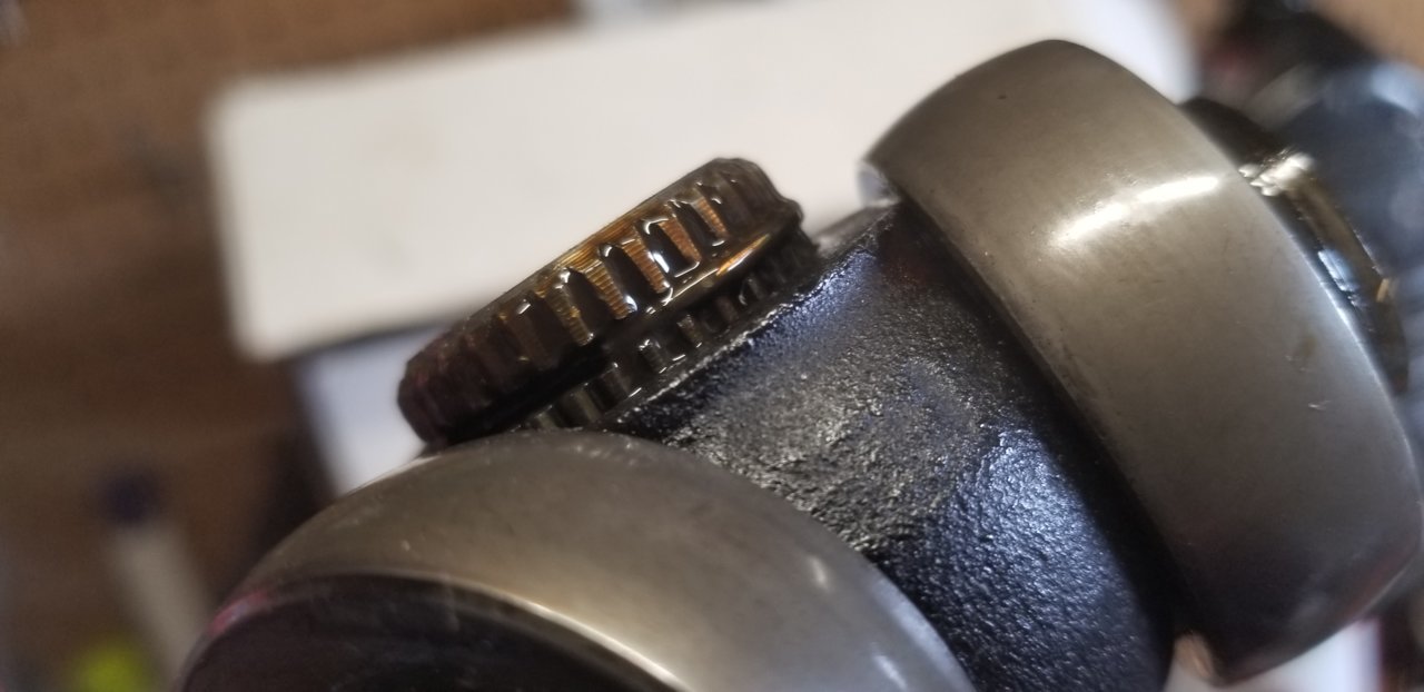

    yeah but it appears that just keeps it from falling down. i want it to go in the other direction. Also, i can't get it out with the lock ring pliers i have. it just keeps slipping off.
    Thank you. Downloading it now. Had to come to something bigger than a phone.
    well.. i guess i'm doing it right. guess i just gotta tap on.
    (b) Remove the inboard joint tulip from the drive shaft.
    4. REMOVE TRIPOD JOINT FROM DRIVE SHAFT
    (a) Using a snap ring expander, remove the snap ring.
    Update:
    Got the snap ring moved back. Yay!
    There is play in the tripod but it wont come off. It's as if there is something preventing it.
    Has anyone done this before?
    How hard do I need to hammer this thing to get it off (yes I know not to hit the rollers)?
    I'm using a steel punch rn. But think I might go get some brass because I dont want to mess it up if I have to put more force on It.

    Ok... so, the fsm does no mention this step.
    Clip 1 needs to be removed.
    Tulip or tripod needs to be hammered back revealing a second clip.
    Remove clip (finding it after it sails across your workspace)
    proceed
