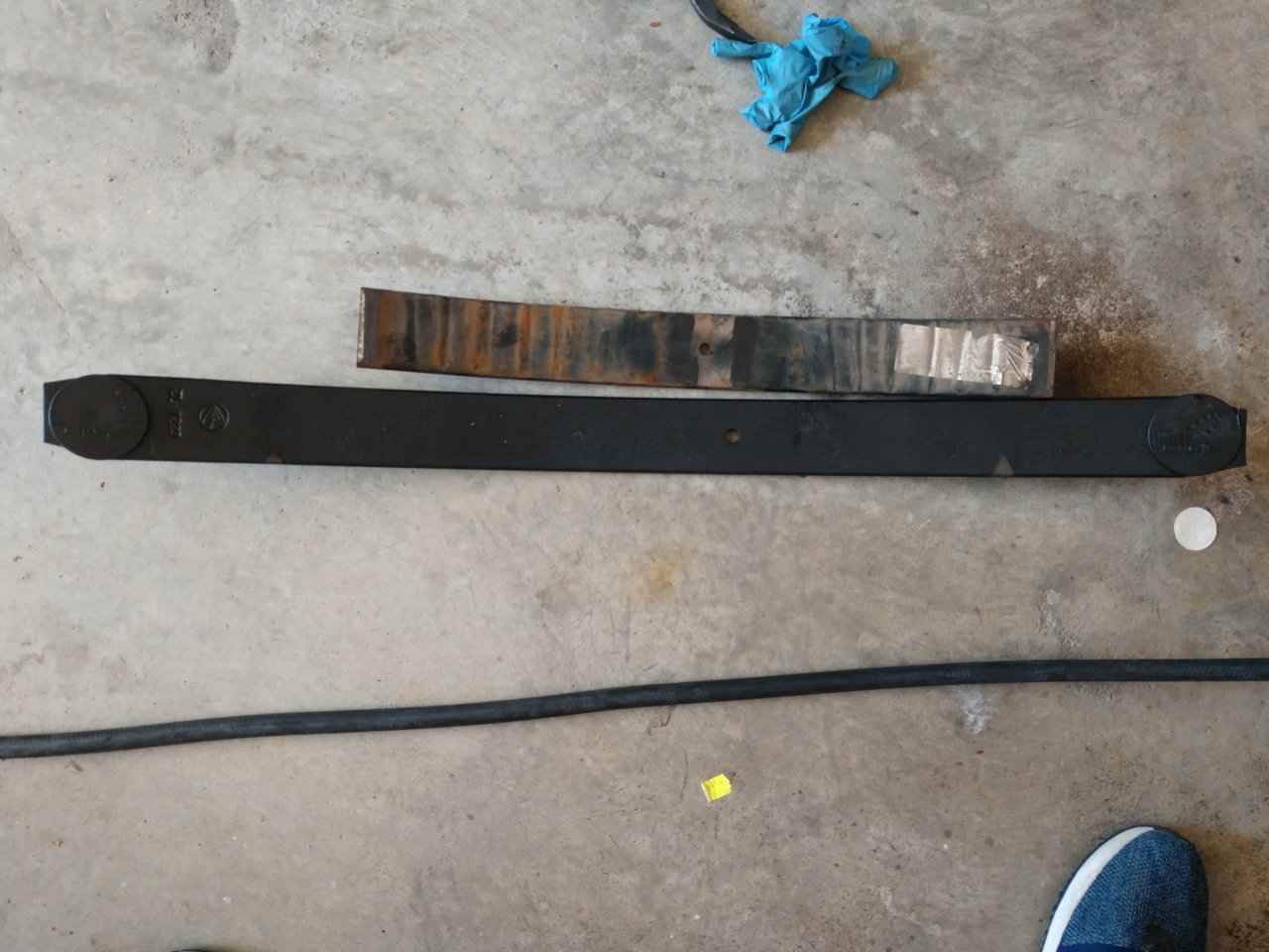

    Swapping out add a leafs today. Notice a difference? IMG_20190520_113440431.jpg
    Look how shiny the ends are on the old one. Thats the cause of my squeaks. New one has pads.

    1999 Tacoma PreRunner TRD
    Everything but the driveshaft. B03A - 410
    Nice AAL. Did you get any lift from it?

    Still working on it. That pic is where Im at right now. Old one gave me slightly over 2", new one should be close to 1.5".

    Got my add a leafs switched out. Damn thing still squeaks. Guess it wasnt just the old add a leaf making the noise. Its not as bad, and I dont get the poping sound that I did whenever I get in the cab or bed, so Ill consider it a win. And the new aals dropped me down to being within a half inch of the front, so thats a win there too. And I think it rides smoother too, but that could be me just telling myself that.

    Should ride smoother, AALs increase the load capacity and stiffen the ride on an unloaded bed. Back when I put the AAL in my Dakars it noticeably stiffened the ride

    The wheelers spring is noticeably less stiffer than the lowrange. The size difference told me that as soon as I opened the box. IMG_20190520_113440431.jpg
    Lowrange spring is much thicker and short. Wheelers is thin, yet longer.
