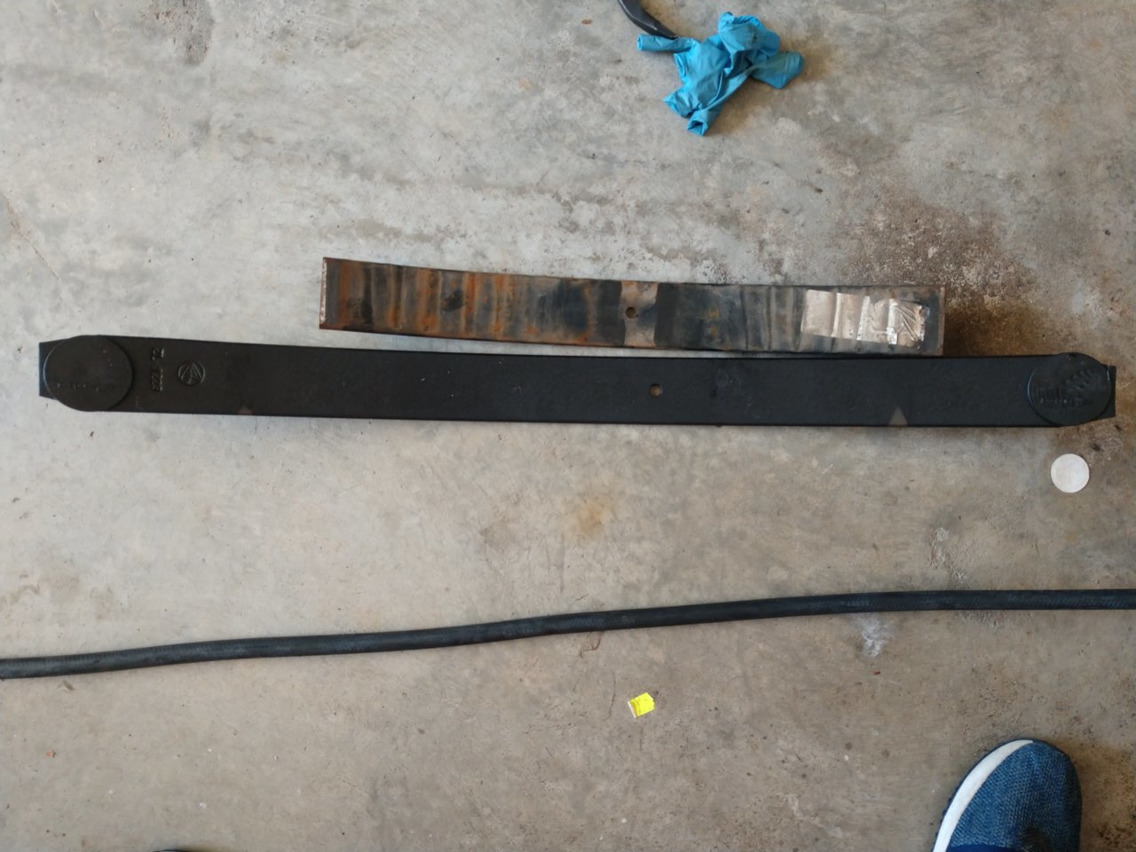

    Oh I see so you didn't remove the AAL you just swapped it out for a different one?
    My Expos have a few leafs in them that are very short just like that Low Range AAL, whereas the Dakars were comprised of all long leafs. Dakars rode smooth but couldn't hold weight, the Expos hold weight but don't ride smooth. Makes sense what you experienced with switching AALs

    I swapped one without pads on it to one that had the pads in hopes of eliminating the squeaks. Guess part of it was the leaf packs themselves. Oh well, aside from dropping the coin on some deavers, there is no other options for me. Gonna live with it until the day comes when these cheap aftermarket springs start sagging.
    At least it doesnt pop anymore when I get in and out. That honestly got on my nerves worse than the squeaking. And the truck sits almost exactly level now.

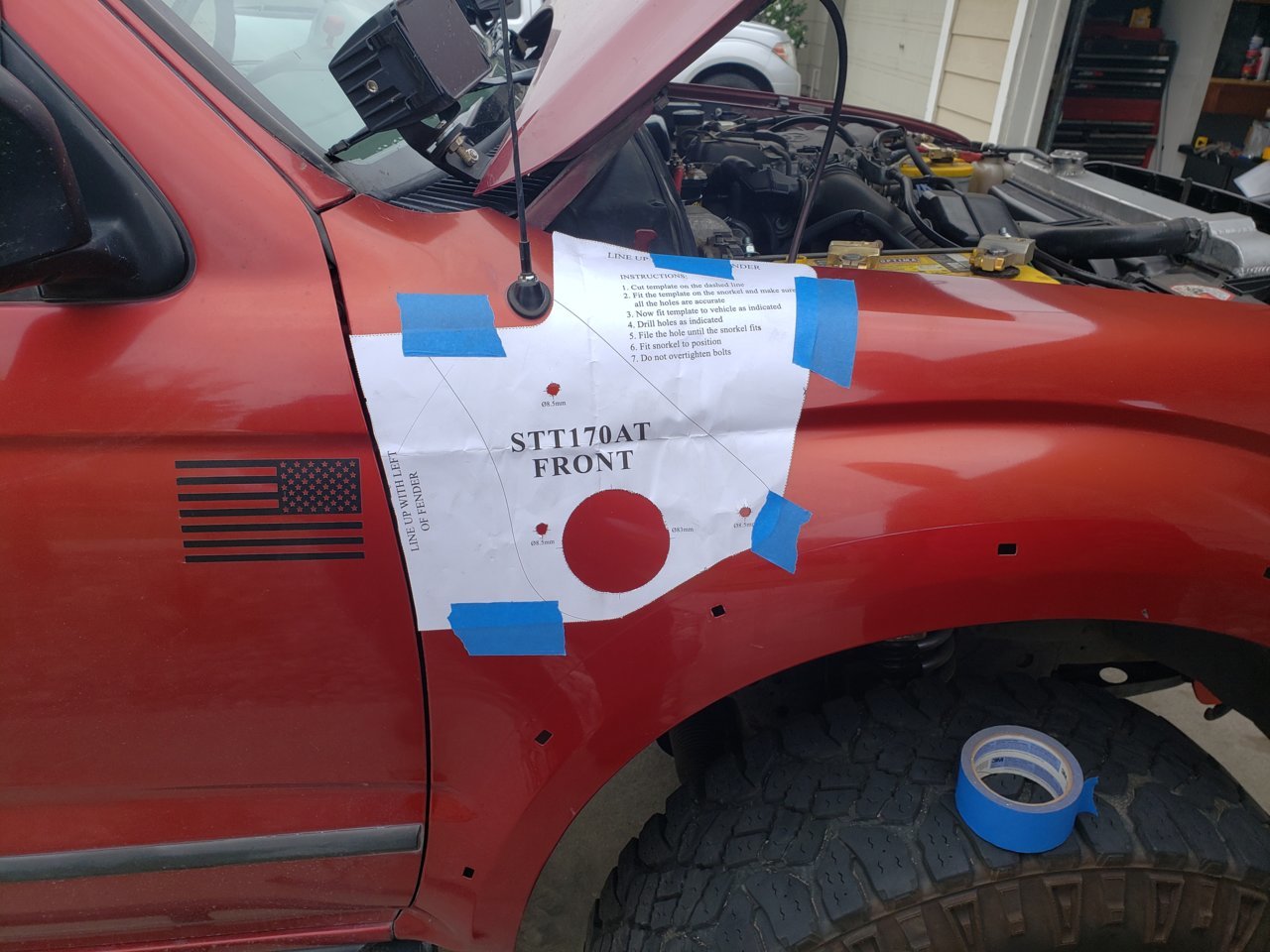

    I've got a hole saw...
    Got to this point and had a beer and a cigarette...
    Then said fuck it, and did it.

    I got a hole saw. And the testicular fortitude to cut your truck. lol
    Dude, I was hung over as fuck when I tackled my snorkel install. Not the business.

    Get the 3.5" Milwaukee hole saw, it works like a charm and cuts right through like butter. I made the mistake of trying to use a more shallow 3.5" hole saw from Harbor Freight (only one they sell) and it wouldn't cut through the fender.

    I put the rivets in, but I put some silicone in the holes for the water

    There was a lot of talk about that on the main Ebay Snorkel thread...personally I just used the rivets. On that note, get a good rivet gun...they're decent sized rivets and those cheap rivet guns that you squeeze off by hand take a lot of hand grip/strength to pinch those rivets off.
    Some guys used self tapping screws instead and a few others I think went the double side tape route. I like the rivets because they hold 100% tight with zero play at all, and unlike the tape I don't have to worry about it coming undone and moving around. Self tapping screws should work too, only advantage I see to those is that they're easier to remove if you ever need to.
    Since the kit came with rivets and that's what was recommended, that's what I used and have had zero issues with movement or water leaking into them. I didn't use silicone but haven't noticed any issues with water.

    Its probably stainless rivets that they send you if it takes a ton of force to pop them. Use aluminum ones instead and they snap off with ease.

    I said fuck it and drilled the A-pillar holes, filled em with silicone, and sent (small) self tapping screws into that bitch.
    My buddy had rivnuts… he was going to come over later... but it started to rain, and I'm too impatient about that shit.
    Not sure I'd trust 3M tape. At highway speeds I'll bet there's a lot of wind force on the snorkel intake.

    Self trappers don't last. After 3 years mine were stripped out. Rivnuts are the way to go. It's well worth having the tool for a lot of other sheet metal projects too.
    I wouldn't trust tape. If a branch grabs the head of the snorkel and pulls the tape off its going to have a lot of leverage on the fender.
