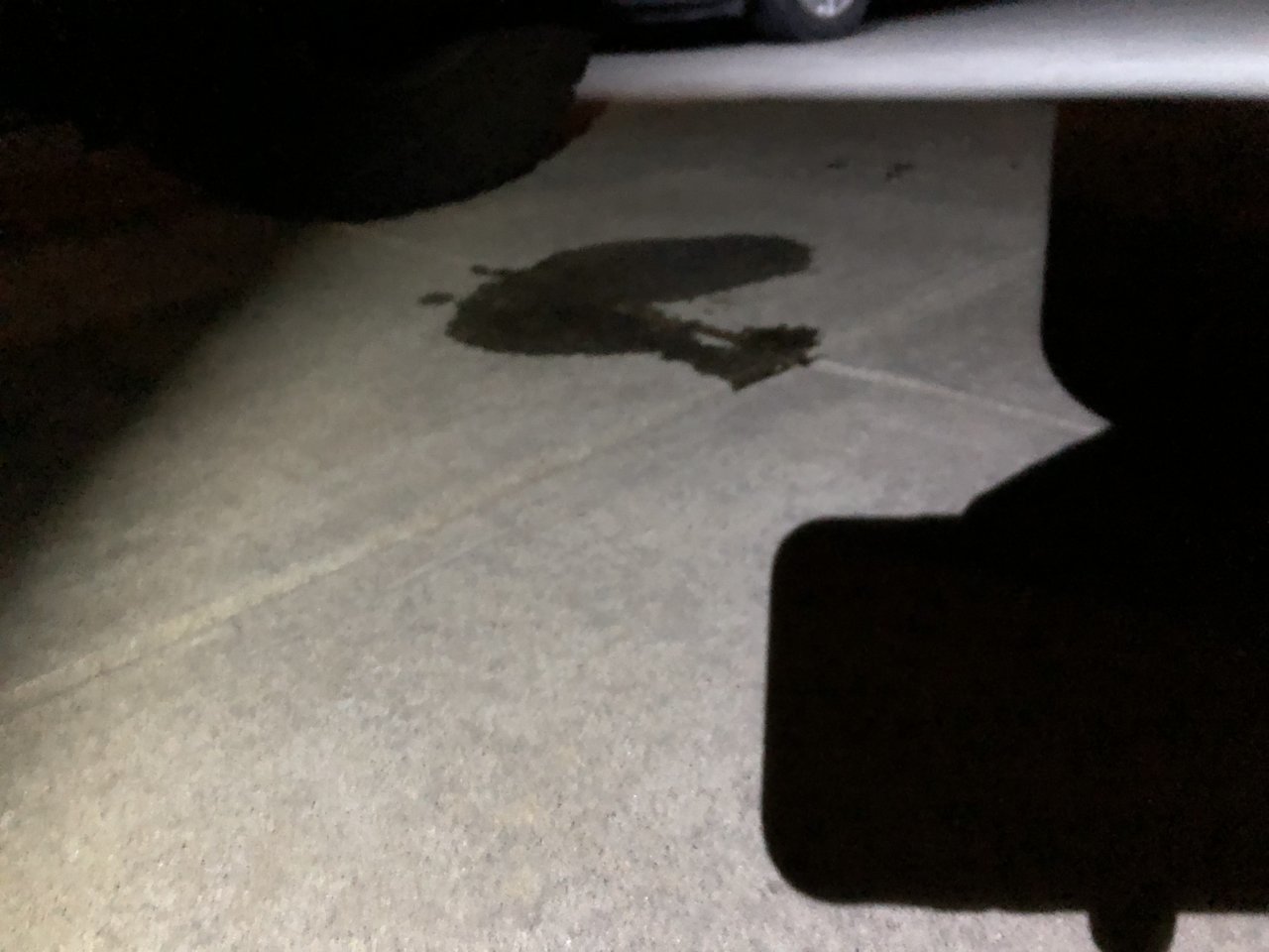

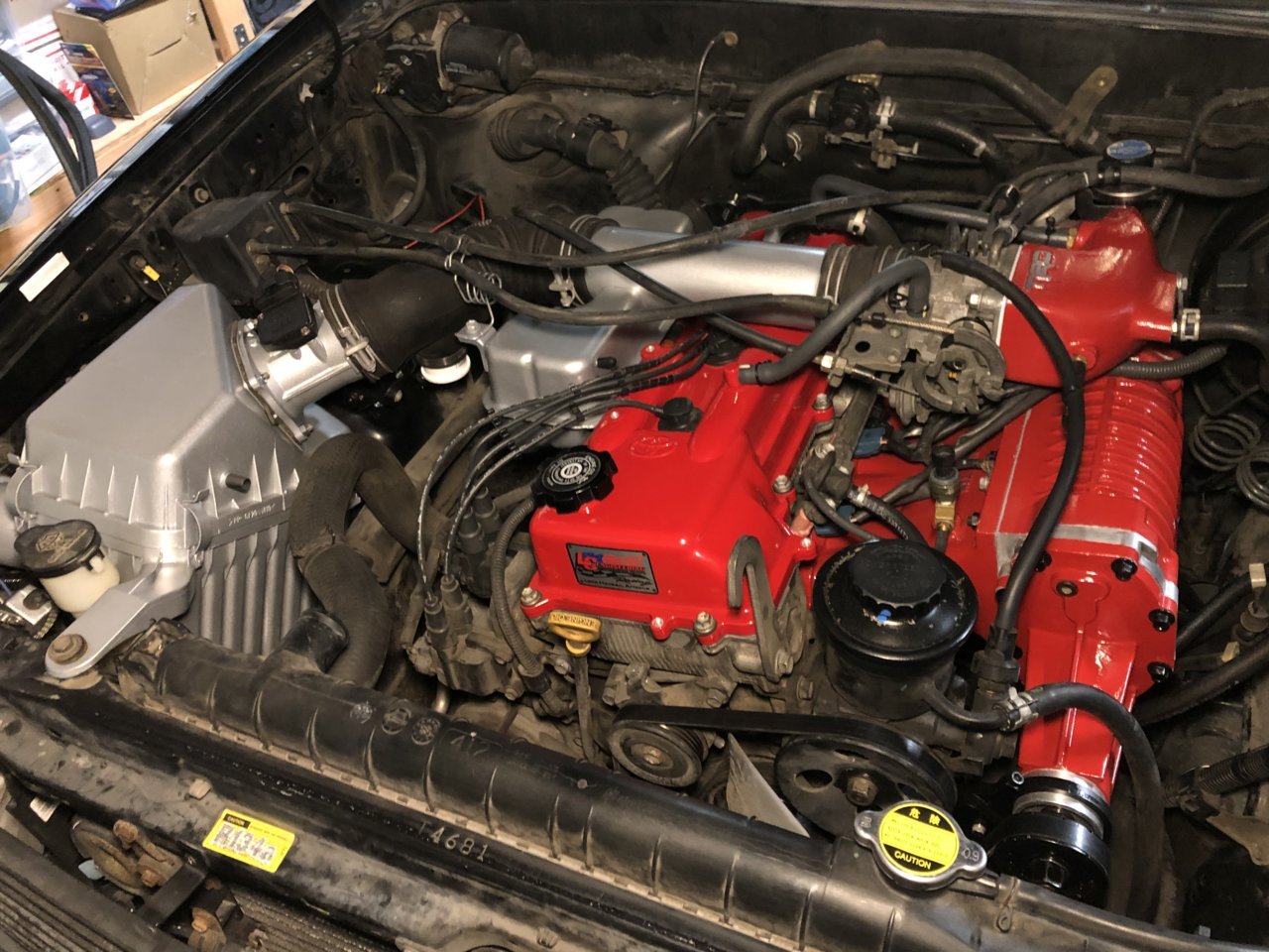

    Well, moment of truth. I finally finished installing the supercharger, sans gauges and methanol injection for now just to get it running.
    I disengaged the parking brake and put it into Neutral so I could push it into the driveway so I didn’t kill who lives behind my garage.
    I started cranking it, and cranking it, and cranking it, and then it started to sputter, but wouldn’t idle. It really wanted to start but it didn’t.
    Then I go outside and I immediately smell gas and I see this major fuel leak:
    It appears to be Injector 3 and 4. 3 has a little moisture, and 4 seems shiny. Hard to tell if it’s really fuel because I can’t physically poke my finger down there. I felt around on all the fuel filter banjo fittings and the banjo fitting on the fuel rail but they were dry. The puddle is definitely gas.
    Looks like it’s a pinched O-Ring. Boy I’ve fought that fuel rail for three days now.

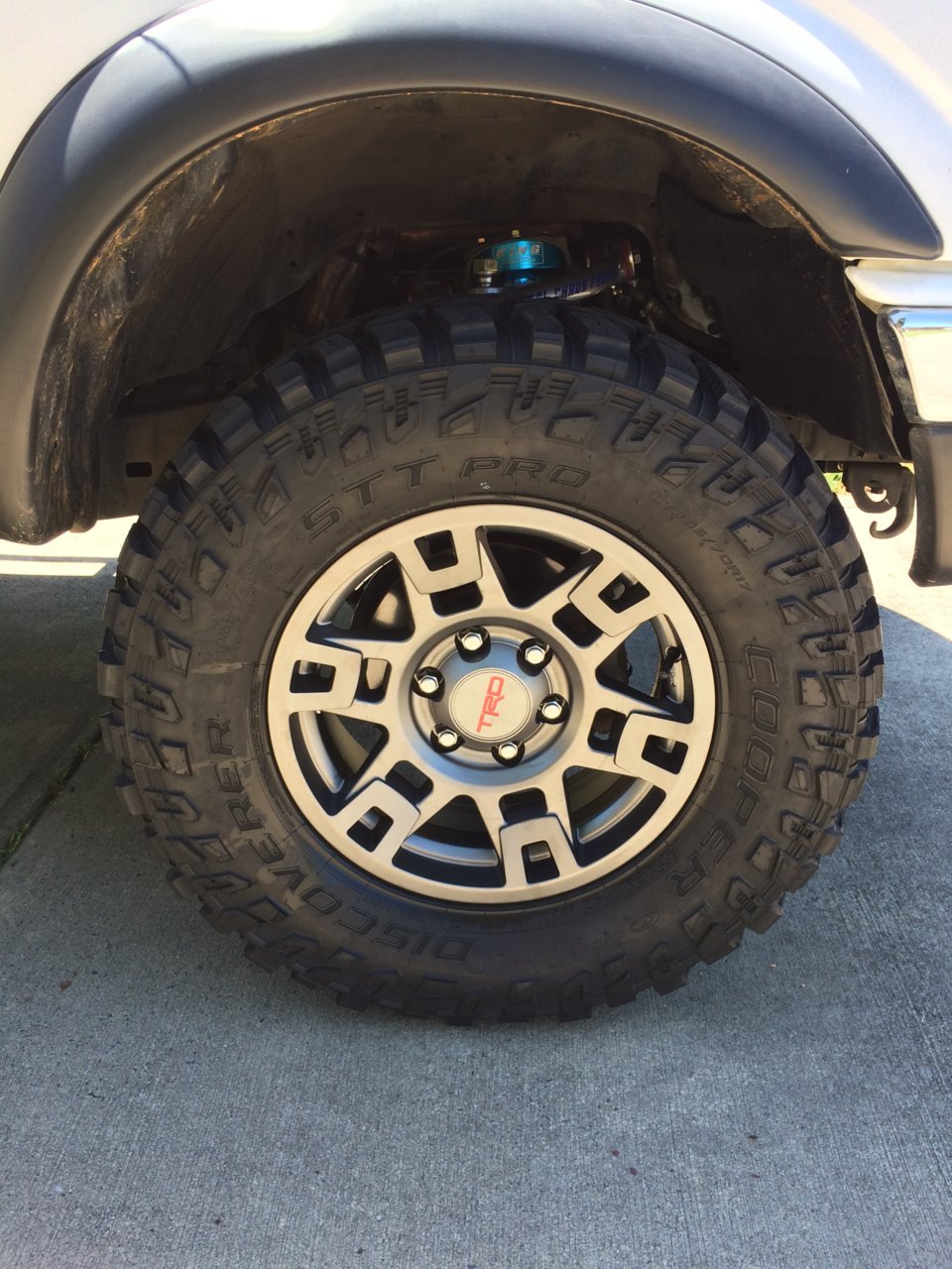

    Wheels and tires went on today along with alignment post-lift install. Decided to give Firestone a shot since they do lifetime instead of the other recommended shop. Alignment numbers below (told you that front drivers wheel was way off) how’d they do?

    That’s definitely something I’d drive everyday. Looks clean.

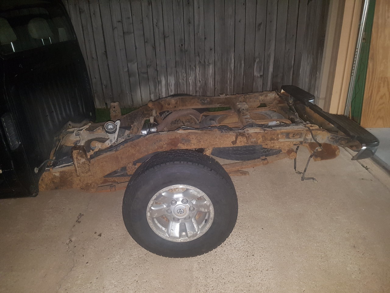

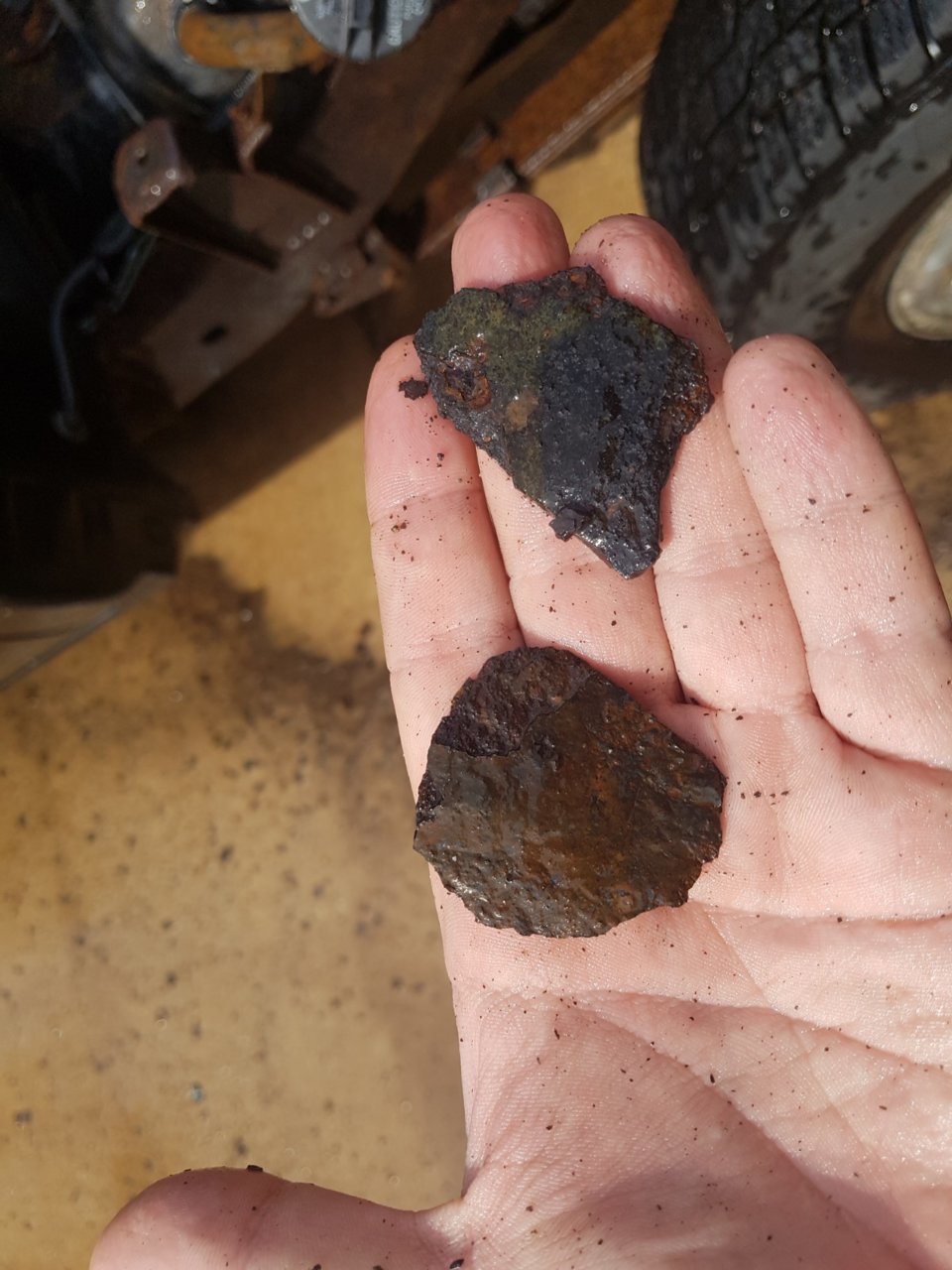

    All in all I'm pretty happy. It's definitely not 100% good, but the last picture shows the worst damage I found. The frame itself seems pretty solid, I didn't blow any holes through it with the pressure washer. I suspect its probably thin in places since they rust from the inside out, but there's probably enough left to weld to. The plan for now is to rust treat it, put the bed back on and drive it. I'll circle back around to it later in the summer and probably safe-t-cap it.

    Crazy how our environments influence this sort of thing...if I were holding pieces of my frame like that, I'd probably be in tears lol.

    *Clearly* all of these extra pieces were unnecessary, and its just going to be lighter and faster now.:plane:
    If for some reason I came across a compatible frame and I had the time/money to swap, I probably would. I grew up here in Texas and rust is very much uncommon, unless you live on the beach.

    Looks good, you could probably ask for more caster since you have aftermarket UCAs

    Yeah you want more caster for sure, unless you're lucky and are not rubbing the pinch weld at all. But usually with a lift and 33s you want 3 degrees caster or close to it.
    Most shops won't do that unless you ask specifically, because technically the caster they gave you is what is recommended for these trucks. But of course a lift and bigger tires changes things.

    Thanks, they mentioned they’d get it as close to factory spec as possible. I’m guessing they didn’t even touch the UCAs. I didn’t get a chance to stretch it out and listen for rubbing, had to go back to work. I’ll ask for that 3 degrees of caster when I go back. Thank you both!
