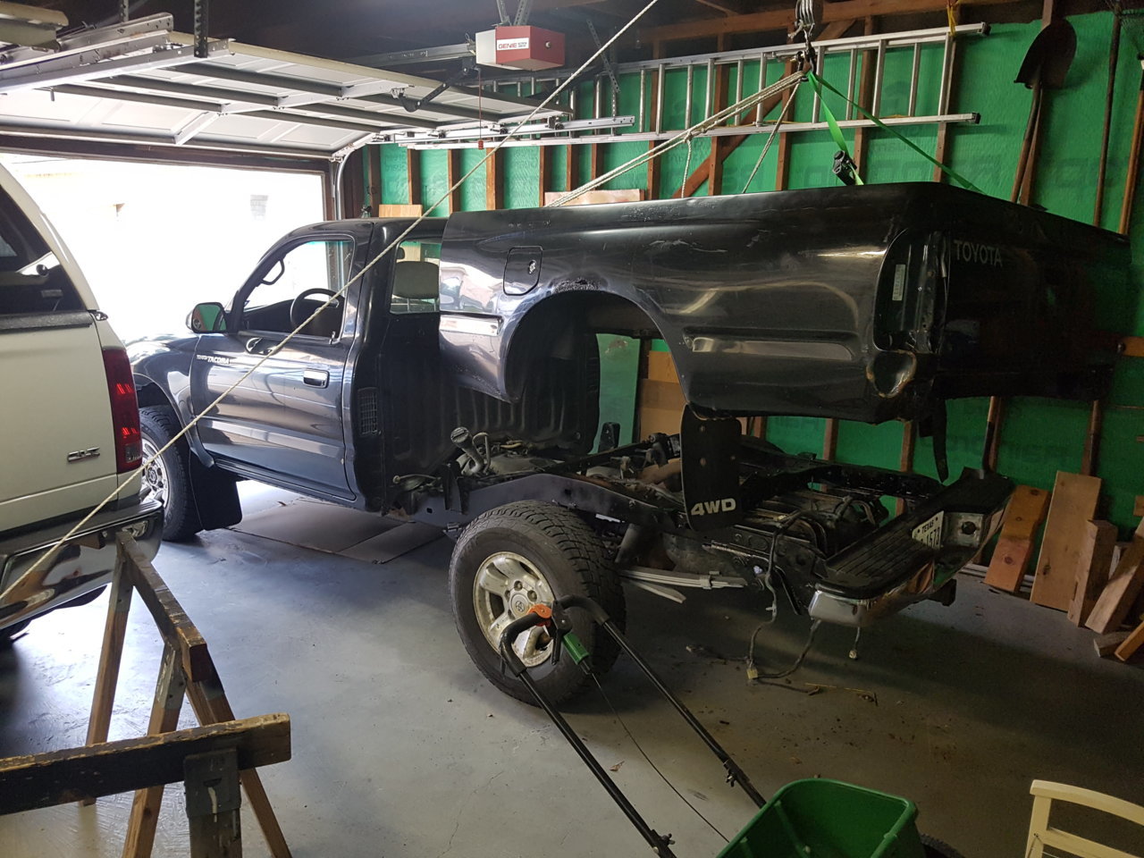

    How much of a PINTA was it getting the bed off?

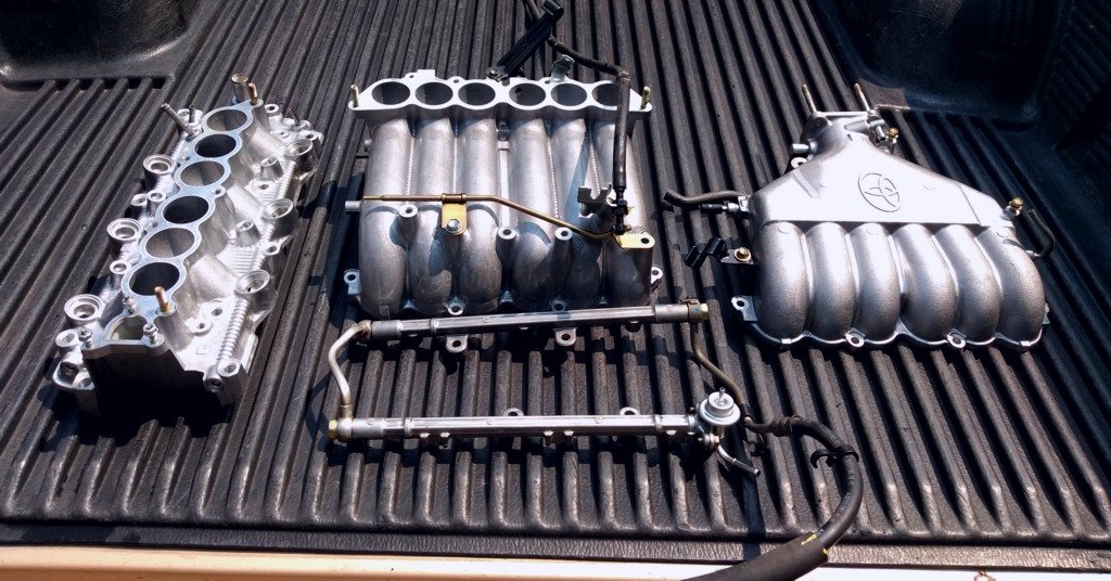

    Tried a new product named "Glisten PC" from the POR-15 company that is a clear coat designed for Aluminum wheels. It's advertised to be high-gloss, rock-hard, flexible and will never crack, chip, peel or yellow. Designed for brush or spray application. I used a brush for the sand cast aluminum intake manifold parts.
    The guys at my local DuPont paint store recommended it to keep aluminum parts sealed so they won't tarnish. It is supposed to stand up to wheel heat without peeling. So I'm giving it a try. Time will tell how this will work out. I've tried many different clear products for aluminum without success. Most change the aluminum color to look like something that has been painted with aluminum paint or they yellow or peel. It dries to the touch in 1 hour. Though, it takes 3 to 4 days to fully cure.
    Let's see how this goes before anyone else tries it. I like to run with a product for a while before making a recommendation.

    Bed removal is simple 6 bolts fuel filler neck and brake light wire harness. I can now remove mine in less then 30 minutes

    Like the other guy said, not bad at all. my bolts were rusty so a cheater bar and a 6 point socket are helpful. Getting it back on the hardest part was wiggling it around to get the fuel filler back in it's spot.

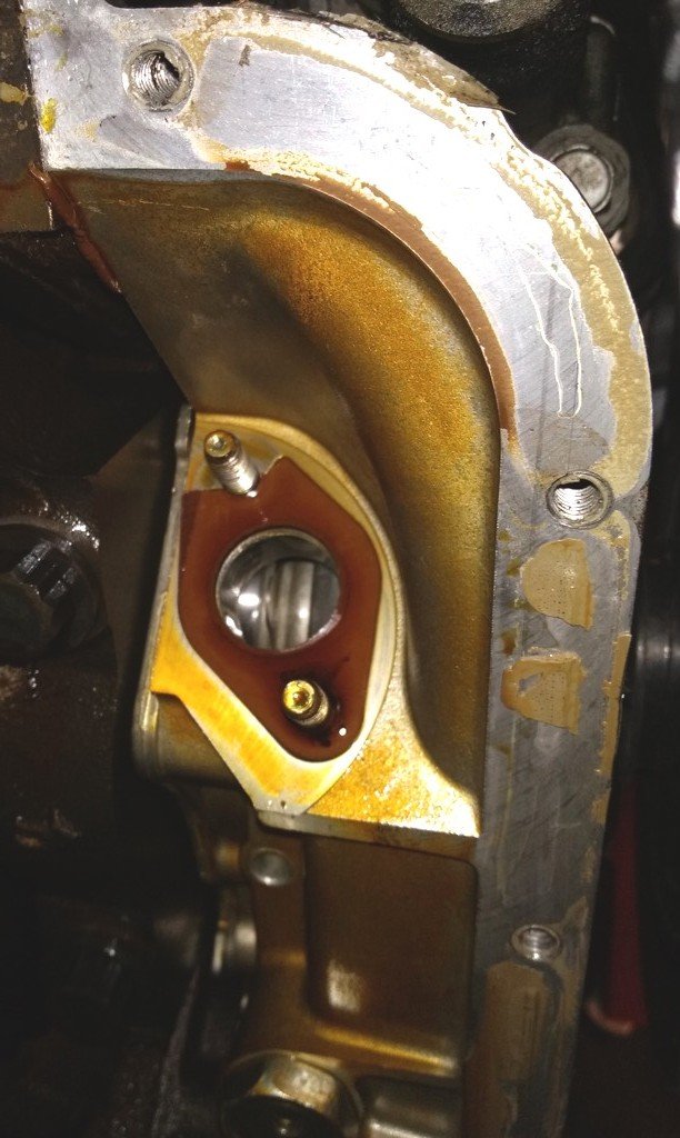

    Replaced the oil pickup tube gasket as part of the lower end reseal on the replacement engine.
