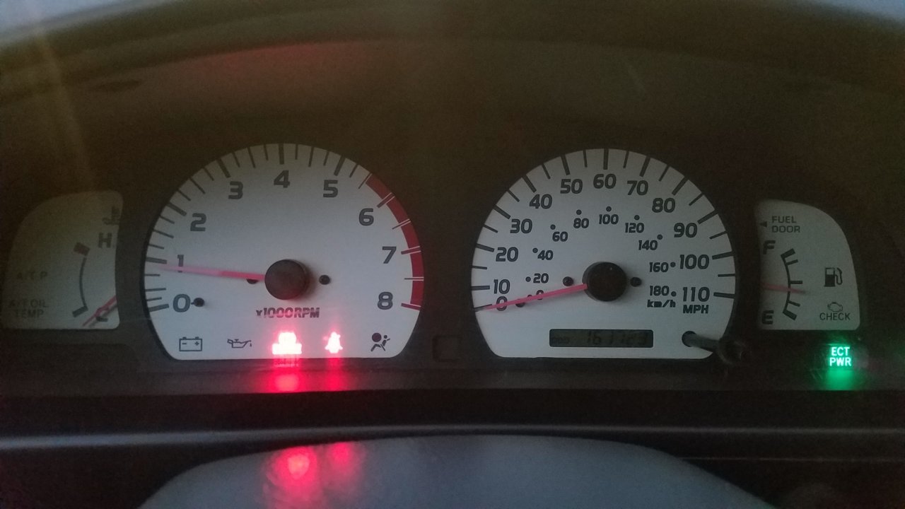

    Everyone is saying I burned the starter, I’m removing it right now.
  3. May 22, 2019 at 7:20 PM
