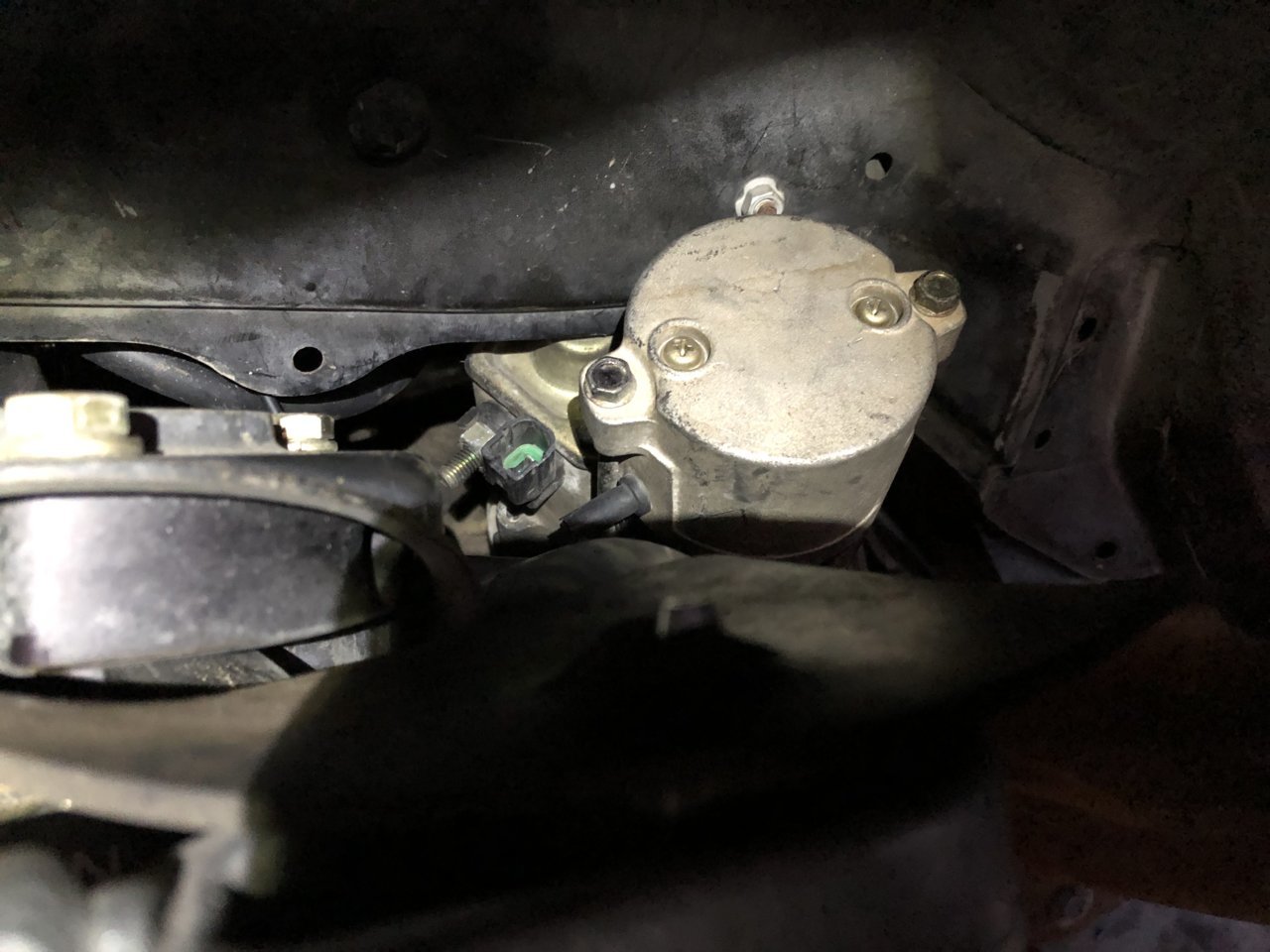

    But to hold test leads on it while its being cranked? Remember he has the SC pulley in the way now too.

    Nobody cranking, key in on position, battery on floor next to tire, remove tire if you need, connect clips to battery terminals, connect clips to starter

    From underneath, not on top

    nope - I 2nd taking readings off the starter while it's cranking

    I’m not putting that old starter back in unless I know for sure it’s good. I’m going to test it against the FSM instructions later.

    Why, is it difficult to get in past the control arms?

    It has to fit through here. It took me longer to remove it than to actually unbolt it and remove the connectors.

    Two different procedures. Either one will tell us if full voltage is getting to starter
    If electrical testing this is too confusing than he should prolly just have it diagnosed

    If crank sensor isn't connected it won't fire. I'm not saying it's causing your slow issue just suggesting that it sounds fast enough to fire to me.
    I pulled my starter out through the wheel well and didn't think it was too bad.
