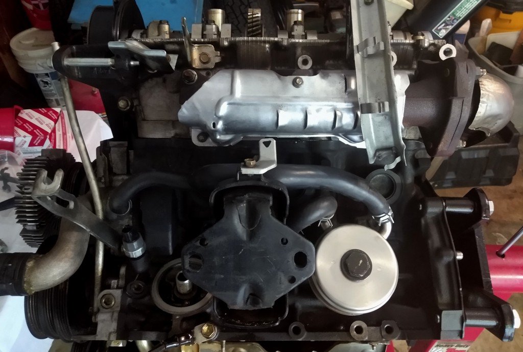

    Good call on the cooler seals, just about every taco has a leaking tuna can by this point in their life haha

    Yep.. That one was just starting to seep at the o-ring. Changing those hoses looks to be a pain too. I repositioned the hose clamp directions for future ease of service from below.

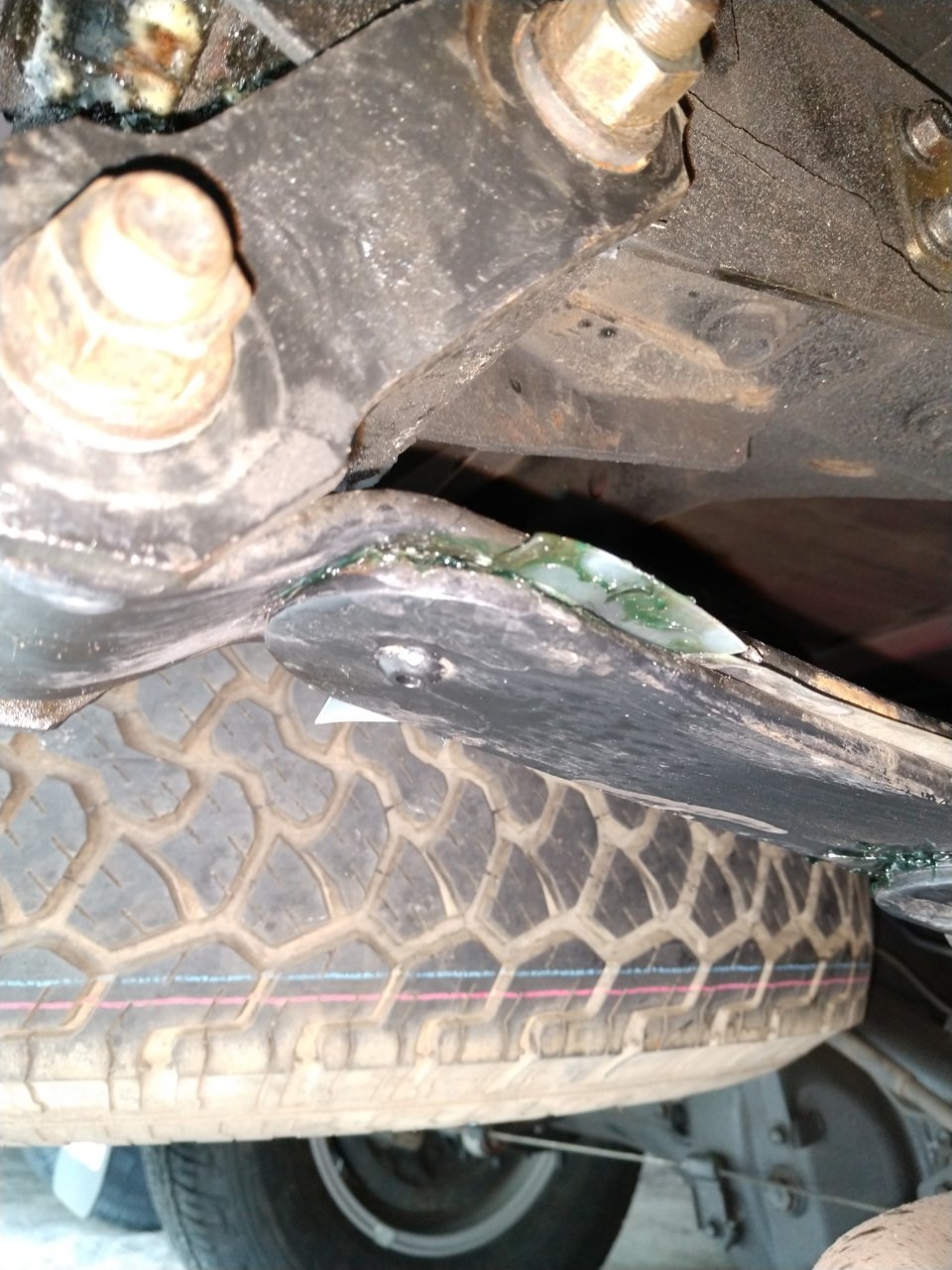

    I decided to try one last thing before I regrease the leaf bushings. And that was to get a little piece of teflon on the pad right next to the bushing. Bounced up and down on it, and its silent. Total, blissful silence. IMG_20190523_154812780.jpg

    That leaf looks too long, either it needs to be a military wrap or it needs to be shorter, it's rubbing right at the bend

    Meh, as long as its quiet, idgaf.

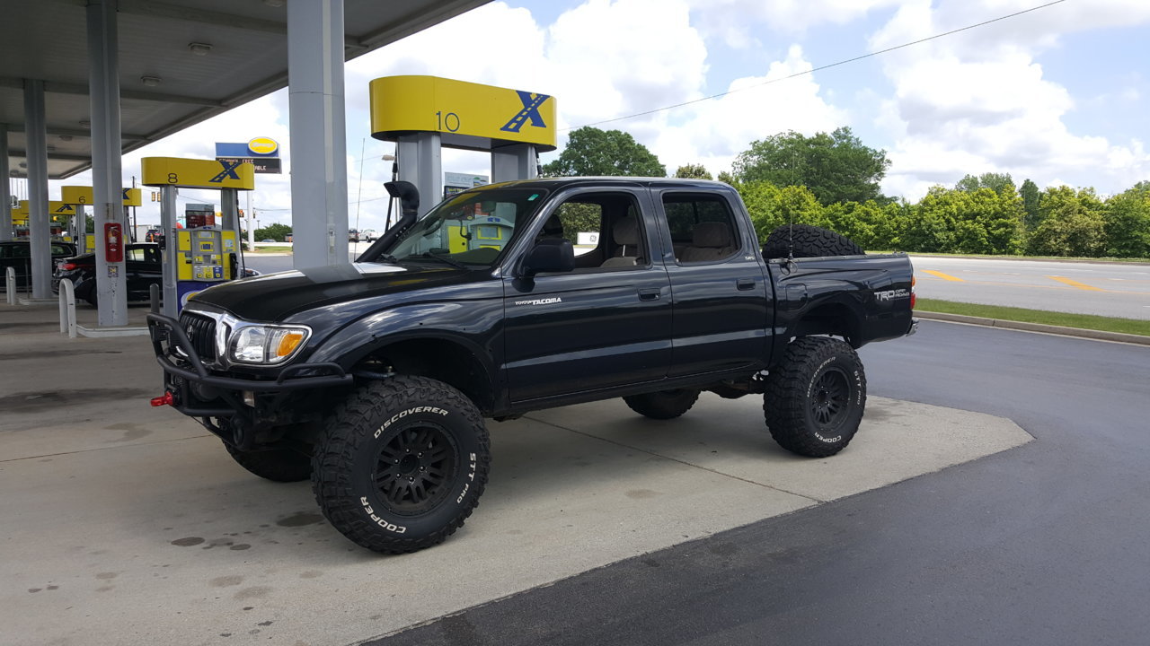

    Removed my hi-lift from the front bumper.
    Removed my load bars and roof basket.
    Removed my softopper.
