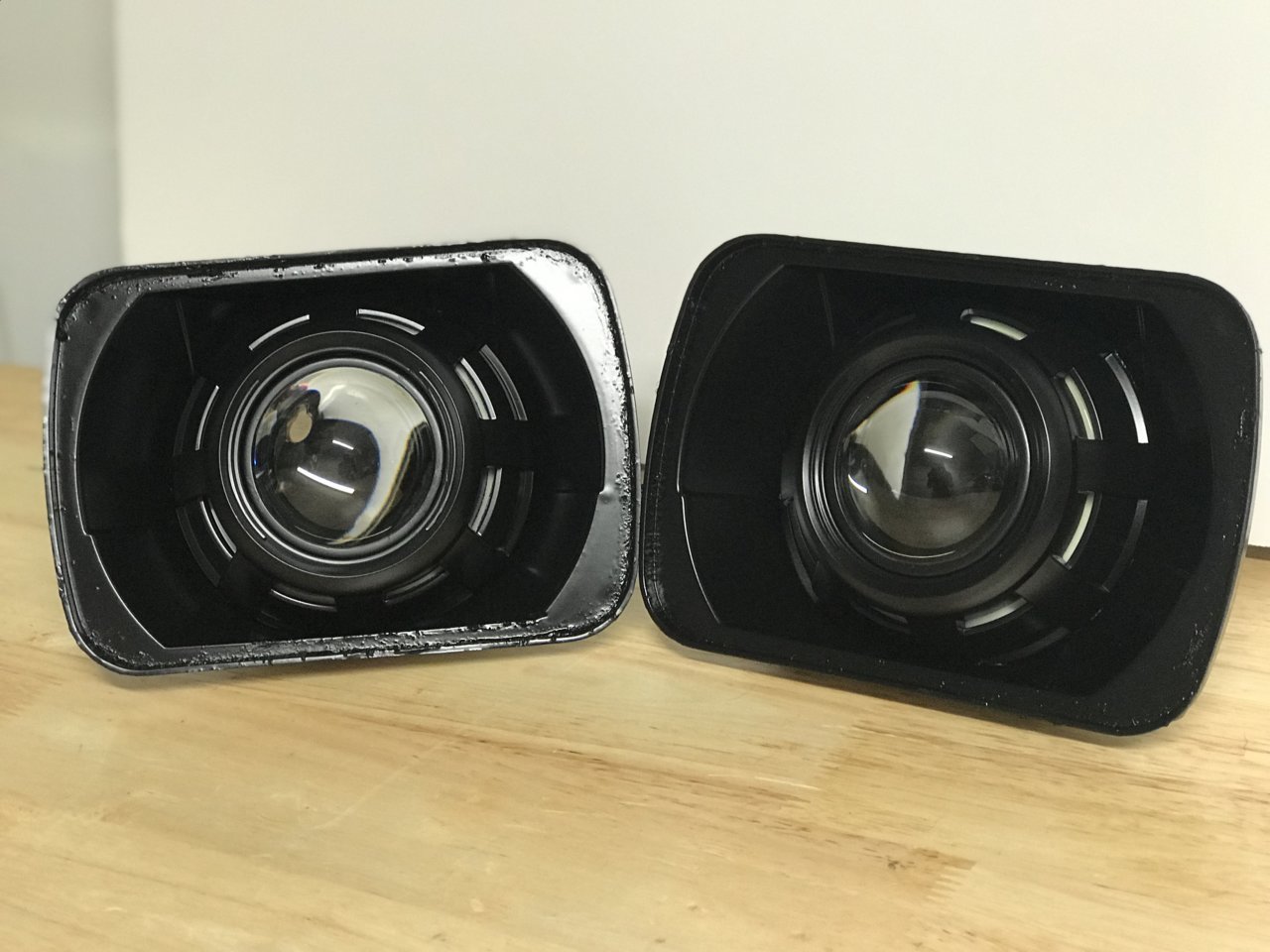

    Oh man, that sucks!

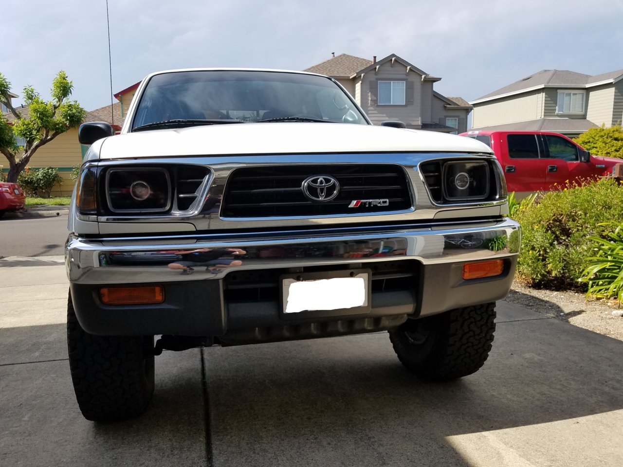

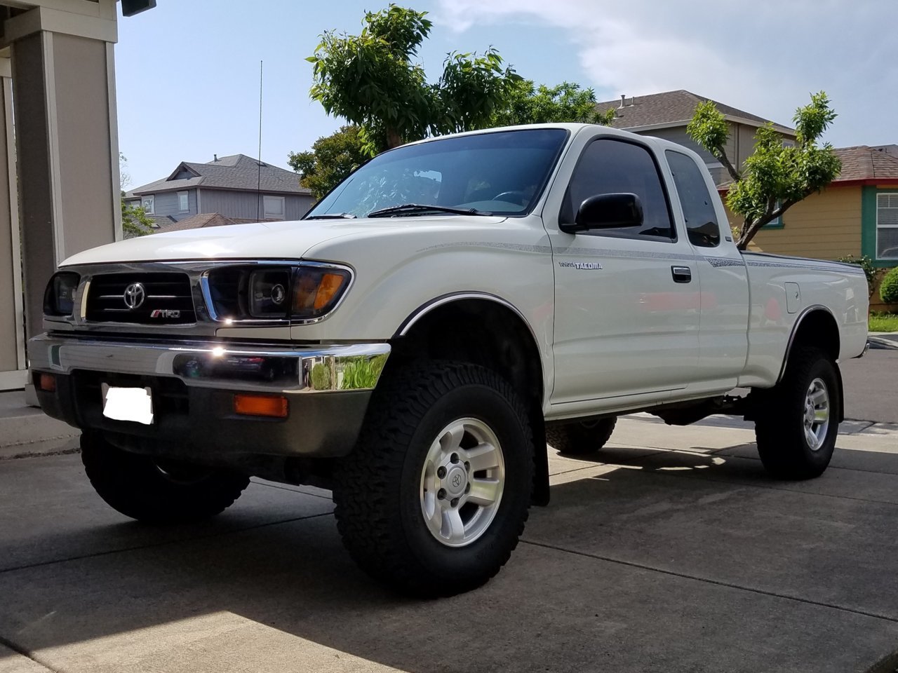

    Did that already, still really dim. I don't think you can flip them, I think there is a notch to where they will fit in one way.

    These are what I have and they are great https://www.amazon.com/gp/product/B074LT5B1M/ref=ppx_yo_dt_b_asin_title_o09_s00?ie=UTF8&psc=1
    Did you upgrade the harness? I know sometimes if you don't it won't be as bright as it should be. https://www.amazon.com/gp/product/B06XHSFLTZ/ref=ppx_yo_dt_b_asin_title_o08_s00?ie=UTF8&psc=1

    Those aren't real projectors. Just a mock lens. Just get some Hella E-codes. It's the best plug and play halogen headlight there is for 200mm headlights like ours. Or get a retro from @LSC15 if you want the real deal.

    Takagi is pretty darn good! (Not affiliated)

    Toyota lights are ground side switched. The lights are expecting two positives and a single ground. But instead you have two grounds and a single positive. That's what that relay harness he linked is for
