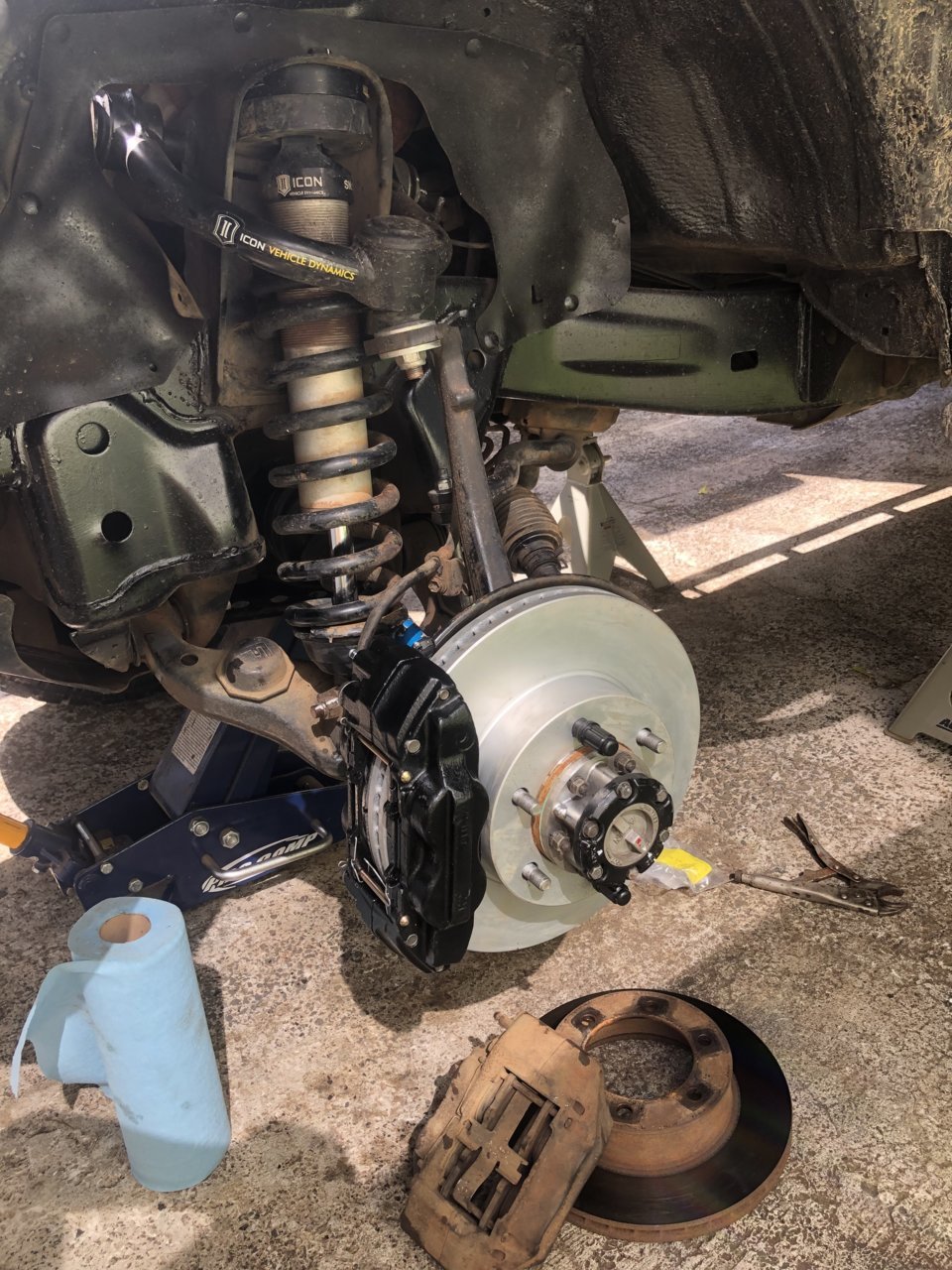

    F5197049-DD72-4EDB-BBFF-D56D6F63B9B2.jpgTundra brakes.
