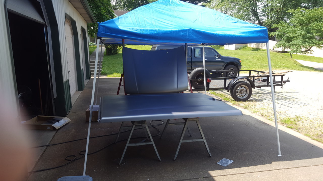

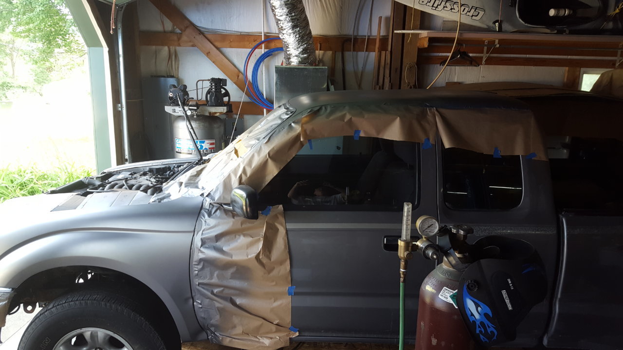

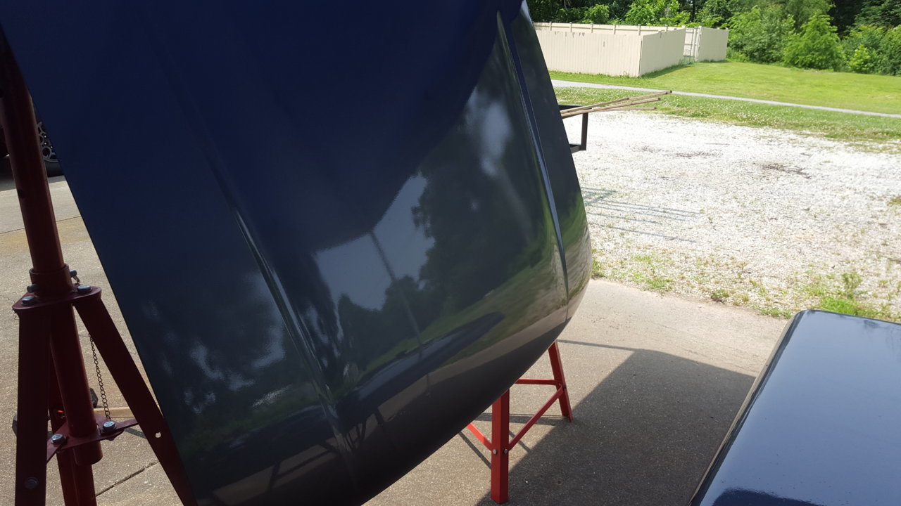

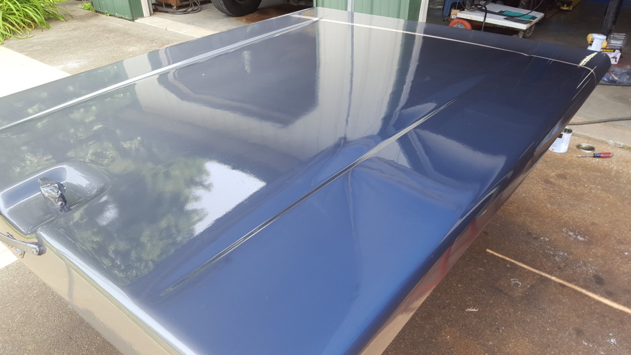

    Paint day for my silver truck, the wreck rehab. I had replaced the hood, LH fender, and the roof and bed cover were faded really bad. Bought Nason paint. Not sure why I even bother to give the paint code, since I knew it would be darker from fade on the rest of the truck... and it is pretty different. No suspense there. Just too lazy to prep the entire truck. Maybe later if the mismatch bugs me bad enough.
    Yeah, outside and I'm gonna have dust in it. But it's a 24 year old truck with 255,000 and been wrecked, twice.
    BTW, usually borrow my nephews high end gun, but this time I used the $9.95 HF HVLP at 35-40 PSI. Water filter at compressor and at the gun. Total supply cost was $230.00 for 2 qts paint, 2 qts clear, and about 20oz of activator. I had some reducer from painting my green truck.
    Base Coat
    Clear Coat x 2
    Base Coat
    Clear Coat x 2

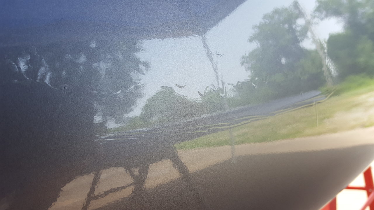

    No homespun paint job is complete without some sort of mishap....
    Darn it! Oh well, I can fix that. I'll do it after I put it back on the truck. Nice, easy to reach location. This is what happens when you crowd your parts together and try to paint. I "stuttered" trying not to bump into my bed cover. Only takes a second with the clear coat and your screwed.

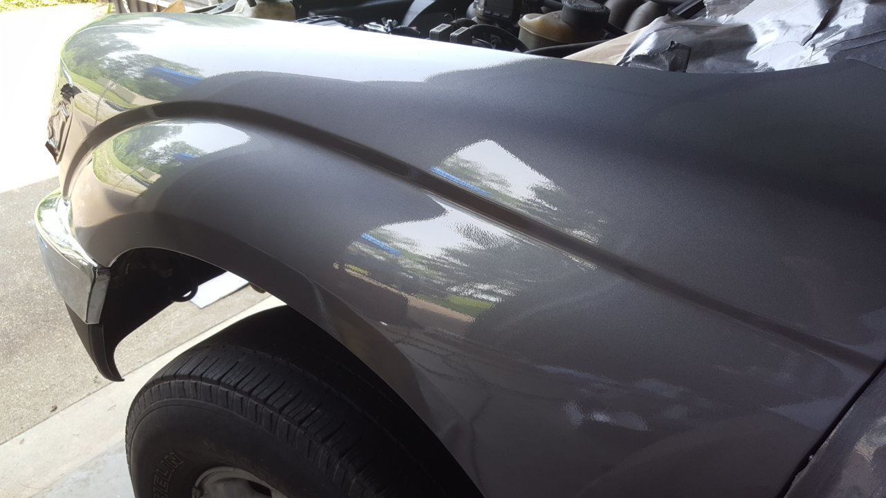

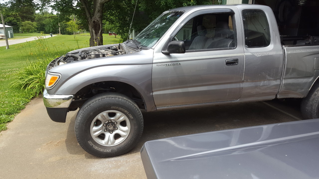

    UPDATE:
    Pulled it out in the sun. No, I can't live with that. Hard to believe how much they fade. That fender was mixed to original 196 code.
    I am going to have to paint the rest of the left side. Then, who knows on right side....
